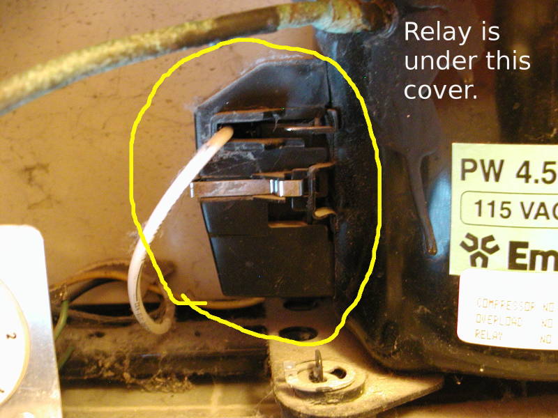

Grab a pic of the connections on the compressor itself. Most often the relay is disguised as a plug that attaches to the terminals of the compressor. If you didn't remove it, it if it exists, is still on the compressor.boyntonstu wrote:http://i348.photobucket.com/albums/q339 ... ressor.jpg

http://www.e-refrigeration.com/index.ph ... compressor
The relay will plug directly onto the three pins shown in the link above.
Various start relays look like these, but are most often black in color.

What's so hard at looking at the side of the compressor under the little cover?boyntonstu wrote:
The capacitor is definitely a run capacitor. Since it was connected with only 2 wires, it seems that the wiring is complete.
BoyntonStu
The difference in a run and start capacitor besides the size is the presence or absence of a relay ON THE SIDE of THE COMPRESSOR that disconnects the capacitor after the compressor starts.
It is true there are two leads that connect to POWER. Between the capacitor and motor is 3 leads.
On the leads shown here;
BLUE is the RUN. It connects to both the RUN on the compressor through the coil on the relay if one is present and POWER on the capacitor.
RED is COMMON. It connect to the common terminal of the compressor.
Yellow is EITHER START or RUN CAP. To tell, you have to take the cover off the compressor and look for a START RELAY.. What is so hard about looking under the cover? I suspect the yellow wire connects to a terminal on a relay under the cover. Until someone looks there is no way to tell what is under the cover.Grab a pic of the connections on the compressor itself. Most often the relay is disguised as a plug that attaches to the terminals of the compressor. If you didn't remove it, it if it exists, is still on the compressor.
The window A/C was one block from the ocean and the bolt/nut are rusted.
You wouldn't believe all the corrosion inside the unit.
I will spray it with WD-40 and I will get it open.
Sorry for being lazy.
I tend to agree with your train of thought.
Looking at the photo:
Red - directly to motor.
Blue - to one side of cap and onto motor.
Yellow - from other side of cap to motor.
The yellow goes to the starter winding and remains connected, or a relay opens.
Are there any other options?
BoyntonStu
I thank you for your patience.
BoyntonStu
BoyntonStu
BoyntonStu
