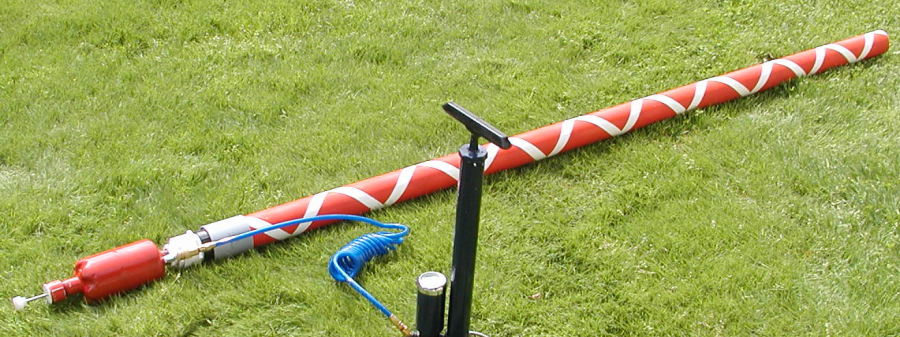

Close up picture of the coupler.  The reducer from 2.5 to 2 inch is cut short and inside, then a ABS female adapter is inside that for a small dead space when used on the big 2 inch valve.  The white PVC is only threaded adapters so it will fit on the small tank.  They are removable.<br /><br />The barrel volume is written on the coupler to make barrel selection and GGDT modeling easy for any barrel tank combination.

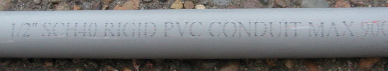

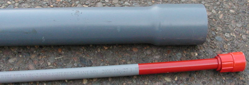

I guess I should have been specific.. The 2.5 inch grey parts were purchased from the electrical section along with a length of Grey Schedule 40 PVC Conduit. It's cooled down.. I grabbed the camera.. The 2.5 inch is painted.. The end I cut off doesn't have markings.. Sorry. Grabbed a shot of the 1/2 inch conduit barrel tool.
Cut off end of the 2.5 inch conduit barrel..  No markings on the short piece.  Sorry.
It's conduit.. Tested under pressure.. 110 PSI.

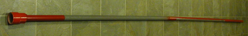

1/2 inch 6.5 foot mini marshmallow barrel.  Works for AA batteries tool
