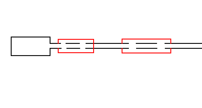

I'm currently looking into how much muzzle velocity I can obtain from a 1x combustion launcher. Fuel will be hydrogen-oxygen or perhaps methane-oxygen. I am considering a new design to keep combustion pressures (and more importantly, temperature) up during the entire transition through the barrel by using staged combustion chambers, inspired by the V-3 cannon.
link
The gun used multiple propelling charges placed along the barrel's length and timed to fire as soon as the projectile passed them by, to provide an additional boost.
My idea is to use multiple smaller combustion chambers which run co-axial to the barrel with multiple high surface area ports. Each of these combustion chambers would be fueled with a stoichometric mixture of oxygen-hydrogen or oxygen-methane. As the projectile passes, the combustion gasses ignite the fresh fuel in each chamber and provides more pressure (throughout the barrel) and higher temperature. Assuming there is no projectile blow-by (and with the ammunition I'm using, there wouldn't be) there would be no issue with timing. Some of the gas from each combustion chamber may be lost but I wouldn't be concerned given the large flammability range of hydrogen.
Any thoughts? Before I'm told this isn't practical, I know. It's research, and an experimental launcher.
Tl;dr: using staged combustion chambers for moar pressure and temperature throughout the length of the barrel.

As a projectile passes through the barrel, the gasses lose temperature (and thus velocity) and pressure (velocity again). The idea is to use co-axial chambers placed throughout the barrel to be ignited by the gasses from the first combustion chamber and keep pressures and temperatures higher.
In 5.5-6.5mm (q-tip).
I can probably achieve similar performance with a low mix hybrid though.
Black chamber is the initial chamber. Red chambers have ports to the barrel and are ignited as the projectile passes.

I don't know if this will be a problem or not, but could the gasses from the coaxial chambers interfere with the motion of the projectile? Perhaps causing it to strike the edge of one of the ports as it travels?
It's been suggested before. I stand by the comments made in the previous thread, but don't let that stop you try and prove me wrong ;)

Like Jack said, doesn't seem likely to work but if you think you can solve the various problems then go for it.
How will you seal the secondary chambers from the barrel to keep the fuel mix from leaking out the barrel? How do they get unsealed when the projectile passes?

Wow seems like a very interesting design... the only 2 complications I can think that will arouse from this are.
1. It's goanna be hard to time how long it takes for the fuel to ignite and also how long the projectile takes to cross the 2nd chamber / or the 3rd. mainly because if the 2nd or 3rd chamber ignite before the projectile has passed it would act as a "stopper" ..
2. It would be hard to figure out how much time apart you should set up your ignition system to.
Not really a problem as the chambers are ignited by the heated gasses behind the projectile. Just that care must be taken that the flame front can't outrun the projectile. (hydrogen flame fronts average around 250 m/s).
Small lightweight "burst film" could be used.
Silencers in spudguns are regularly constructed in a similar manner with little issue.

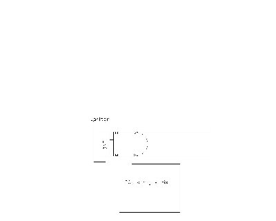

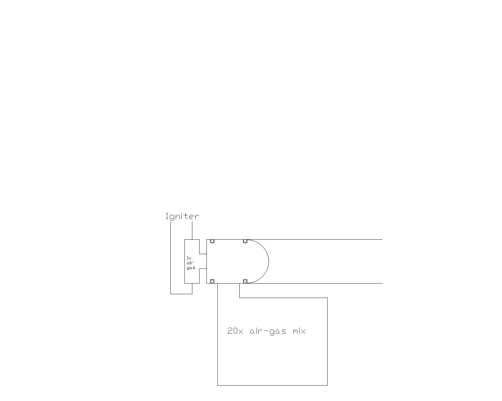

jagerbond
Posts: 286
Location: Hawaii
Thought about building something like this with our original twin O-ring designed UHMW rounds... So the pilot could be a simple spray and pray. worse case scenario the sudden increase in pressure could extinguished the combustion and it would a pneumatic with a combustion operated pilot...
crude, but you get the idea.

jmadden91
Posts: 246
Joined: Thu May 07, 2009 6:03 pm
Location: Queensland, Australia
In a silencer the forces are moving away from the projectile, into the silencer's chamber. Whereas in your design the force is coming in from coaxial chambers which could potentially knock the projectile off center?
**Note I have no experience in the matter and am talking out of my arse here haha
inonickname
Posts: 2606
The idea is that the projectile has already passed before the gas can pass in front/disturb it's motion.
