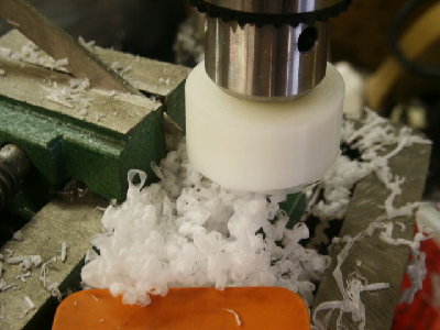

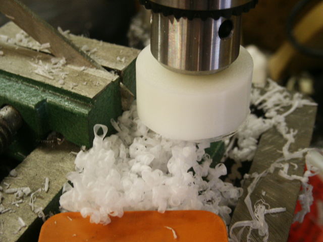

There are lots of option for building piston valves. The larger sizes are more difficult to get to work. Valve seat imperfections, friction, and forces go up quickly. So do leaks, sticking, and breakage. For this reason many golfball cannons are built with smaller valves.
Study the many designs. Pistons are made from tin cans, plywood, hot melt glue, HDPE (my favorite) and other materials. Remember in larger sizes, small gaps are big leaks.
HDPE piston turned on a drill press

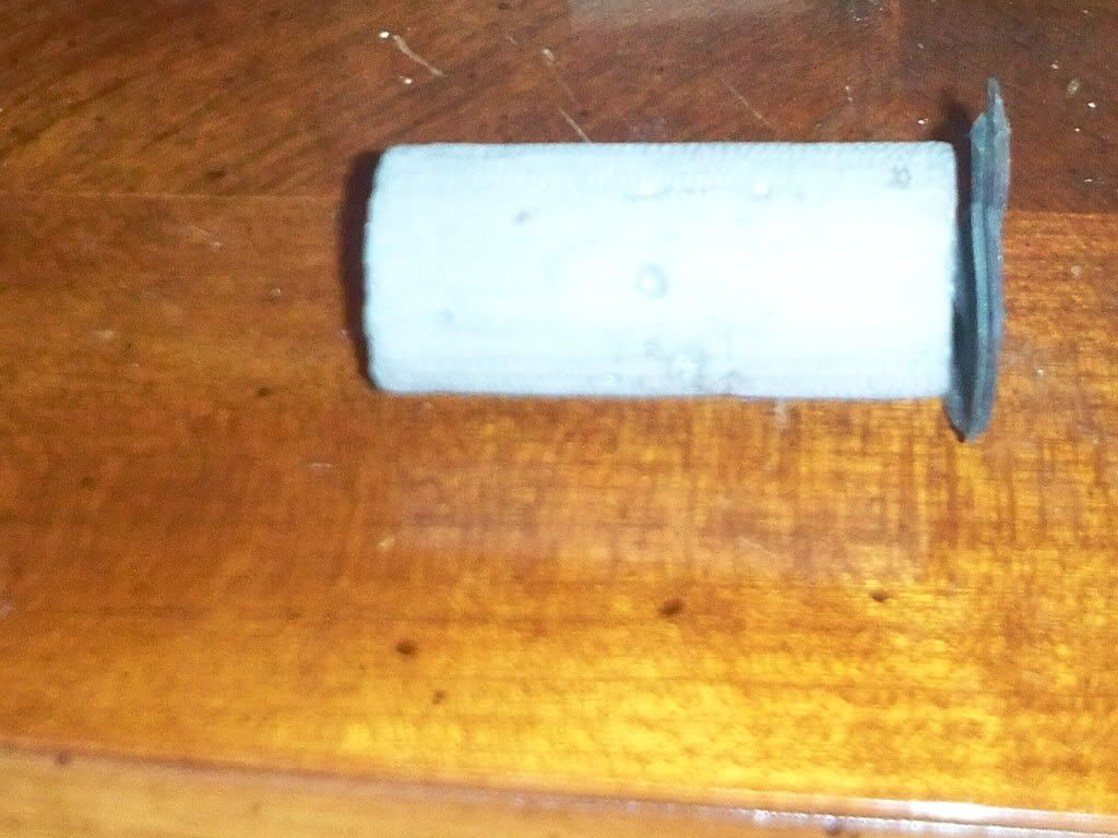

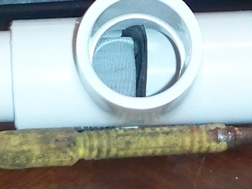

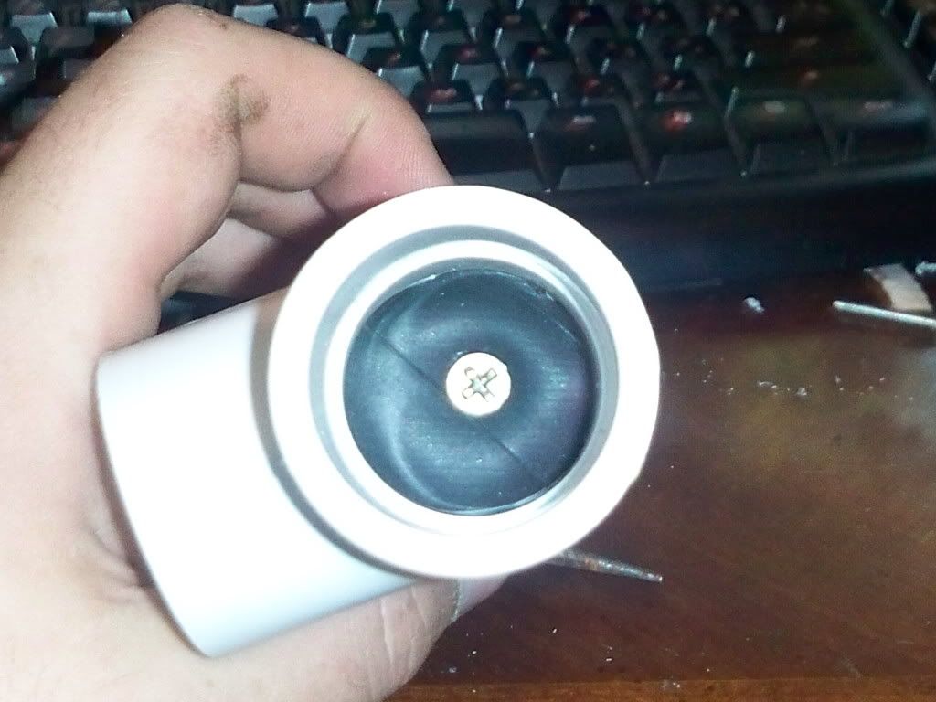

goin for a 1" to start so i can get it down before i build the GB cannon, heres pics
EDIT: not sealing at all i think i need a different sealing face (currently a bike tube)
How well of a fit is your piston in the piston housing? It looks like either your sealing face it too large, or your piston is too small.

it fits snuggly in my 1" pvc, so it sounds like i did it wrong
If the piston fits perfect in your piston housing, that's good. Why don't you trim your sealing face to the same size as your piston?

well theres 2 answers for that question, the first is, i lost it lol, and the second is it would slip into my barrel the piston is the same size as my ID of my 1"pcv, on another note, just got back from the hardware store, and all the peices i needed cost me 80$ us >.<
