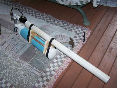

Update!
I used some fittings designed for truck airbrakes for the remote tubing and hand built a wooden spacer for the area between the barrel and the pressure tank.
I also used a screw, some scrap steel, and a big ball-peen hammer to fabricate (read smash) a clamp to hold the trigger assembly in place. I tried to use hose clamps but that looked a bit bad in my opinion.
I have test fired some golf balls and was able to launch them so far that they went out of sight. I don't know the actual range, but since I'm launching them into an area that is cleared through the woods for power lines, I'm not gonna try to retrieve or find them. At the time of testing, I had no pressure gauge on the gun so I couldn't monitor the psi. I have installed one now and will retest (play) some more after the painting phase is complete.

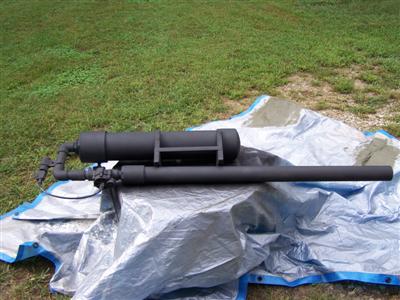

UPDATE
Ready for finish sanding and paint!
UPDATE
First coat of flat black on!

Update!
UPDATE
UPDATE
- ready for paint
- 100_2255.jpg (28.71 KiB) Viewed 6944 times
- first base coat
- 100_2256.jpg (32.46 KiB) Viewed 6943 times

I expect that to honk. I recommend using elbows the size to fit the chamber instead of reducing size and then using small elbows. Please note that the one you patterned it off of has as short of a path as possible from the bulk of the chamber into the valve. The elbows don't allow high speed flow to the sprinkler valve so the drop in pressure on the valve is faster than the pilot vents so it may close early several times making a honking noise and cutting performance.
That will launch golf balls, but using a valve close to the bore size of the barrel makes a world of difference in power.

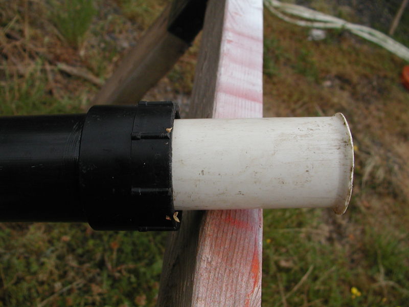

For my golf ball launcher I simply flared the end of an SDR21 tube and slid it inside a 2 inch barrel and screwed it on a 2 inch male pipe fitting. The sleeve insert is removable for launching larger stuff with the same launcher.
I like the idea of the interchangeable sleeve! Seems like it would be faster than unscrewing and re-screwing barrels.
The canon doesn't honk unless I fire it at 30 psi or below. And I don't really ever do that, I just noticed it when I was trying low pressure dry fires to test the integrity of the areas that have to hold static pressure.
I agree that bigger fittings would give it more power, as would a faster or larger valve. But for now it works great and for me, the performance gain of enlarging the fittings wouldn't justify the work involved. It's just a personal preference:)

I'm a bit confused. I was under the impression that the valve should be located as close to the barrel as possible to avoid "dead area" of uncompressed air. Also, I used a 1 inch sprinkler valve just cause that was the largest available readily.
Anyway, I'm happy with it and It doesn't honk
Thanks for the constructive criticism! I wont make the mistake of downsizing fittings again!

It's no faster than unscrewing and screwing the barrels. This sleeve is breech loaded so it doesn't slide out when on the cannon.Jaygnar wrote: ps

Small pipe and dead space is bad there too. It's why I recommended using chamber size elbows to the valve and not barrel size elbows to the barrel. Sorry I didn't clarify this point. I approached it from a causes for the honking. All restrictions all up. Its not as powerful as the greatest restriction, but restricted as much as all restrictions added together.
You'd be right, I'm a bit confused by Tech's statement too as after all the pipe feeding the sprinkler appears to be the same diameter as the valve itself, so it wouldn't "realise" if you fed it from a bigger pipe.Jaygnar wrote:I was under the impression that the valve should be located as close to the barrel as possible to avoid "dead area" of uncompressed air.
Anyway, excellent effort for a first cannon, some folks don't achieve this level of workmanship on their fifth one
My two criticisms would be that your valve is too small for your barrel, while your chamber is at least double what it "needs" to be. Nothing wrong with the latter in terms of performance, but you get extra noise and pumping effort (irrelevant if you have a compressor really) for relatively little return in terms of increased velocity and range.

So ideally I should have put the valve where it is but have used larger elbow sand delivery piping. Right?
About the barrel sleeve, I thought you had it set up to go in from the muzzle and were using the male pipe fitting on the muzzle to lock it in place, which might work but you'd have to flare both ends.
Thanks for the clarification! What with the all the QEVs, QDVs ,Hammers, Pistons, there's a lot of new and exciting stuff here. I'll probably end up remaking this cannon. But not until I get a piston valve built for it. Anyway, I'll try to get a video of the cannon in action soon. It's not as good as it could be, but I still like it and I'm proud to have built it and look forward to learning and improving in understanding and design!
As long as the pipe is the same diameter as the valve outlet you should be fine. And yes, the valve should be as close to the projectile as possible to avoid dead space.Jaygnar wrote:So ideally I should have put the valve where it is but have used larger elbow sand delivery piping.
The valve is a 1 inch valve. It's the largest I could findMy two criticisms would be that your valve is too small for your barrel, while your chamber is at least double what it "needs" to be. Nothing wrong with the latter in terms of performance, but you get extra noise and pumping effort (irrelevant if you have a compressor really) for relatively little return in terms of increased velocity and range.
I originally planned to use 3 inch pipe for the tank and was gonna have it at the same length as the current one, but my friend who works with the stuff and got it at a great price showed up with 4 inch fittings and pipe instead. I couldn't resist! It is rediculous overkill though, then again I could screw on a longer barrel. I used brass nipples to connect the valve to the pipe and barrel for easy maintenance and barrel interchangeability.
With those sort of pipe sizes available, and if you have a suitable range to shoot over, you should consider a large coaxialas your next project, clearly within your skill level and the power will be something else...
