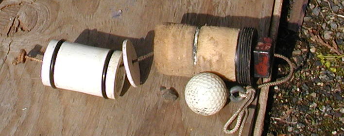

A very small bleed hole at the breech of the barrel will fix the loading problem. Drill a small 1/8th inch hole in the coupling near the sprinkler valve to let out the trapped air when loading. During firing the short duration prevents much air from escaping the small hole. My QDV cannons don't have a shaft seal, so they bleed off through the center of the piston out the trigger rod. I have very little air leak past it as it is under pressure during the shot for less than 20 ms. This ability to load tight sealing projectiles is one of the reasons I like my apple cannon over a traditional piston cannon.
Edit, now that I see your picture a small hole can be located right in the breech threaded fitting through the double wall of the fitting and barrel. It would be directly cross from the pressure gauge. I would not weaken the smaller pipe by drilling it. If you change your mind only the barrel would need repair or replacing.
Apple Cannon valve is a spool valve with a hole through the center.  It permits barrel bleeding of pressure when loading tight fitting apples.<br /><br />Valve is in the ABS test cannon posted elsewhere.
