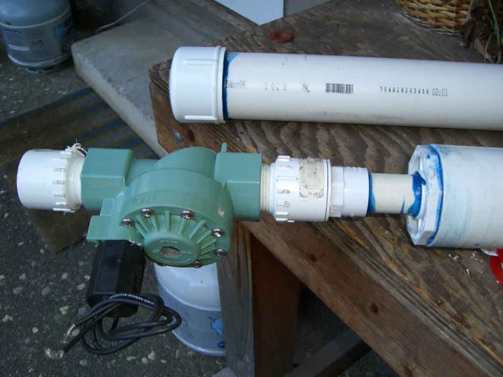

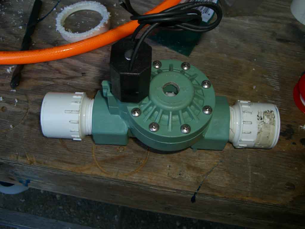

Now screw the valve onto the cannon using even more teflon
Using lots of teflon, thread them into the sprinkler valve

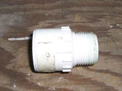

make the adapters by gluing the 3/4&amp;quot;x1&amp;quot; bushings into the 1&amp;quot; male adapters<br />careful not to get glue on the threads<br /><br />Make two of these
make the adapters by gluing the 3/4&quot;x1&quot; bushings into the 1&quot; male adapters
Make two of these

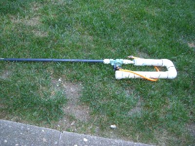

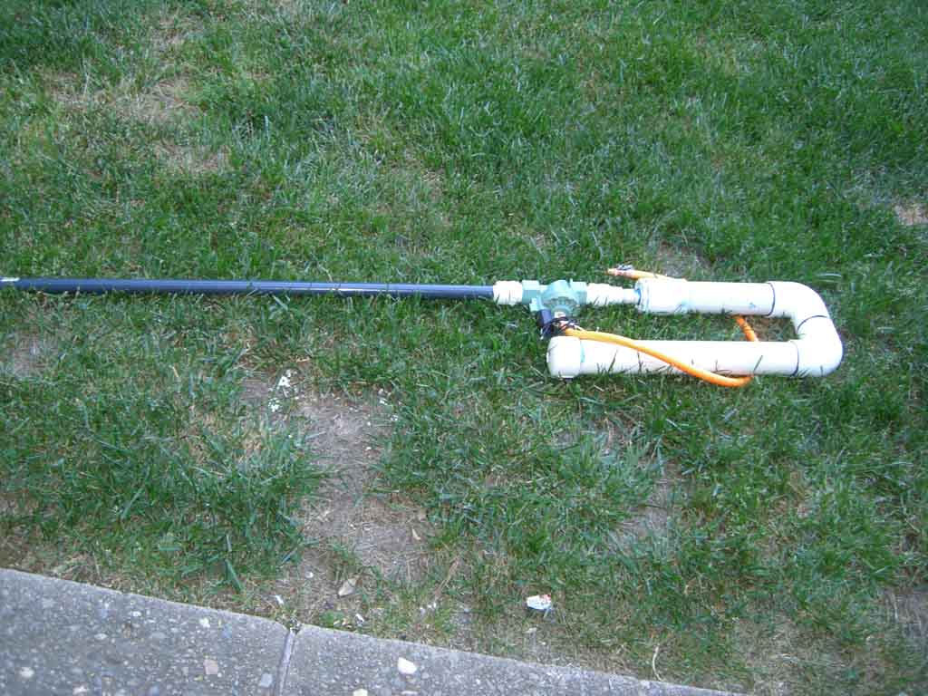

Youre cannon should now look like this.

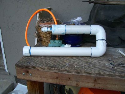

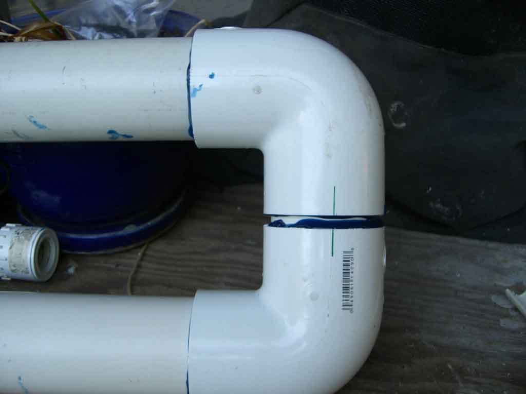

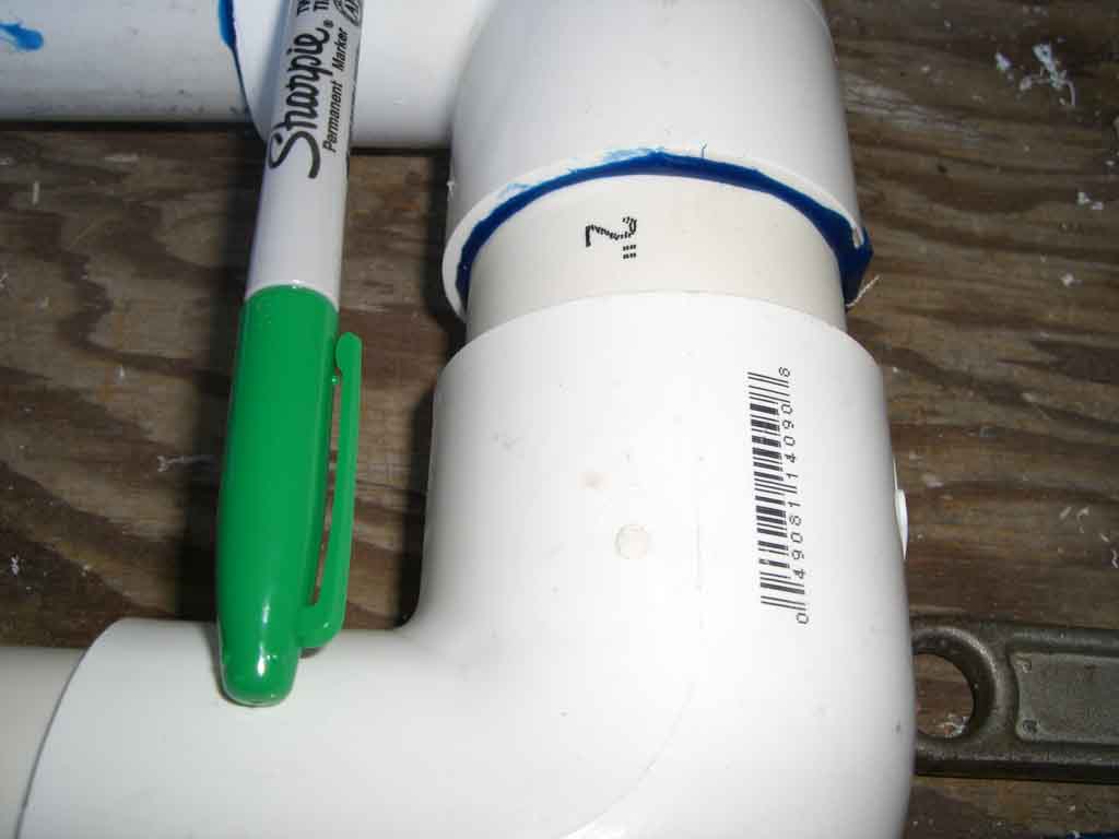

Now apply glue and line up youre marks

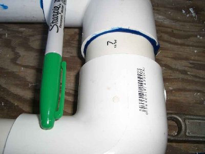

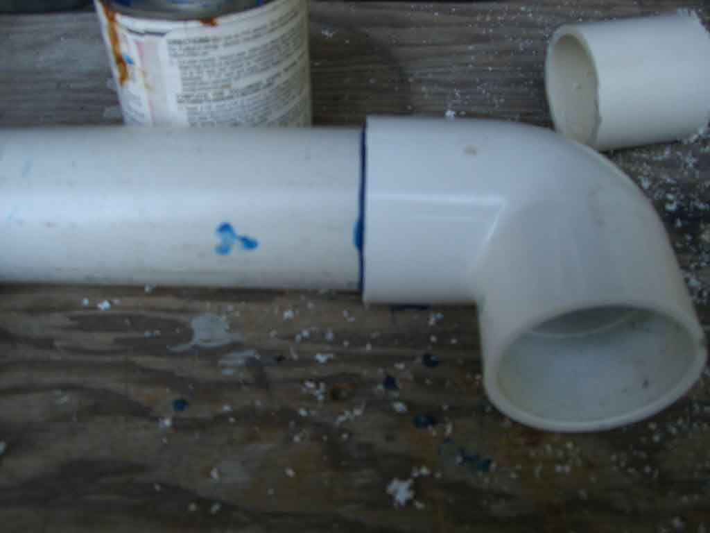

Glue a elbow onto the end of that pipe. with out glue lightly plue lightly push it onto the nipple out of the other elbow and mark the position with a sharpie.

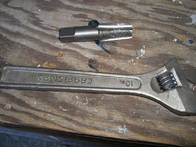

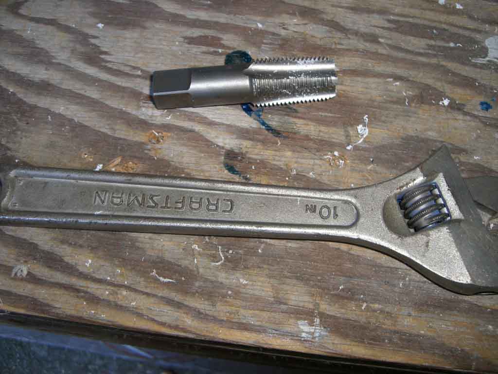

Using youre 1/2 inch tap, tap threads into the hole. go in one turn and out 1.4 turn then repeat

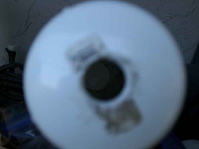

Drill a 5/8 inch hole into the center of the cap

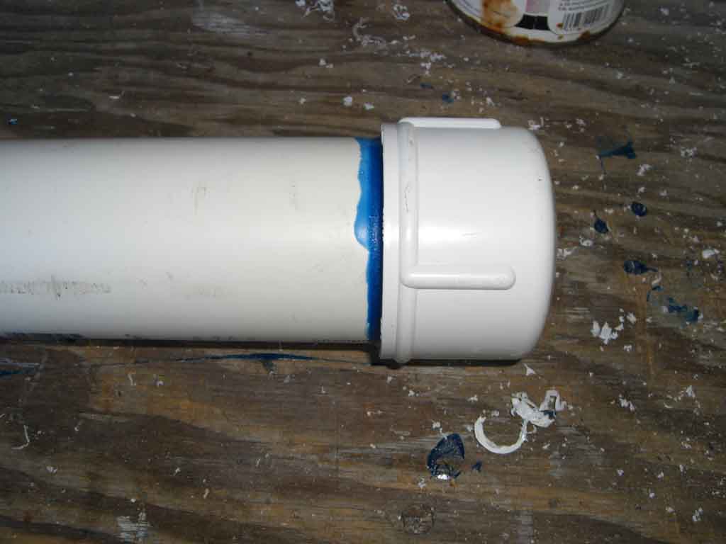

Glue a cap onto the end of the 20&amp;quot; pipe
Glue a cap onto the end of the 20&quot; pipe

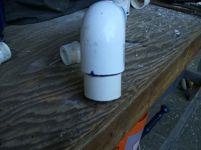

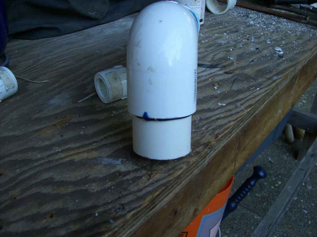

Glue the short piece of 2&amp;quot; into the elbow.
Glue the short piece of 2&quot; into the elbow.
Glue the elbow onto the end of the piece youre working on.

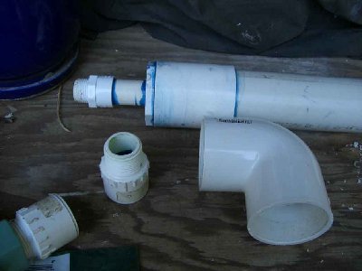

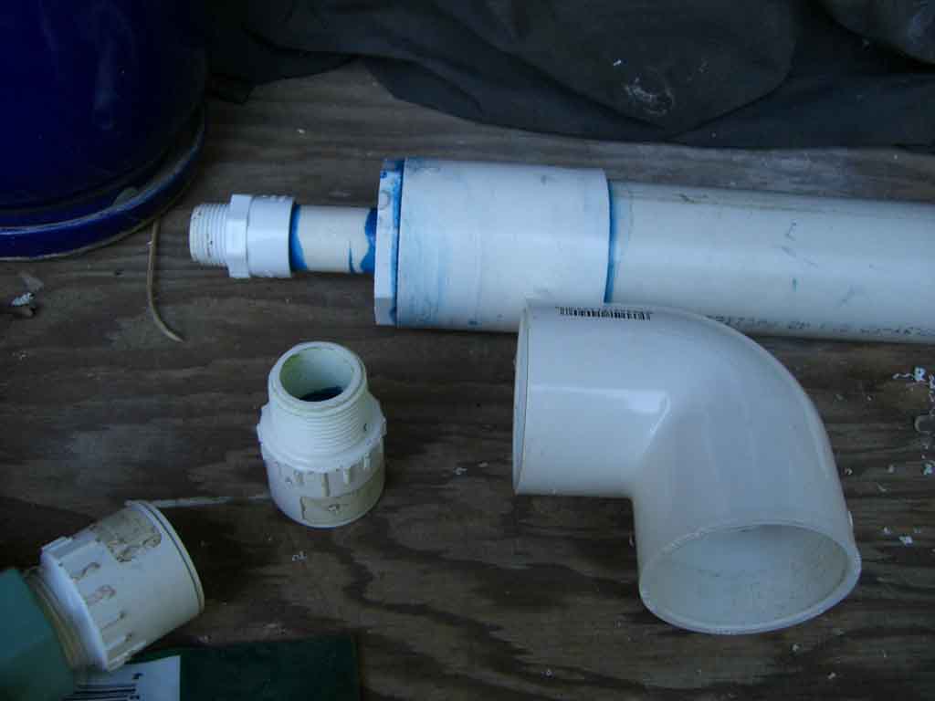

Cut the pipe into pieces 12&amp;quot;, 20&amp;quot;, and 4&amp;quot; long.<br />glue the bushing into the coupling then the coupling onto the end of th 12&amp;quot; pipe.<br />Glue the short piece of 3/4&amp;quot; PVC into the bushing, then the 3/4&amp;quot; male adapter onto it
Cut the pipe into pieces 12&quot;, 20&quot;, and 4&quot; long.
glue the bushing into the coupling then the coupling onto the end of th 12&quot; pipe.
Glue the short piece of 3/4&quot; PVC into the bushing, then the 3/4&quot; male adapter onto it
