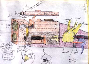

This guy has been featured in a few online articles now. This is a drawing of his mechanism from one of the previous articles.
homemade air rifle .50 1150psi.jpg (20.93 KiB) Viewed 4156 times

Though his final design is substantially different to that, as it ended up being a muzzle-loader. It is, however a hammer valve.
