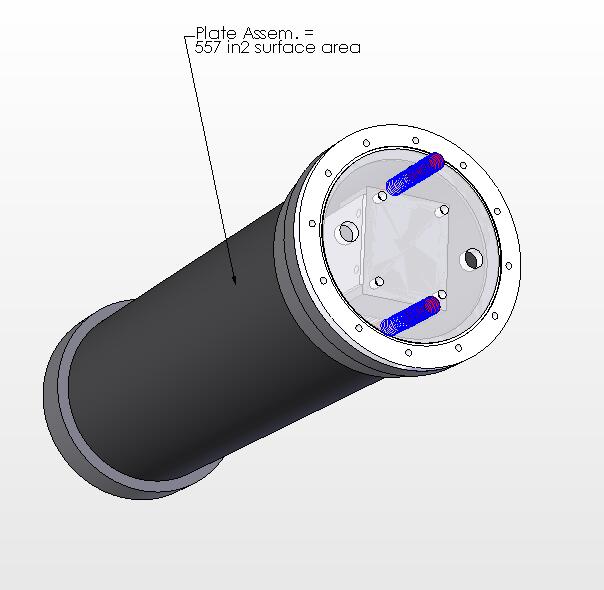

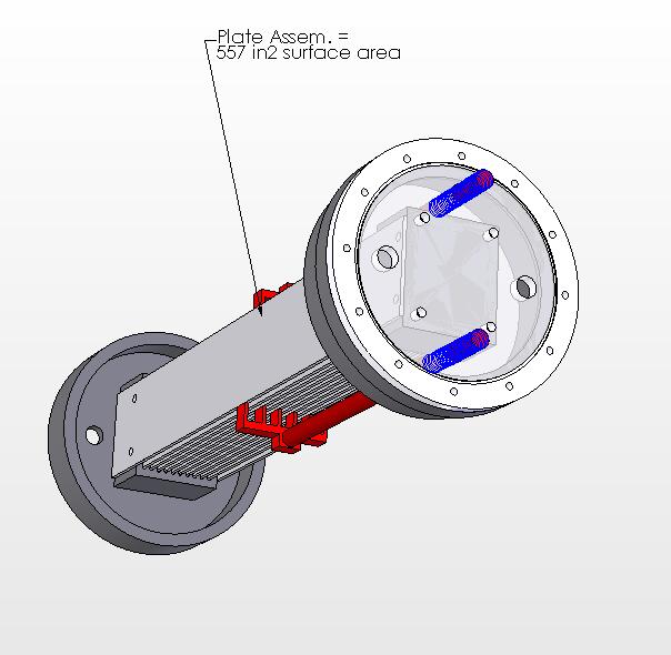

I designed and built this HHO generator a few years ago but, I parked it because I found HHO to be far to dangerous for my liking. At 13a using 6oz limon juice concentrate and 1 gallon of distilled water, it produces 3 liters of HHO per minute with very low heating of the unit.
These are renderings of the unit: (4" ABS case)
The stuff generated with a common gas collector is well known for exploding. There is lots of info online with ways people try to prevent a backfire from going all the way to the cell and making it explode.
The safer alternative is the dual gas collection where O2 and H2 are not allowed to combine in the cell and are then mixed in a traditional fashion at the welding torch.
Look in youtube for videos of the cells exploding. There are several.
I am sure many more exploded without the video running.
