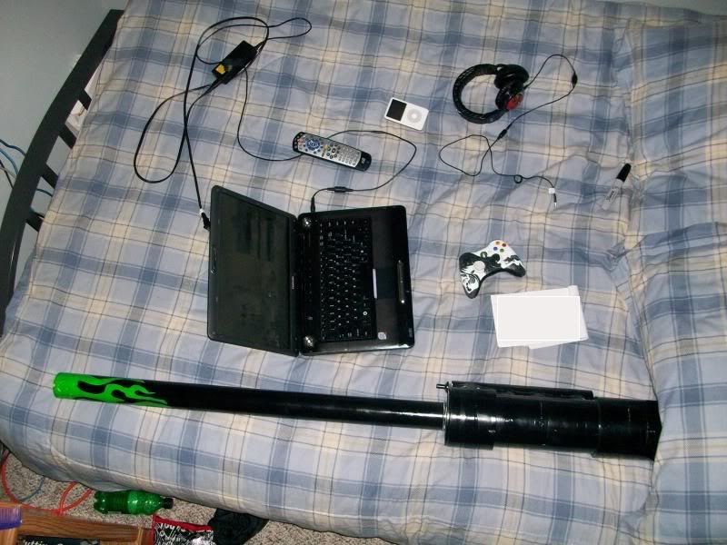

Hello, Im new here to spudfiles and have just recently made my first spud gun shown below. It has a 2 inch barrel.
I have an idea for a sabot round for this. Im thinking about using a 12 inch spike as my round. For those who dont know a 12 inch spike is essentially a foot long nail. I have run into a few problems as far as the sabot itself though. I dont know what material to use as the sabot. I was thinking about using foam and cutting it into a 2 inch by 1 foot round slug and cutting it in half down the middle and placing the spike in the middle. Does anyone else have a suggestion or another idea?
Thanks in advance.
