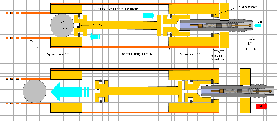

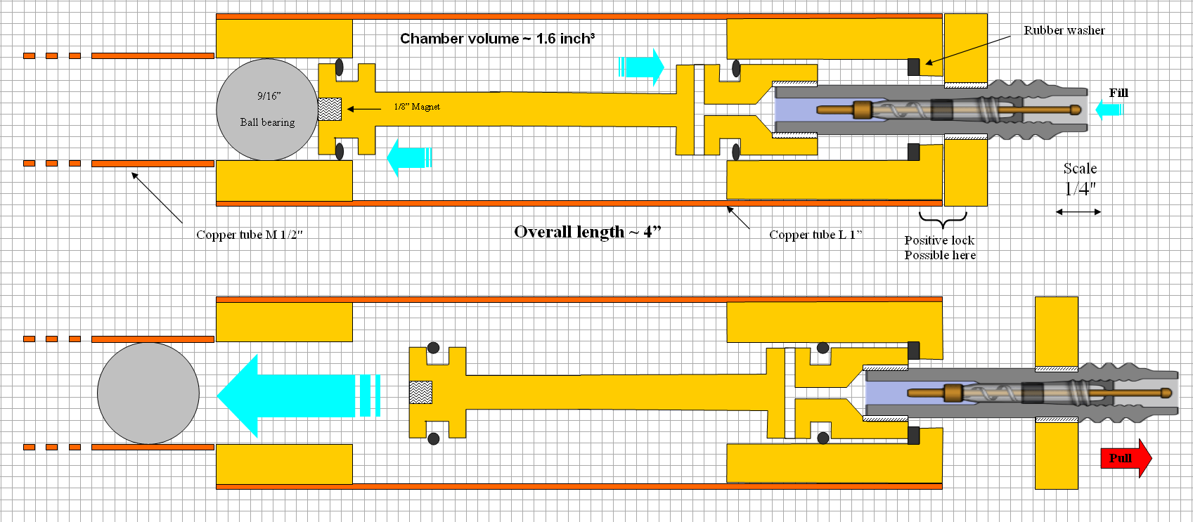

Here’s my most recent concept drawing: a kind of miniature QDV, with integrated Schrader valve inside the piston. I would like very much to have your opinion on it as I really want to build this one in a month or so.
JSR, maybe you already tried that years ago? Now I would not be surprised! ;-) I did some extensive search on the forums, and looked with great interest the experiences using this QDV on large calibers, but couldn’t find something quite like mine.
Any suggestions/ideas about performance or how to improve it?
My goal with this design was:
- Compact, for maximum power in minimum space. This current design roughly to scale is 4” long, dia. 1”. Which is a rather large but manageable ammo.
- No dead volume, because it’s a so small chamber.
- Design usable for breach loading, to be able to load easily darts or other objects or even change the barrel caliber easily with the same chamber.
- Can become a separate cartridge for quick reloading. Can you imagine the large double barrel shotgun out of those baby nukes? I can :-D
- Safe (call me chicken) for storage or handling while loaded
- Air flow not restricted (as much as possible) by some internal part.
- No complicated parts, just 2 floating O-rings and a tapped hole for a Schrader valve to build the piston.
About safety, here’s what I had in mind:
- A leak on the Schrader would not fire the projectile as in a pilot valve.
- A leak on the O-rings would keep the same pressure balanced both sides until there’s no pressure left, so no accidental discharge either.
- A positive secured lock is easy to achieve under pressure at the back of the ammo because the forces involved are balanced inside the chamber.

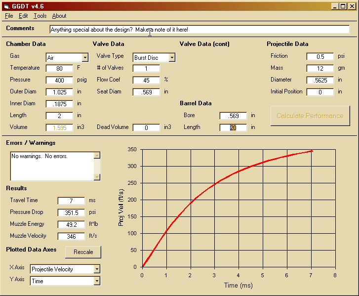

GGDT gives me some interesting figures using this 9/16” ammo: @ 400psi, almost 50 ft*lb for a 20” long barrel. I like it. But maybe GGDT is a bit optimistic… is it?
I choose a burst disk as I don’t know of to define a QDV with it. I bet a QDV is really fast as my understanding is that the pressure will push open the piston as soon as it start opening; hence the rubber washer to cushion the shock on the piston.
Another idea: What I really have in mind, is not to let the Schrader go to the right as in the diagram when fired, but fix the schrader to the gun body and let the whole ammo go to the left, and in the same time engage in the barrel to avoid pressure leakage during firing. But that’s another story and I’ll develop it if you have questions.

QVD ammo. Sketch to scale. 4" length, 1" diameter, 9/16" ball bearing.

GGDT gives me for the same barrel/chamber using a 6mm steel BB "only" 12.4 ft/lb, but a 642 ft/s which is illegal here.
To stay legal and below 500 ft/s I would have to reduce the pressure to 200psi, which would provide a ridiculous 7.3 ft*lb. The same of a very ordinary BB rifle in fact.

Nice design :) though to be honest I don't see the advantage over a similar exhaust design with a spool piston.

I'm afraid that a leak in the schrader would result in an accidental firing. And you have no way to positively "lock" the mechanism to prevent it. At least I couldn't imagine one without complicated contraptions :-D Mainly for me the reason to search a way to miniaturize a QDV which I feel very safe. Just a feeling though...
Of course if you fill the cartridge and fire immediately, it's not a problem.
But if you have a few ammo loaded and stored (or say, hanging in your belt or across your chest ;-) ) you surely don't want that to happen.
If I'm not mistaken, another little detail is there's a (small) dead volume with this design. And of course I suppose the full opening should take a bit longer with a pilot volume than a QDV.
So, I tried to improve all those little things. It surely is more complicated to build, but not that much I hope.
I think if a schrader had to leak, it would do so at a tiny rate, not enough to fire the cartridge. still, nothing wrong with being careful ;)
How about this design, if you want to do some machining...
Similar to the ideas you had expressed here ;)

Good to know a schrader is not supposed to fail (or will do slowly) :-) Still, there's this positive locking I wish to have on preloaded cartridges. Any idea how to implement that with a spool valve (or similar design with a pilot volume)?

I like it...
but do you know that you can design a partially balanced spool valve that would also load ammo ?

the idea is fairly simple... you just have to build a valve that works more less like the semi auto MKIII but instead of using an external air cylinder you design the valve so one part of it acts just like an air cylinder
well basically that's something like valves used on some paintball guns....
This thing works almost exactly like the MKIII but of course it uses a spool vlave instead of the QEV. But there is an individual part on it that works as an air cylinder and looks like it
but there are a lot of valves that are even simpler than that... I guess that this one is fairly simple
this is also fairly simple and should offer good flow
