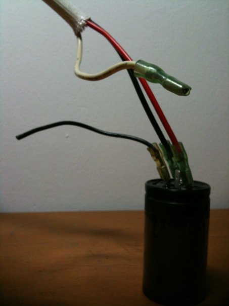

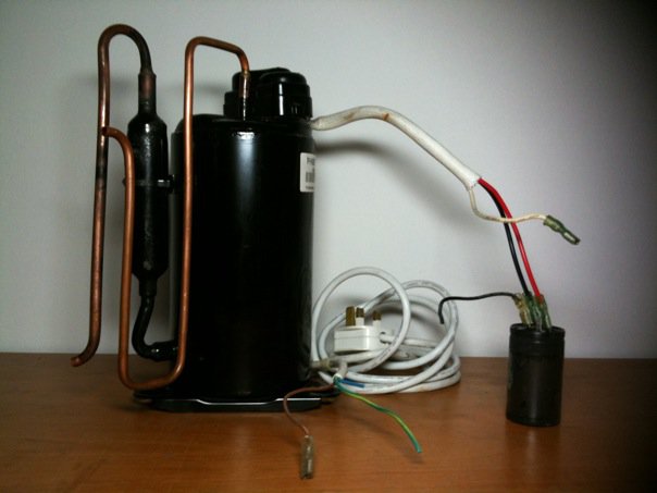

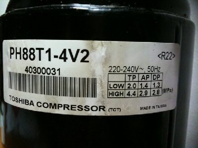

I took the compressor from my old air con but I have a few questions about the compressor; I have uploaded a few photos so that you may get a clearer view.

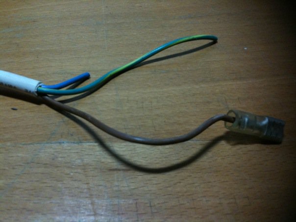

The compressor is connected to a capacitor that has a few wires sticking out - red, black, black, and white. My question is, which wires go to which wires from the plug? The plug has an earth wire, a blue wire, and a brown wire. Also, where should I connect the earth wire?

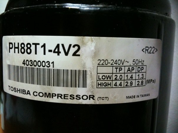

My last question is, simply, how many psi can I get the compressor to load? Or does it depend on the volume of my chamber?

As for the pressure, that small chart with "LOW" and "HIGH" seems to tell you though i'm unsure what that means and what the "TP", "AP" and "DP" means. But i'm assuming the best case scenario is 4.4Mpa, which is 44 Bar (about 650PSI).

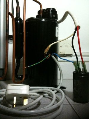

There are no writings on the probes but I called my local technician and he taught me how to wire. The compressor now works like a charm. I'm surprised by how quiet it is!

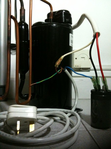

Of course.
The neutral wire (blue) from the plug goes to the capacitor's black wire. The white wire from the compressor goes to the plug's live wire (brown). The earth wire is connected to the copper pipe. Here's a photo.
