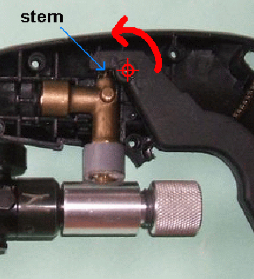

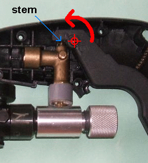

With this project it was quite happy to hold back the 450-500 psi my paintball tank was putting out, but higher than that it started to leak. To actually cause the body to rupture would probably take much more pressure than we can generate, assuming there weren't any internal flaws in the metal.metalmeltr wrote:Has anyone evertested a blowgun to maximum fail presure.
Still, if you're planning to go much higher than 300-400 psi, a pressure washer handle is a better idea
