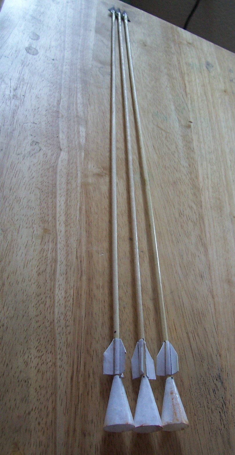

I've done some experiments that prove my theory that the longer the tail (behind the nail) the more stability you get out of the cone shape nail dart. For the test I used a 16mm bore with much larger and longer tail. Its center of gravity is more towards the tip then the dart for the 12.70mm bore and that makes it fly much more accurately.

The smaller dart flies pretty good but it aint gonna do it at 100 meters. On the other hand the bigger dart flies excellent but I'm worried about drag messing with power at such long distances.

Might I suggest something like this?
You could easily make a reasonable quantity fairly quickly with a jig and some superglue, and you have the advantage that it will always be centred in the barrel. Also, bigger barrel diameter means more force accelerating the dart but once it leaves the barrel, drag tapers off dramatically as opposed to the full barrel area of the cone tail.
Another option (though perhaps not so easy outside the US) is to buy some proper flechettes ;)

I've seen this before and I really dislike the design, it just doesnt make sense to me. I can tell you right now its very unstable. The whole concept of darts is to have a light tail extend back away from the heavy tip. Like this you have a light tip and a heavy tail. Chances are, the dart will flip in mid air and fly with its fins forward and the tip in the back.
I would change the design to make it something like this...
Image[/u]
The fins would be connected with a thin strip to the nail so most of the nail is as far forward as possible. While thinking about this I realized a pretty big technical problem. How would you connect the wood to the nail?
I wouldnt have a hot glue gun or even electricity out in the field, super glue is just too damn expensive in such quantities, cord would be too weak and probably slip off and making slits in the nail for the cord is just impossible without a lathe. Not to mention the hassle of putting in the dart and then the foam disc. With all those things, the small connecting pieces of ply could just snap like dry twigs under the pressure.

I'll admit it's not the most aerodynamic of designs but it was just an example.
FighterAce wrote:The whole concept of darts is to have a light tail extend back away from the heavy tip
It's actually slightly more complicated than that, it's to do with balancing your centre of gravity with centre of pressure.
Have a careful read through this, the diagrams explain the dynamics of the parameters involved very clearly.

At the end of the day your cone dart has an extremely poor ballistic co-efficient, it has a "massive" frontal area - the full diameter of the barrel - but very low weight, meaning it might be impressive out of the muzzle but slows down very quickly.
If you want a good full-bore projectile, it will have to be heavier. Maybe find some pipe that fits exactly into your barrel and fill the nose with lead, something along these lines...
