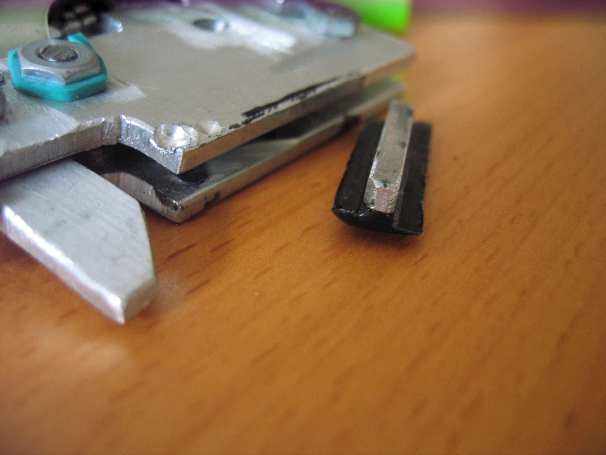

Epoxy just failed on me.
I explain : in the trigger mech, the 'bolt catch arm support' , wich was held by epoxy, just falled when i was holding the gun ... It is put under approx 10 lbs of stress and it popped off. (the said part is held in sandwich between to sheets of aluminium and is itself made of aluminium)
My question is :
Is metal epoxy made to bind two metals and if yes, why did it failed (Was there grease to be cleaned out or something) ? Or else, should i try Krazyglue to repair it ?

Bonding aluminum might present some problems.
Almost immediately after you rough up the surface, a layer of aluminum oxide begins to form....not sure if epoxy bonds to aluminum oxide or not.
Aluminum has a rather high coefficient of expansion...which could cause the epoxy bond to fail. This would require large changes in temperature though.
Proper mixing of the two parts to achieve rated strength.
Proper curing. (Eh what Jack? :wink: ) Likely not the case here given the amount of time it's been together.

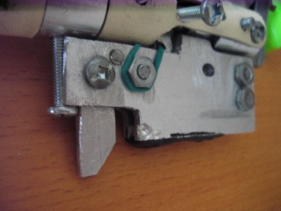

Going on how your discription sounds to me, I would screw the two parts together to sandwitch the bolt handle in there. Pictures of the pieces apart, then together would help.

Here are the two pics, before and after failure
Would crazy glue with a proper solvant cleaning do the job?

The only thing I can think of is to weld that together, it is possible that if you scrub the aluminium very well, then epoxy it again that it will hold. As mentioned before, epoxy is not a one-type-glues-all.

You have to etch aluminum with a two part system to make it work.
No other treatment will work in a lasting manner.
The closest you can get is aggressively scoring and drilling small recesses in the parts you want to glue, applying a layer of Epoxy and then 'wet sanding' the epoxy into the roughened surfaces.
An Epoxy specifically designed for aluminum is always a wise idea.
Guys who routinely glue Aluminum with Epoxy will tell you that even good surface preparation that is not an etch system will always eventually fail.
Honestly, Aluminum etch is really not something you want to be around too much.
It looks like you could adapt the piece a bit and screw or bolt it in position instead.

Crazy Glue (Cyanoacrylate adhesive) is just a thin layer of acrylic AKA plastic. It can not withstand most any kind of torque, and its main redeeming characteristic is that it can hold 2 pieces together. To do this effectively it needs to 'grab' the material by soaking into it. It will not soak into aluminum, rather it will likely just form a thin layer of hard plastic on top, but you're welcome to give it a try.

I maybe found something ...
I could try to make grooves on the 4 aluminium surfaces wich are in contact and fill those grooves with epoxy.
