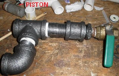

i really need some input on the pressure this thing can hold. i don't want it blowing up in my face. that just might hurt...
1inch HPA Piston valve.
I made this earlier today. It is made of black iron pipe. I believe the pipe is rated to 1000psi (correct me if i'm mistaken). I'm wondering if you guys thing it will work and hold up to the pressure. In the image i attached the piston is in the top-left hand corner. It is made of hot glue and some sheet rubber. Do you think the piston will handle the pressure well? I plan on running this at 600-800psi. It will have a 2"x12" chamber and a .5" barrel for marbles or darts. I've been looking around at the pressure its rated to and in dissapointment i'm finding that my pipe is only rated to 150psi...

I've seen guns with black iron fittings go up to those pressures, but I'm not 100% certain. Wait until a person with experience with that material to reply.

I think it'll be fine but I don't use iron that much... If you search on teh intrawebz there are some charts of pressure ratings for different pipes...

i used hot glue piston for my 3/8 inch piston valve never took it above 120 well around that even with a good back stop the piston started to deform so i dont trust hot glue at 800 at all

They take 1000PSI spike from a 10x hybrid (mine included). Would I use it at 800PSI? Probably. Piston wont stand it though. Probably need to make it from some machined metal with a helluva bumper.
I bought it at lowes and i sure as hell hope its rated past 150 psi. thats nothing!c11man wrote:did you buy thpse fittings at a local hardware store? if so then they are rated to 150. would i take it to 600, yes
EDIT BY MRCROWLEY: DON'T DOUBLE POST
Thanks for the input. Would you guys think a piston made out of sch40 pvc would work? (damn that was fast, sorry for double post) i cant machine anything, but i can buy a rod the right diameter and tap a hole in it for a sealing face.

well I suppose sch40 could, but when you are talking about pressures that high, you will probably feel safer with
a) a solid piston (not hollow through the middle) UHMWP rod would work. this is the stuff that the special large bore rounds from ultimate spudguns is made of. Super strong stuff.
b) something metal. You could try a washer and bolt piston, or metal pipe/tubing and epoxy i suppose.

this is fact. mine deforms at only 110 psi (ends up sideways in the chamber) i think maybe different types of hot glue have very different propertiescannon monkey wrote:i used hot glue piston for my 3/8 inch piston valve never took it above 120 well around that even with a good back stop the piston started to deform so i dont trust hot glue at 800 at all
how will you make a piston out of that? i rly want to know because i need a new piston for my rifle.well I suppose sch40 could, but when you are talking about pressures that high, you will probably feel safer with
so this means the pipe will be safe at 600psi? just gotta make sure...c11man wrote:they are RATED at 150psi. what they can handle is a hole different story. infact my uncle is currently using some in a hydrolic system

Yup.Marffy wrote:so this means the pipe will be safe at 600psi? just gotta make sure...c11man wrote:they are RATED at 150psi. what they can handle is a hole different story. infact my uncle is currently using some in a hydrolic system
MrCrowley wrote:Yup.Marffy wrote:so this means the pipe will be safe at 600psi? just gotta make sure...c11man wrote:they are RATED at 150psi. what they can handle is a hole different story. infact my uncle is currently using some in a hydrolic system
Thanks, now i know i didn't waste my money on pipe that cant even hold up to the pressure i want and it wont blow up in my face.
