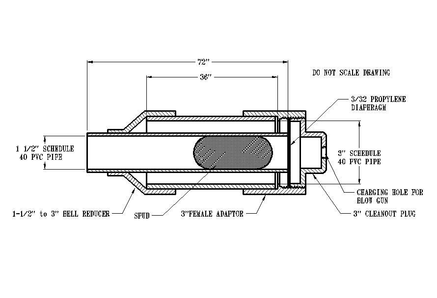

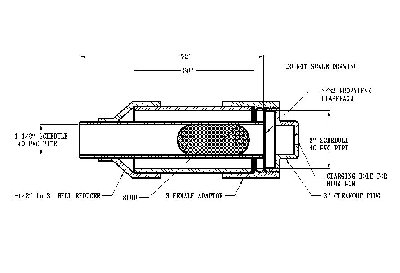

If I remember well a typical 3/4" sprinkler valve has a diaphragm less than 2mm thick.
Thanks for the diagram, though I already found a diagram on the spudfiles wiki.

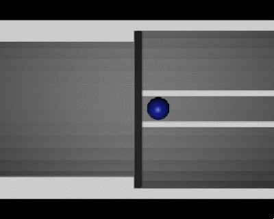

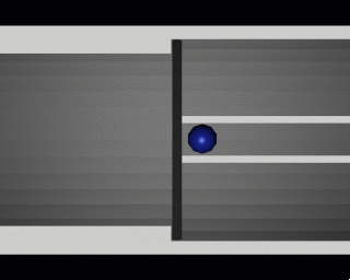

The first diagram (animated one) will not work that way.
When you pilot it the sealing face will flap into the back.
