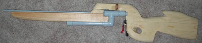

I started out to make a 6mm launcher last summer and it fell to the wayside shortly after it's beginning. The parts lived in my closet for nearly a year before my interest and funding permitted me to complete the project. This is the result.
As you can see it's a simple barrel sealing T-valve triggered by a blow gun. The only modifications to the blow gun were to remove the OSHA approved nozzle, grind off the finger loop, add some thread sealant to the valve body and to epoxy the blowgun to the brass T connecting it permenantly to the launcher. I had to do this in order to get the threads to seal in the orientation I needed them in.
The barrel is made from an 18"(it's actually 19.5") section of tubing for sink/toilet repairs with roughly a .24" ID(OD 3/8") . The piston is cast epoxy with red valve repair rubber(sold in 6x6" squares) superglued to it.
The resevoir is ~8.5x1/2" sch 40pvc. I cut down the T and elbows to reduce the form factor and then placed 6 #4x1/4" screws and then the joint is smothered in epoxy. I need to add some more due to a pinhole leak that has developed.
Everything is glued together, so if anything catastrophic happens I'll have to rebuild the entire launcher and may be unable to scavenge any of the parts. But due to the low price of small diameter pipe I'm not too concerned. The most expensive part is the blowgun, which would probably be removable, although a bit time consuming to do it gently.
The foregrip is friction fit to the air chamber and barrel with a piece of 12ga fencing wire serving both as a barrel pin and a front sight. The stock is attached to the foregrip by 4 machine screws with nuts epoxied into both sides but these are the only bits of hardware holding the launcher to the stock. While not amazing robust, I'm not planning rifle butting anyone with it.
The wood work could have conceivably be done with no power tools if you had a handpowered drill/auger on hand as it was largely shaped by a chisel and hobby sized plane. It is varnished to protect against water and such.
In the future I may attach some sort of proper optic, but for now I the longest range I've been able to shoot at was 12ft. It still had the oomph to punch through a soda can bottom at that range too.

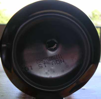

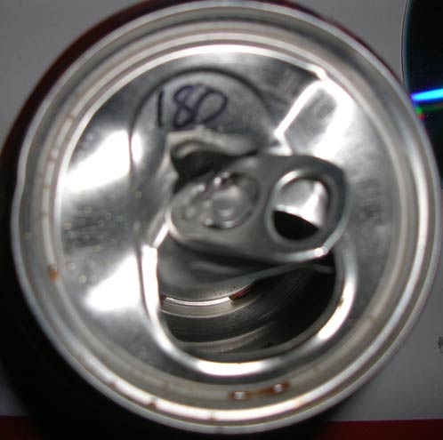

- Based on the Redwolf airsoft poor man's chrony table and ggdt predictions this was fired at <70psi. the 180 is the number of pumps. I beleive when this shot was fired I hadn't greased the blow gun, so it still leaked like a sieve.

- according to ggdt this was only <40 psi

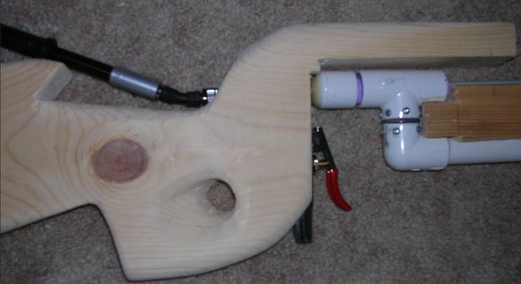

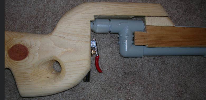

- This is a picture I took before I completed the finishing touches, it just displays how the shock pump connects through the stock to a schrader valve mounted to the back of the valve

The .2g 6mm pellet was launched from ~3 feet away at the bottom of a 1lb coffee can, which it had no trouble penetrating. The hole it left was smooth and had no ragged edges, which leads me to believe the pellet had substantially more energy than was required to penetrate the can.
The backside of the hole was perfectly uniform, a follow up shot later was not as clean, a small tear-out from the center formed with a perfect negative of the pellet before it stretched the can to the tearing point.

it needs some pics of just the gun itself. (without the wood)
