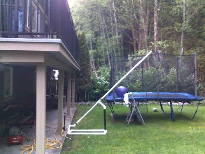

my 9 foot tall super cannon i built for my nieghboor, it shoot 1.5 inch potatos hundreds of meters!!!

Looks very large and powerful, however, it appears in uses a ball valve. BV's have high flow, but very slow opening times. You would be much better off upgrading to a modified sprinkler valve.
However, it appears that it is otherwise well constructed. It would be nice to see a video!
Hundreds of meters with a ball valve? What Kind of pressure are you using? Because I highly doubt you can hurl a spud more than 100 meters max with the setup you have right there. Very nice build though! And ditto about the sprinkler valve. Or better yet, build yourself a piston valve!it shoot 1.5 inch potatos hundreds of meters!!!

Maybe he means millimeters
lol
Looks pretty good man. Like the setup.

great cannon, i assume its not your first because it was a cannon built on request. he might be able to get 200m+ with super modifyed SV in conjunction with that huge barrel.

Yeahh that is probably wrong... a high powered piston valved mega cannon might make it 600m

With an aerodynamic dart, yes. With a potato, probably a 5th of that.it has a theoretcal range of 1400m
Anyway, nice cannon. Although people say ball valves are slow to open, which they are, you do have a long barrel which helps counter that. If you could spring activate your ball valve, you could increase performance by quite a bit. Are all your pipes and fittings pressure rated?
we used 2d kinematics after i got the muzzel velocity from another spudfiles member he used the pressure (70PSI) multilied by the area and came up with 118m/s as th muzzel velocity and it seemes logical.
i hit a house 3 streets over at 60 psi (i live in a residential area so i have no safe place to shoot it so i may not be abole to get a video this week)

Well, 3 streets away aint no 1400 meters.
i also appreshiate the suggestions about the other valve types, i have had some problems/frustration/breaking of diaphram valves on other cannons (did not exceed pressure rating)
i hit a house 3 streets over at 60 psi (i live in a residential area so i have no safe place to shoot it so i may not be able to get a video this week)

With a ball valve, your muzzle velocity is about 350 feet per second (80PSI). As for range, about 900 feet. So about 280m, which is actually what I guessed
By the way, I'm using a program called GGDT. Search the forum, Spudwiki or Google to learn about it.MrCrowley wrote:With an aerodynamic dart, yes. With a potato, probably a 5th of that.
People like you shouldn't be building spudguns. Don't post crap like that on the forum again or you will be banned. It is because of stupid acts like this, that spudguns will be made illegal in the US.i hit a house 3 streets over at 60 psi
Try spring loading the ball valve. It should be easy enough.
