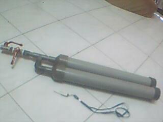

- my old air gun..
shoots AA batteries into coconuts..COCONUTS with the husk and so on...frightened my dad when he open a fresh coconut to see a battery inside @@ - 2010_5_21_16_17_44.jpg (7.32 KiB) Viewed 4628 times

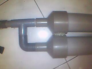

- can some1 help me..does this look let pressure rated pipes?
- 25.jpg (7.1 KiB) Viewed 4628 times

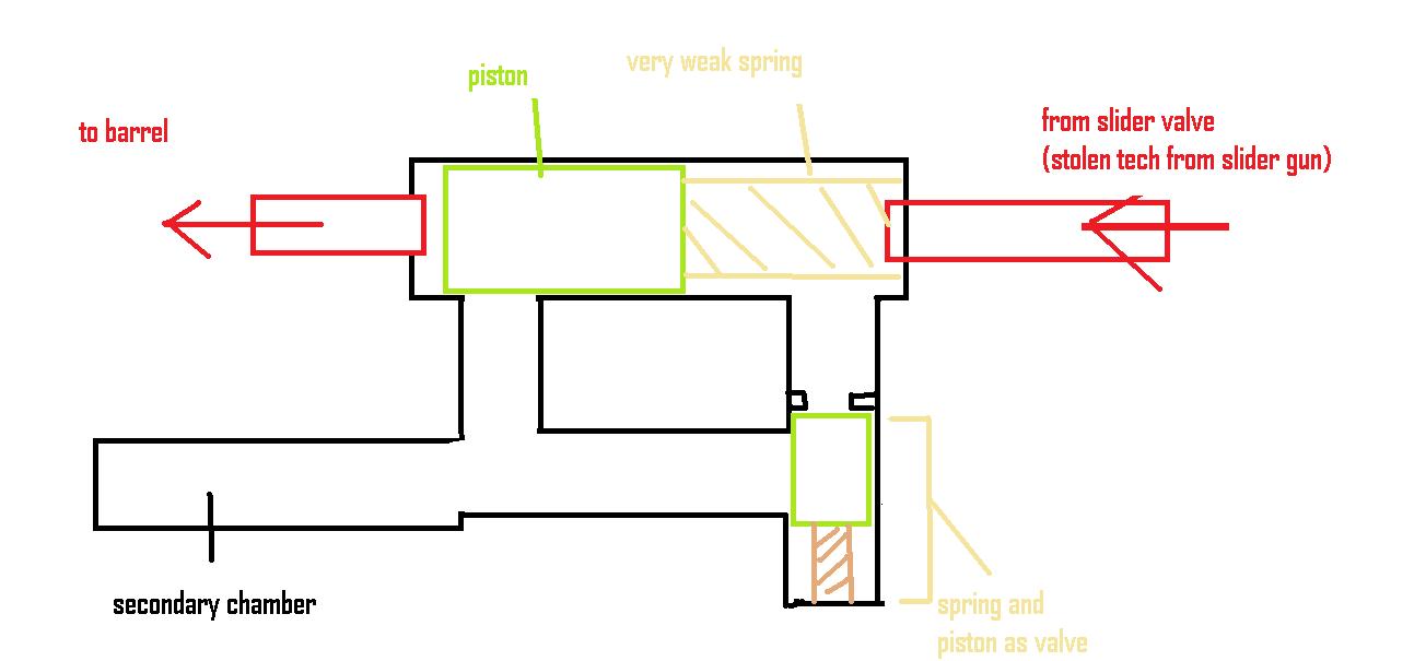

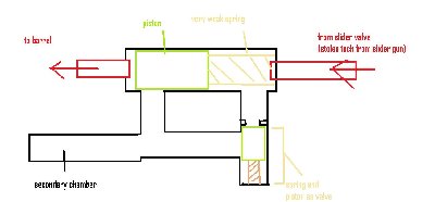

ok... let me explain how the gun works..
firstly.. i havent built it.. the 2 pictures up there are to comfirm if i have pressure rated pipes and can they hold 100-200psi safely
now.. refer to picture "test 1"
air enters the secondary chamber through the valve at the bottom until the pressure in the secondary and primary tank is equal (size of secondary take to be decided later after my mid year exams)
then using the slider valve from (http://www.spudfiles.com/forums/viewtopic.php?t=160) i close off my main chamber and release the air behind the piston
the piston flies back and all pressure in the secondary chamber is released into the barrel
when i reconnect the slider valve, the air from the main chamber fills the secondary chamber and closes the barrel-piston getting the gun ready for the next shot.. then when i open the slider valve the whole process starts again

idk if that would work because idk how you want it to work, it would be so much to just make a piston valve and the main valve and concect the big chamber to the small one with a ball valve it will work 100%
this
idk what did i do wrong?
edit: i wouldn't put 200psi in any pvc chamber ever
and if you compressor is made for filling car tires it probly wont last long mabe a week of on of use
this

you can build a semiautomatic in two ways:
1. build a valve that opens for a moment and closes. The hammer valve can do that
The advantages:
you only need that valve and 1 tank
The disadvantages:
building the valve is a bit challenging
most hammer valves offer rather lower performance
2. Build a gun that has 2 chambers - firing chamebr and an air tank that provides air for x number of shots
The advantages
good performance
reliability
simple to build
The disadvantages
requires a 3 way valve (or 2 two way valves (for example - ball valves))
requires two tanks
The advantages:
The disadvantages:
The advantages
good performance
reliability
simple to build
The disadvantages
requires two tanks

poland.. can you give me links or explain abit on the mechanism on the 2 chamber semi auto? cos from what i think.. i feel that my design is in a way a semi auto with 2 chambers.. maybe some links for examples?

check this one -> http://www.spudfiles.com/forums/viewtop ... tml#288103
I've built one like this too... AFAIK there are at least 4 more guns that operate using the same principle

I think my post explained it pretty well... IDK what you meant by
well in that case the valve might be just a 3 way valve (is it a valve that first fills the secondary valve and then vents the pilot side ?? if that's the case then it's a 3 way)
anyway... I think I got it right in the first post... I know it's a bit general and all but I wanted to make sure you understand that there are two very broad categories of guns (but you can build hundreds of completely different guns of either type)
If I were you I'd buy a 3 way valve... either a push button valve/lever actuated valve... but you can also use a solenoid valve or a slide valve
If you live in the US and you can't find cheap 3 ways on ebay you can order MJVO-3 from cllippard... add to that a QEV, a couple of fittings and maybe an air cylinder and you've got a semiauto
and what it is... I presume it's some sort of a nerf gun, right ??stolen tech from slider gun
