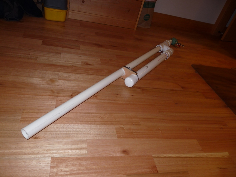

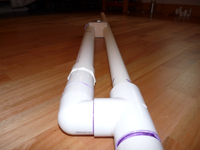

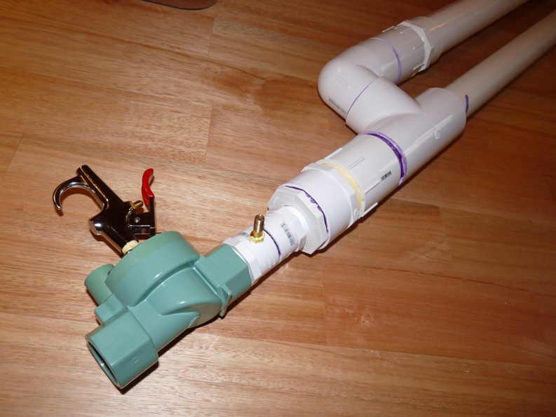

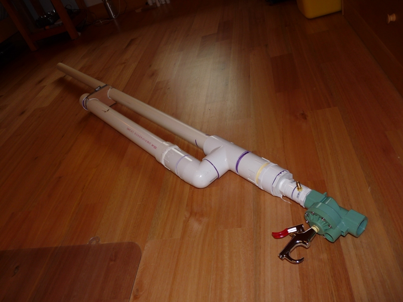

Well... Here it is
Specs:
-1.5 inch barrel - 5 ft. long
-2 inch chamber - roughly 33 inches long (can't remmember exactly, but the C:B ratio is 1:1)
-2 inch tee with 1-1/4th inch coupling piston
-Hubb design piston with built in check valve
-Spring bumper + neoprene rubber cushin (spring helps seal because I am using a hand pump, it works flawlessly yet has very light pressure as to not degrade performance)

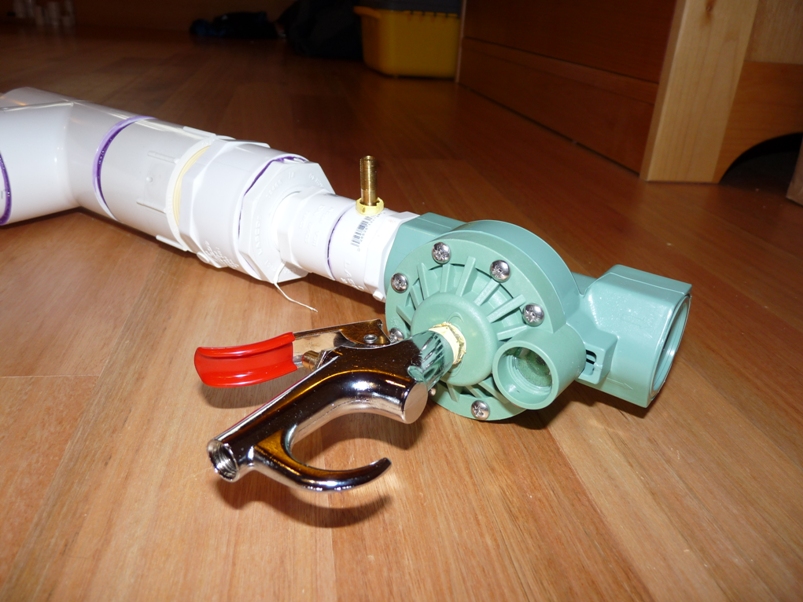

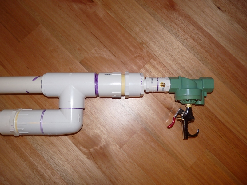

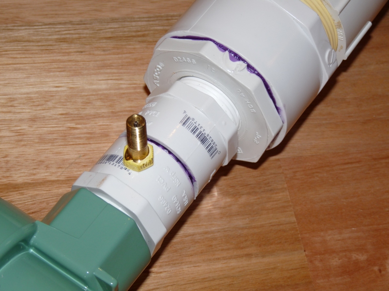

-Behind 2 inch tee is a 2 inch female adapter, a 2 inch mail adapter, a 2"x1" slip to femail thread adapter, a small nipple made out of 2 1" male adapters with a threaded shrader valve so the valve has 2 PVC layers to thread into, and finally a 1 inch modified sprinkler valve
-In front of the tee is a 2"x1.5" modified slip adapter

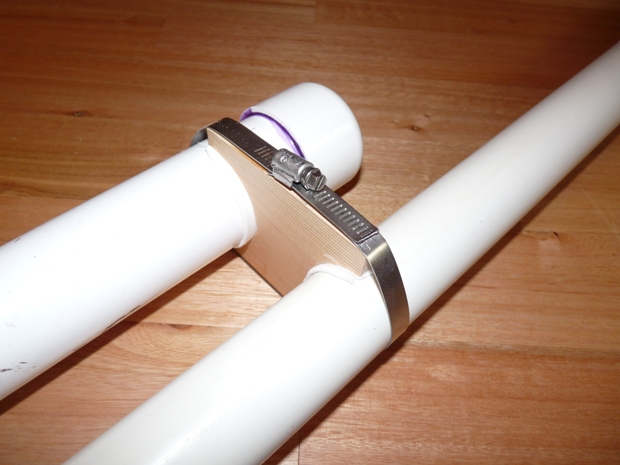

-SS hose clamp with molded wooden barrel support
-I may get some piston pics if I ever have to take it apart.

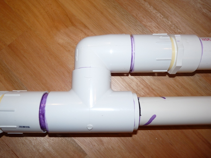

Looks good. Great job... Why is there a threaded adaptor on the chamber? I was guessing so the chamber can be switched for a different one (maybe longer or shorter?) or is there a different reason?
Ok, I have a quick question... I pumped it up to 60 PSI, and in noticed there is a slight leak on the PVC connection between the 2 inch 90 degree elbow and the 2 inch female adapter that the chamber screws into. I plugged it with some epoxy, and the leak stopped, but is the fact that there was a leak (it's a very small leak, but you can definetly hear it) putting the chamber at risk of flying off or exploding?
Thanks
Thanks
- Technician1002
- Posts: 5189
It indicates that there is a space that is not glued. It is not a tiny space like a bubble, but a large space so the inside and outside air meet. If you properly glued this with the primer, glue, and assembled with a 1/4 twist, it should not leak. If you pushed it together and had a burr on the cut edge of the pipe, that may have cut a trench in the glue softened pipe and made a narrow leak path. With a narrow leak path, it is unlikely to blow apart. If it is a large glue void, it may stress and come apart. Only you know how you glued it together.
- Gun Freak
- Lieutenant 5
- Posts: 4971
- Location: Florida
- Been thanked: 8 times
How long did you wait before pressurizing? Sounds like you made a bubble before it was fully cured. As long as it is sealed now it should be fine.
- Gun Freak
- Lieutenant 5
- Posts: 4971
- Location: Florida
You don't have to redo it as long as the leak is gone...
