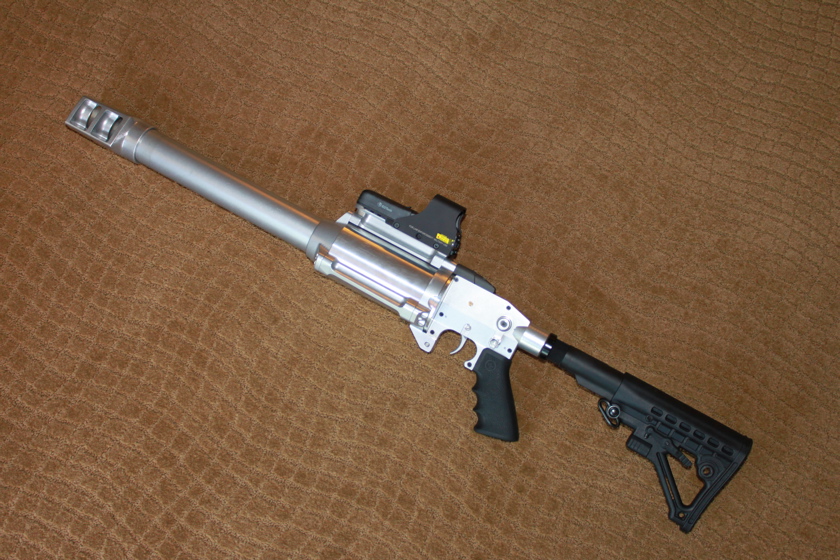

VARGAS is designed to be a kinetic energy device cartridge system for less lethal applications. Cartridges are designed to be used across a platform of different devices.
The device pictured here is the SR-1
SR-1 specs
Length 36" - 40" depending on stock extension
12" barrel (does not include internal cartridge bore)
40mm barrel bore
thumb operated breech opening
adjustable breech latch (to account for wear and closure tightness)

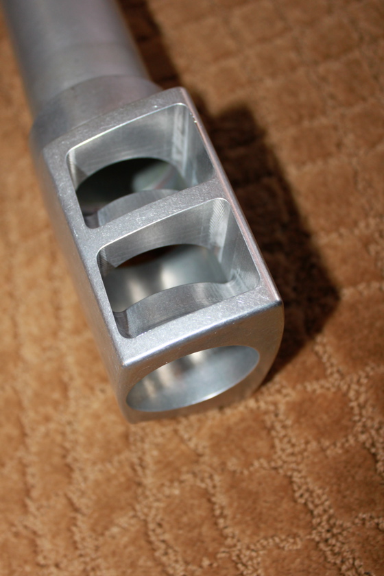

air stripping type muzzle brake (USGF brain child)
custom Picatinny type rail with EOTech 552 sight
Hogue AR-15 pistol grip
AR-15 carbine type collapsible stock.

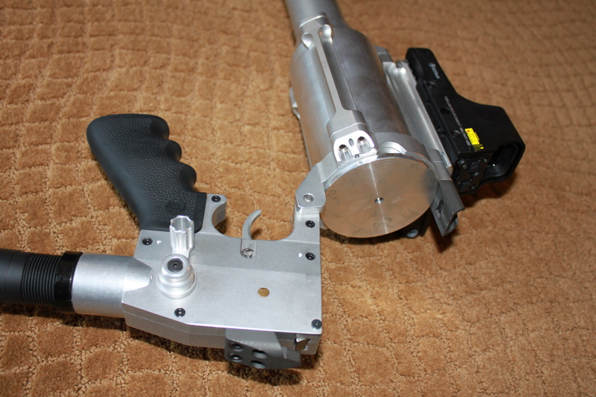

Cartridges specs:
3" in diameter
6" in length
40mm internal bore
14 cubic inch internal cartridge chamber volume
compact internal piston valve (some patent pending stuff on the inside, sorry no pics for now)
operating pressure 100 - 600 psi (safe rating to 1000psi)
typical operating pressure 400 psi
We are currently developing our own round design based on our compound round. The initial ballistics tests show a 10.5 gram ball achieving 652fps with the 12" barrel, cartridge charged to 600psi and no muzzle brake.
Also, we will be anodizing in matte black.

The fill station hangs on the the cartridge rim and fills through the internal cartridge pilot valve. Takes about one second to fill.jrrdw wrote:How is the cartridge refilled? What all is that going to take? Cost?
We will develop a proprietary compound round for less lethal applications. Similar to current but replace the steel head with rubber.
Cost, unknown at this time. Lots of factors to get ironed out still.
Beautiful, and it was a pleasure to assist
though of course it's the handiwork you and Pete are capable of with the help of your fantastic machines that takes the credit.
Even if it didn't fire at all, the psychological effect of staring down that drainpipe bore must be enough to do the job, especually with the muzzle brake on
looking forward to seeing some action videos which I am confident will be forthcoming

I doubt Mike mentioned how long it takes to make a cartridge. Suffice to say that the complexity and close tolerances required means a long series of operations on both CNC mills and lathes. Yes, it requires at least 3 of our machines to make. The valve portions are made on a small CNC chucker lathe. The body is turned on a large CNC lathe but the internals are done on a large CNC mill. The end cap is much the same. The simply external shape belies its internal configuration.
Thanks again
USGF
I clamoured incessantly for simplicity, and the use of commercially sized tubing, but noooo, you just had to overcomplicate things to show off what your fancy machines are capable of
At least you ditched the original "honeycomb" design
It is still a honey comb design, less holes though means we sacrificed .5 cubic inch internal volume.jackssmirkingrevenge wrote:I clamoured incessantly for simplicity, and the use of commercially sized tubing, but noooo, you just had to overcomplicate things to show off what your fancy machines are capable of![]()
You were right about cartridge growth. With it fully charged it grows in width and surprisingly in length. The prototype cartridges had to ride the lathe a second trip before the loaded cartridges would allow the breech to close.

jagerbond wrote:It is still a honey comb design, less holes though means we sacrificed .5 cubic inch internal volume.
Still think it's over engineered for the pressures you're using, but then again I'm not known to operate within massive safety factors and especially with something that you're marketing you'd want some safeguards in terms of liability so I guess I grudgingly see your point.
It's something you can use to your advantage because automatically makes cartridge extraction easier. Are there plans to fit a spring-loaded assist to pop the cart out or does the fact that most of the cartridge body is exposed make extraction?You were right about cartridge growth. With it fully charged it grows in width and surprisingly in length. The prototype cartridges had to ride the lathe a second trip before the loaded cartridges would allow the breech to close.
engineering aside, its way too difficult to remove the material that deep with a lathe tool or a long endmill. If we decided to make it a 2 piece that would add more leak paths and milling setups associated with 2 parts. Maybe I am misunderstanding what you mean.jackssmirkingrevenge wrote:jagerbond wrote:It is still a honey comb design, less holes though means we sacrificed .5 cubic inch internal volume.
There 2 cut aways for regular human sized fingers to pull out the cartridge. We went the simple route on that. Admittedly I am bias, but it seems ergonomically comfortable.
