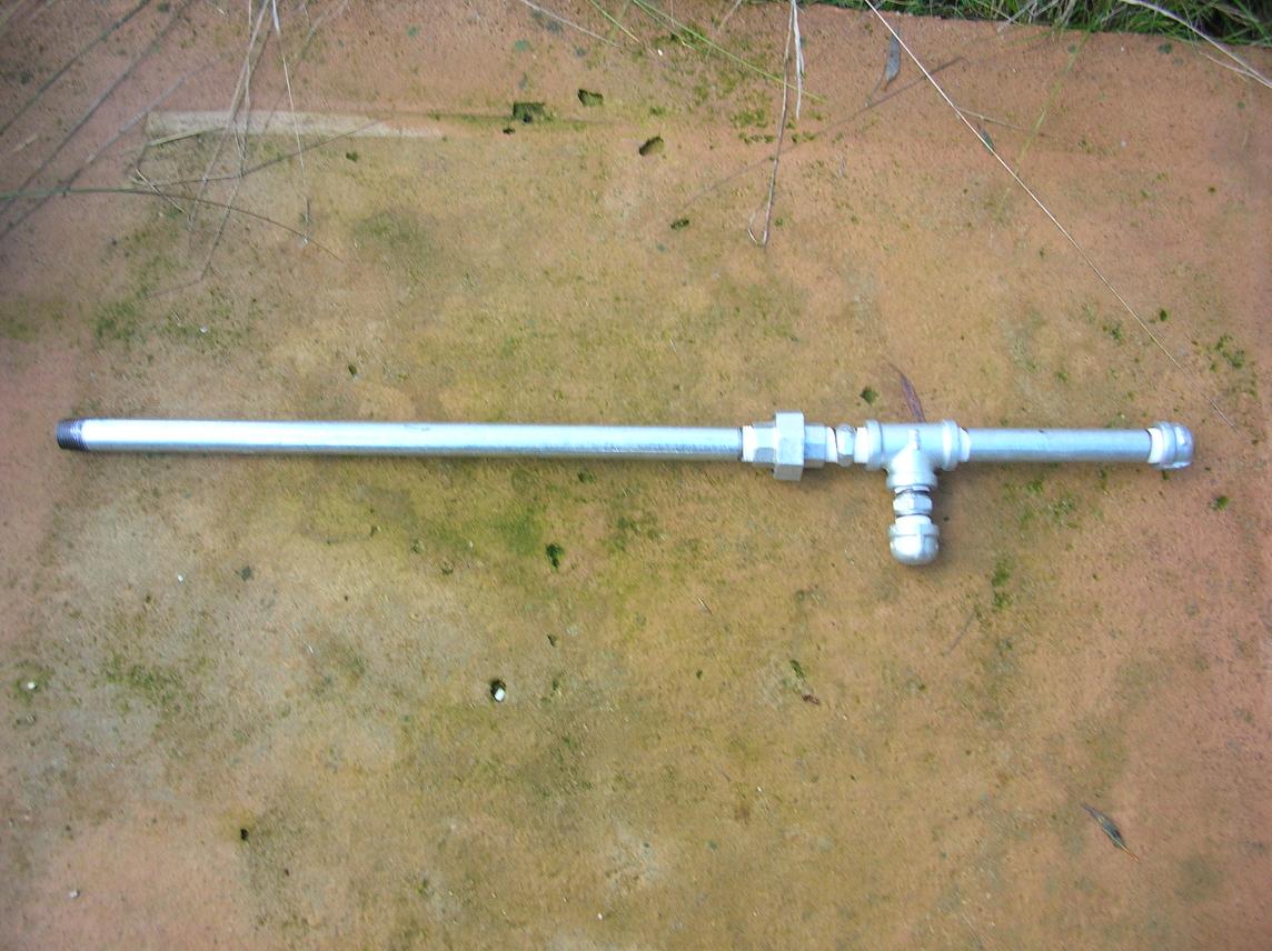

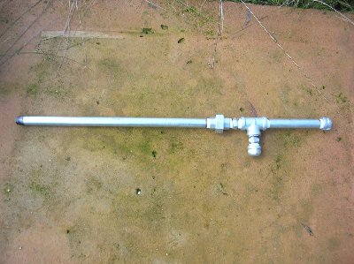

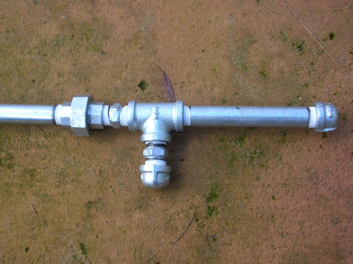

Yesterday I designed a hybrid (in my head). I ended up in a hardware
store 4 1/2 hours ago. This is the result.
It still needs the spark gap, cable gland & one way valve.
I want to install a 1/4 inch NPT shrader, instead of binary adhesives.
And the specs
15mm bore (at the moment)
45cm barrel
45cc chamber
20mm burst disc
1-5X mix
That's about the sum of it, so let me know if I've missed anything
or if you want to know something.

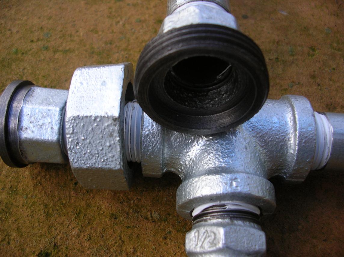

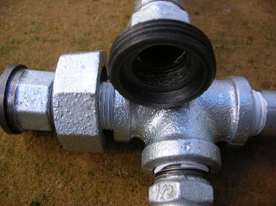

The union open
The union open

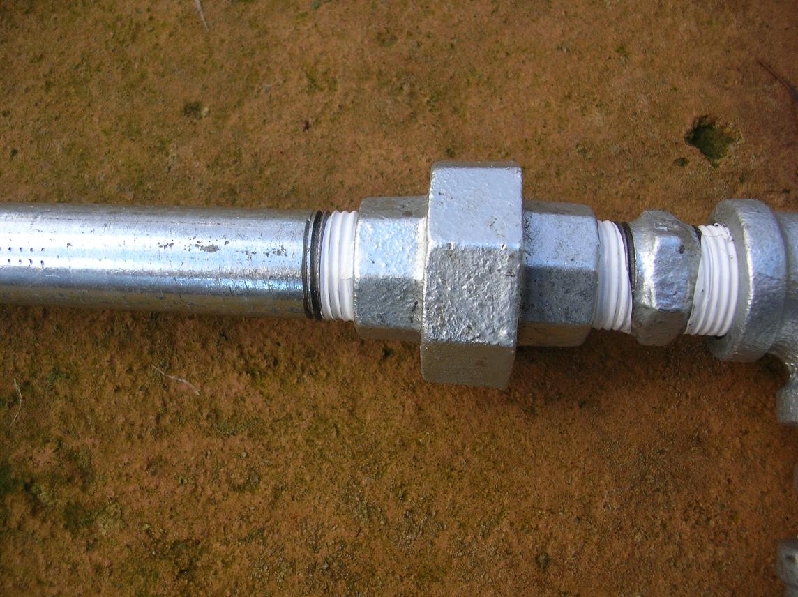

A closeup of the union. Anyone seen one like it?

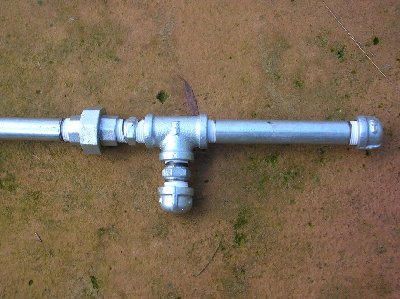

The chamber, handle & union
Sorry, the photo is terrible

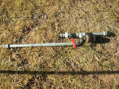

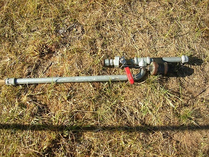

Update, nearly finished

Does the barrel have a seam through it? How do you plan on installing the ignition?
Zeus
Posts: 1505
Location: 'Straya, C*nt
The barrel is seamed, but I plan to wad the projectiles. Also, ignition
will be machined HDPE with a M3 25mm bolt.
It's low voltage ignition, so insulation isn't much of a problem.
Thanks for replying.
Ah, a couple of firings and the seam will probably wear smooth anyway ;) good luck with making it happen. Is it going to be hand-held or mounted?

Handheld, the damn barrel was the most expensive part, I couldn't get the 7.5mm 100cm aluminium tube that I wanted, couldn't find the 12mm
150cm copper either.
[Edit: thanks chinnerz, I should have it going by Monday]

Thanks, I might make a wire frame stock, the end caps were $1.69 &
the chamber was $7.80.
If you (or anyone else) is in Aus, let me know and I'll PM you the hardware store name.
