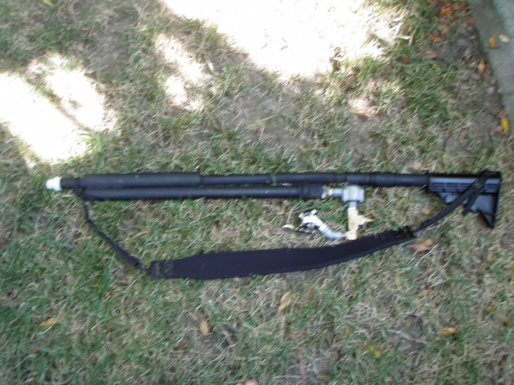

So it has been a while... A long, and somewhat painful while without being able to build. But its summer again here and I am at home again with full access to weapons building tools and a larger bank account due to an actual job. After a day with an old friend who wanted to plink a little, I realized that I needed to make somthing more reliable than what we were using at the time.
This is a simple QEV launcher. 1/4 inch npt valve, with a 33 inch barrel of .25 inch ID brass tubing. I shoot 1/4 inch chrome steel ball bearings and airsoft bbs. An old 3/4 inch npt piece of pipe I found that belonged to an old pipe threader makes the chamber. Simple right? But then I had to make it look purty :roll:
Yes that is a rail on top, and a M15 A4 Carbine butstock from an old airsoft gun. Ive been having trouble with sighting. This thing shoots extremely high (about a foot high at 45-50 feet), but is really, really, powerful. This packs more punch than my .177 cal single shot pellet rifle. I had a rifle scope on it at one point, but due to the problem with the accuracy, it was unusable.

That is very Sleek :o, does the chamber run along the top of the gun and also into the stock or is it just one? What kind of range are you getting and some damage pictures would be amazing
Looking good, what pressure are you running at? Looks like it will happily take a couple of hundred psi.

Hey guys. First of all Caz, the chamber is actually under the barrel. Its the shorter tube. The stock is not part of the chamber, and does not need to be.
I run it around 110-120 psi only because I dont not have access to any high pressure source. I have been thinking about making a smaller bore pump, but havent gotten around to it.
