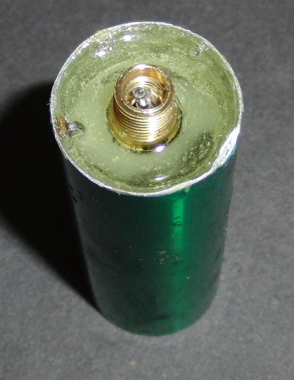

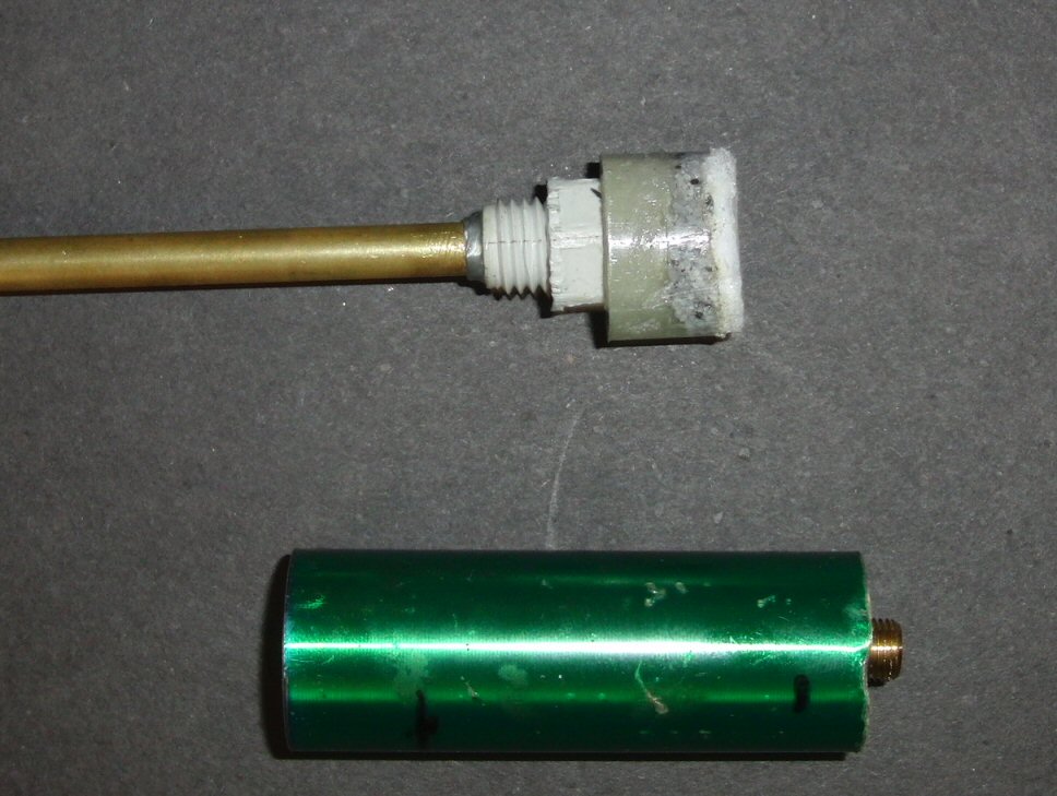

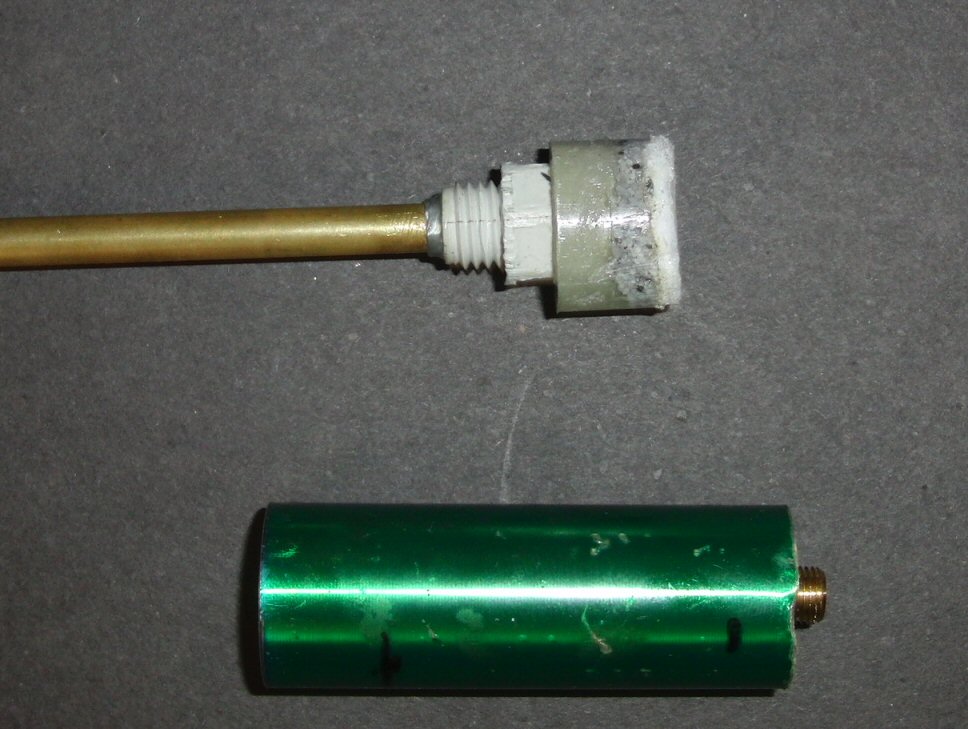

I was testing this hybrid, after a few clicks it ignited at 6x, so I decided to up it to 8x, with a burst disk cut from photo paper.
The good news: it ignited on the first click :D BOOM!
The bad news: the burst disk didn't live up to its name, so the epoxy end cap popped out instead with a tremendous flash :?

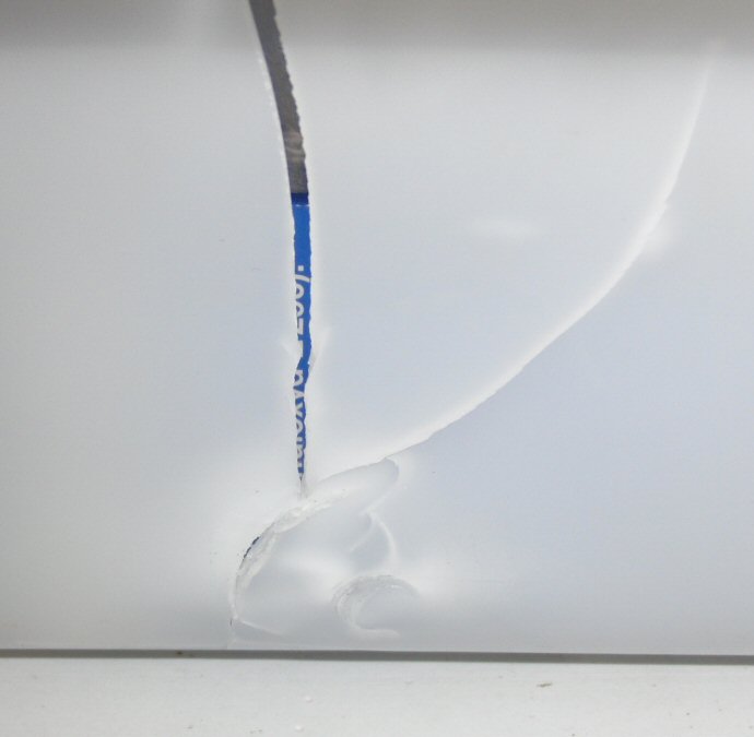

If you look at the base, you can see the distortion on the chamber body and schrader valve from where it hit the wall.

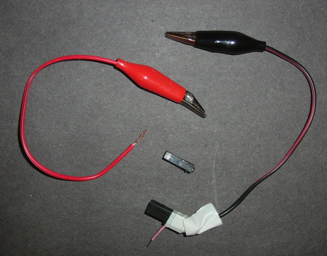

edit: found the mangled remains of the ignitor that was taken out of my hand with considerable haste...

how about if you round the ends inwards? help keep that epoxy plug in!

Except this time maybe drill some holes in the body for the epoxy to lug into. I know you would have roughened it, but it obviously needs moar :D . Maybe think about using some aluminum powder to bulk your epoxy up as well.

I think thicker tube with holes drilled near the end, sleeved in another thin tube for the sake of neatness would work well... really give something for the epoxy to grip onto.

I also think that maybe aluminium tubes taken from the inside of a printer cartridge aren't exactly the most suitable materials for high pressure applications...

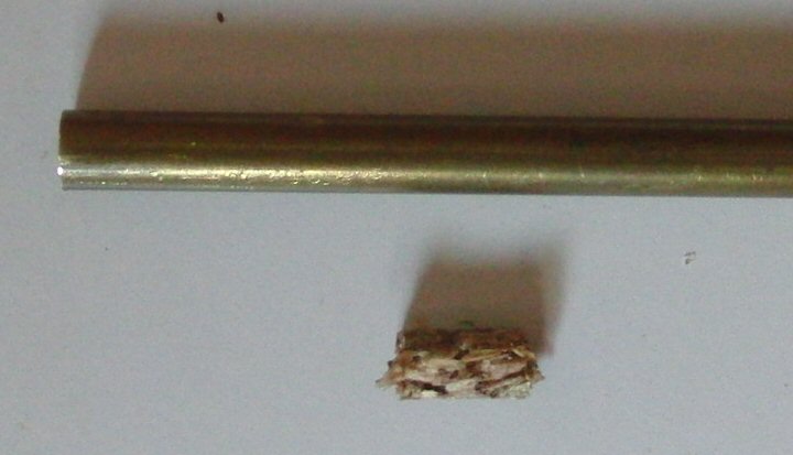

Hehe I just realised, look what was wedged in the muzzle! This means that the barrel jammed itself into some part of my furniture at some point, then bounced off! Still can't figure out which of the holes in my furniture it is though :roll:

I just keep finding damage, looks like the chamber hit the plastic tray where I keep my ammuition on the way to the wall :roll:
