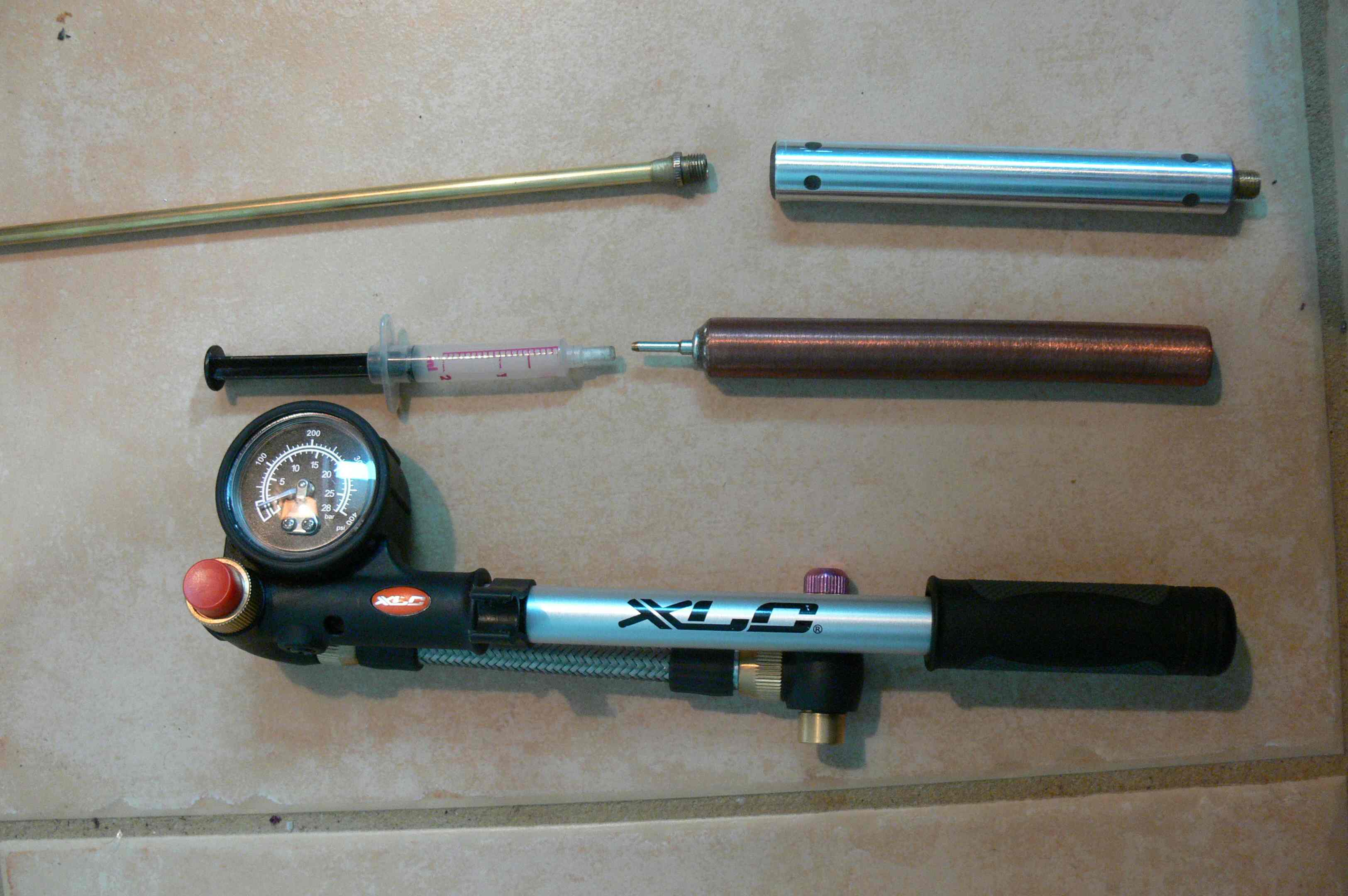

this is my mini hybrid cannon inspired by JSR's mini hybrid.
barrel; 40cm x .5cm
chamber; 11cm x 1.3cm
chamber volume; 13ml
valve type; burst disk - photo paper
fill valve; schrader
spark gap; .5mm - .25mm
fueling; directly injected into the chamber with syringe
ignition; 9v DC ignitor
fuel; butane
well here are some pics tell me what you think!

just tell me what is that copper thing
yea i love this thing i think im addicted to the mini hybrid stuff wouldnt mind trying a bolt action cartridgejakethebeast wrote:yeah this mini hybrid mayhem is the best, every day something new to readjust tell me what is that copper thing
oh yea i probably sould have said this before, its a mini refillable lighter refill i made, makes it a bit easier then having to use one of those big bulky ones

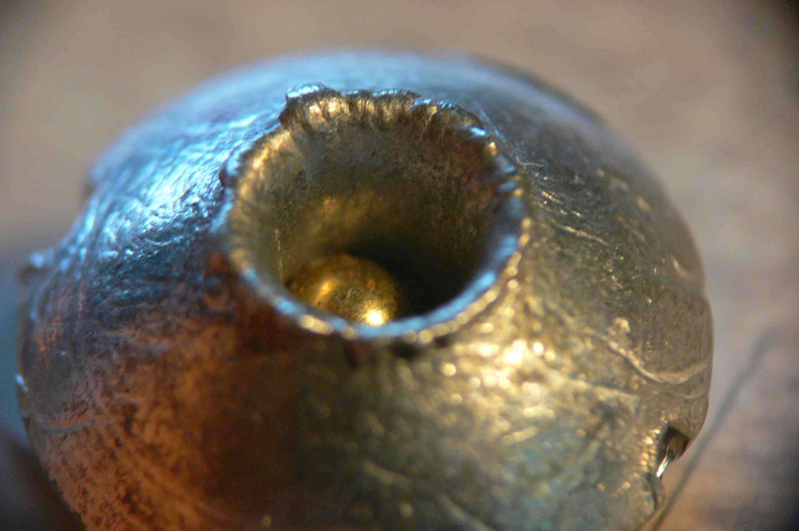

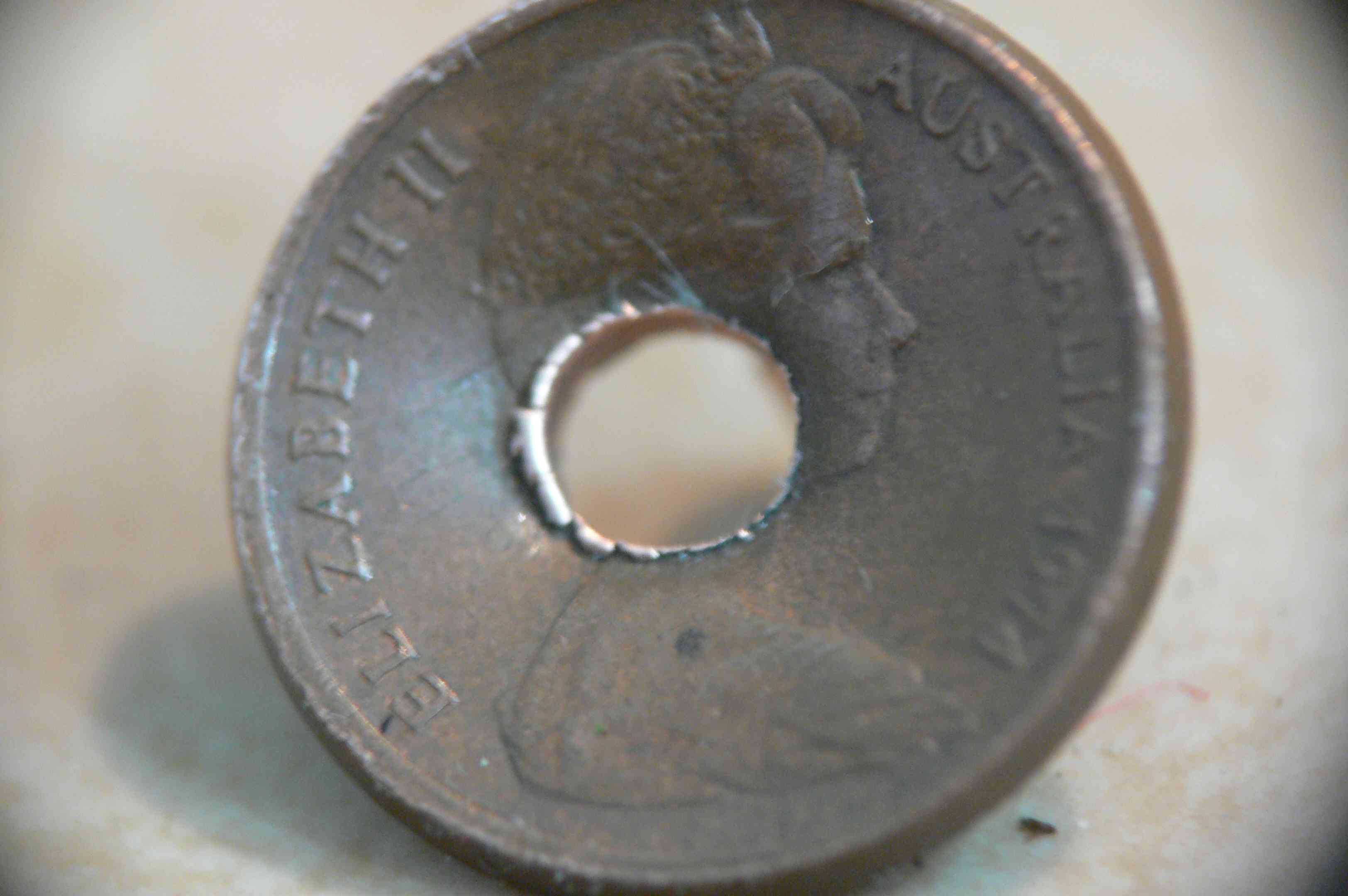

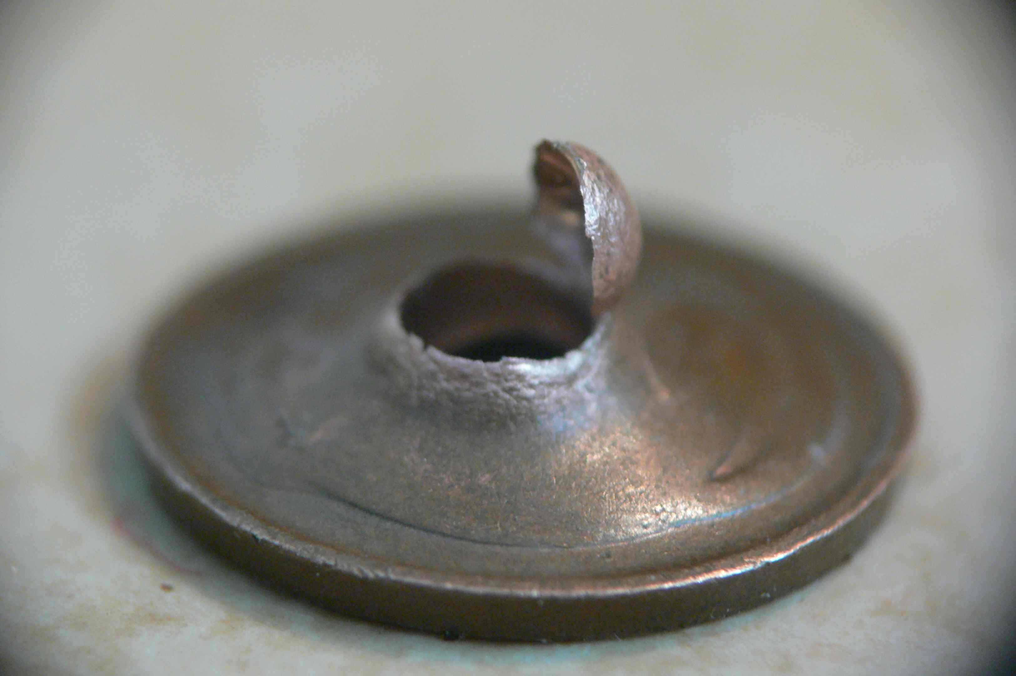

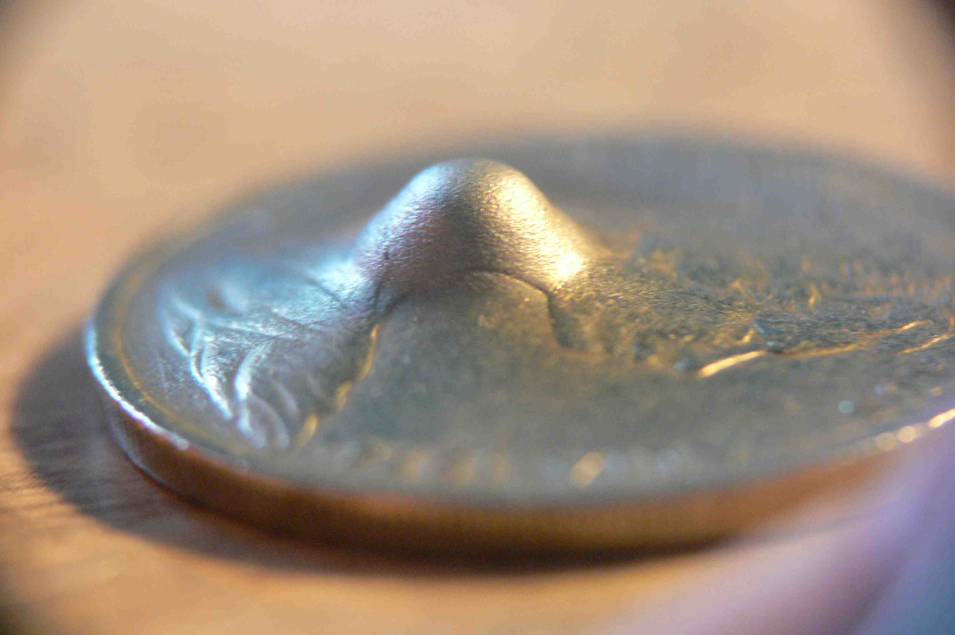

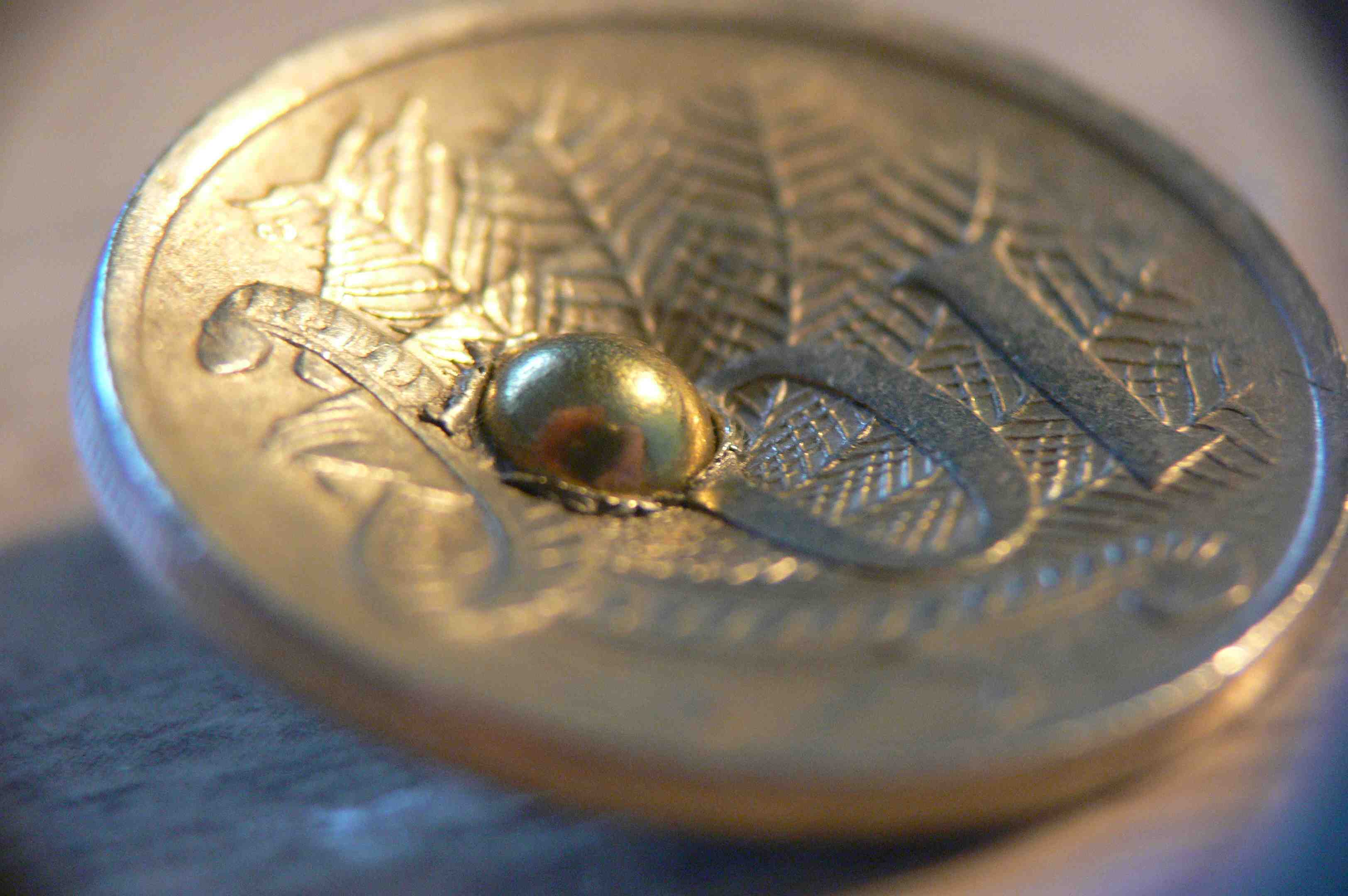

edit: got some more damage pics both were done at 15x with 4.5mm steel bbs
