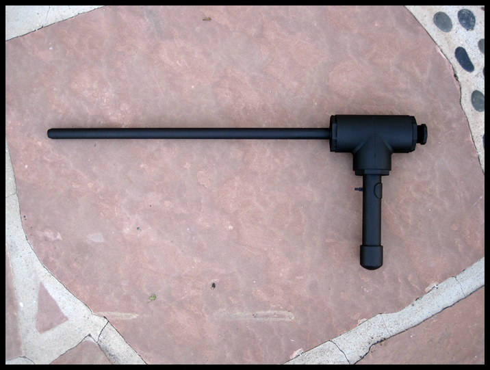

Probably to big to qualify, but I thought I would share anyway.
I built this so I would have something to shoot the leftover potato rings when I'm shooting my jumbo spray-n-pray cannon.
I used roughly the same proportions as my big cannon. The barrel is 1/2" dia. and 21" long. The chamber is a PVC tee fitting 2" dia. by 4" long. I used a peizo sparker from a lighter and managed to rig a pistol-style grip and trigger.
It took a while to find a gas syringe, but once I did I quickly figured out the amount of gas to use.
So now when I'm shooting the big cannon, someone else can have fun with this. And less of the taters is wasted.

I don't know, "mini" is a pretty loose term, generally spray n' pray guns have a >1" bore, so do advanced combustions, I'd say it's a mini.
It certainly looks like a nice build, what do you mean by "gas syringe", to measure gas I just use a syringe with a piece of brass tubing glued on to fit a butane bottle valve-thing.
I'd assume that since you're using a syringe you're getting good stoichiometry?

well it's actually a syringe used in a doctors office to clean out peoples ears!
But it slides easy and has graduation marks so I know how much gas I'm using. I plug it in to the gas bottle. When I open the valve slowly the bottle pressure will move the plunger back.
I calculated the chamber volume and use about 6% propane - right in the middle of the explosive range.
