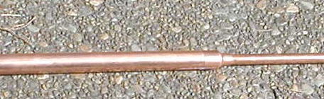

Soldering temperatures damage epoxy. The muzzle end can be assembled using a reducer filed out so the barrel can pass through it.
The breech can be done with a female threaded adapter on the end of the chamber to permit servicing the piston. It would look something like this one at the muzzle.
Near the breech of the barrel you will want some kind of support to keep the barrel centered. The small magnet could be placed in the chamber but it is not needed. If the piston moves back no more than 1/2 the barrel diameter, the piston will prevent the ammo from falling out the breech. Without a magnet, cheap ammo such as marshmallows, fishing weights, golf t's, and marbles can be used.
Edit, I noticed your sizes.. maybe airsoft, pellet gun pellets, rabbit food, etc.
Coaxial Copper chamber/barrel assy.

I would like the compactness of the drilled and tapped method, I'll look into using a 5/8" (1/2" nominal OD) piece of brass rod drilled and tapped, so no epoxy parts to hurt, and just a wood piston.
Edit:
would aluminum or other cheaper than brass materials work? can i solder that?
Stay with copper. It solders best. They make a special solder for aluminum, but it is really hard to do right. Aluminum oxidizes rapidly causing difficulties with soldering. Cleaned and fluxed copper solders very well.
