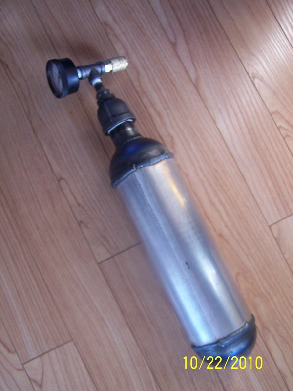

Hey Guys,
I wanted to share a picture of the tank I just built for a 1-1/4 inch bore cannon. It consists of two steel hemispheres from Wagner industries in Milwaukee Wisconsin. They cost $4 each. The straight portion is a piece of 4 inch exhaust tube. All total, I have $16 invested in this tank. I pressure tested it (yes, it was covered and behind a steel door when I tested it) to 275 psi and it held fine. I have one very tiny air leak at one weld. I will fix that tomorrow. It is truely microscopic, though.
Anyway, I will use a 200 psi blow off valve. I figure if it held 275 psi, 200 should leave a safe margin for error.
I will post a build thread when I get more of this cannon built.
Matt

It would be a better idea to test it to , let say 3 or 4 times higher pressure than you plan to use with it
- Technician1002
- Posts: 5189
It is a good idea to fill it with liquid such as water when testing so a failure will be low energy instead of high energy with an explosive release.
Look up Hydrostatic testing for more information on this testing method.

Your tank appears to MIG welded........is it?
It is, indeed, MIG welded. I do not own a TIG. I used to do MIG welding for a living. It comes second nature to me.
Great idea to fill it with water for testing. I never considered that!
This tank is .062" wall (The exhaust tubing is). The end caps are .120" wall.
I spoke with an air tank manufacturer yesterday regarding tube thickness for a tank. He mentioned that they sell tanks that are burst rated at 3 times the useage rating. He said a 6 inch diameter tank would be speced by their company at .120 wall steel. That means a .120" wall tank would be good for 600psi. Therefore, they would certify it at 200psi. A smaller diameter tank can tank more pressure per wall thickness. So, this 4 inch diameter tank should be perfectly fine at the 200 psi I am looking for.

Do you know what equation they use to get those numbers? What it the steel grade(or tensile strength).That means a .120" wall tank would be good for 600psi.
I'm just wondering because those big propane tanks are tested to 300 psi and they are much bigger and thinner than the one you describe.
Have they actually caused a failure with a 600psi test?
Not sure about the tensile strength.Fnord wrote:Do you know what equation they use to get those numbers? What it the steel grade(or tensile strength).That means a .120" wall tank would be good for 600psi.
I have thought alot about this. Assuming the weld integrity is good, even a mild steel tank can have pretty thin wall and still tolerate a huge amount of pressure.
The Propane tank is a cool idea. However, I needed more than twice the capacity of that tank anyway. As it is, this tank is somewhere around 1.3 to 1 ratio to my barrel. A small propane tank would not be big enough and I do not want a large diameter tank at the end of my cannon. I looked for a number of different tanks to use and ended up with this tank. It works for its intended purpose.
Matt
