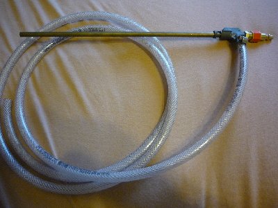

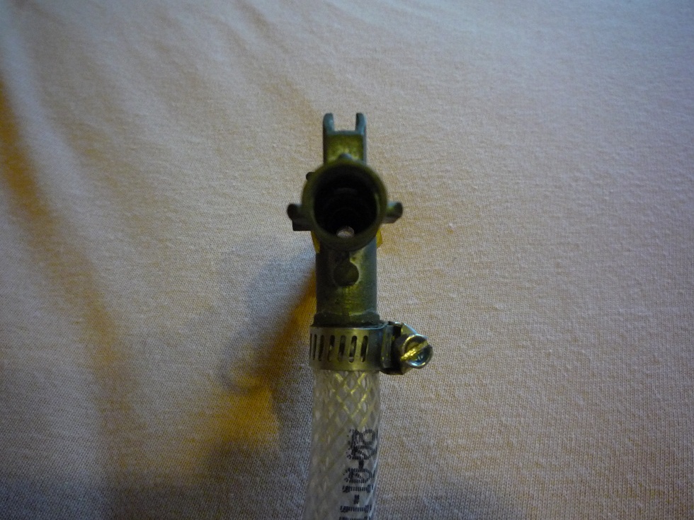

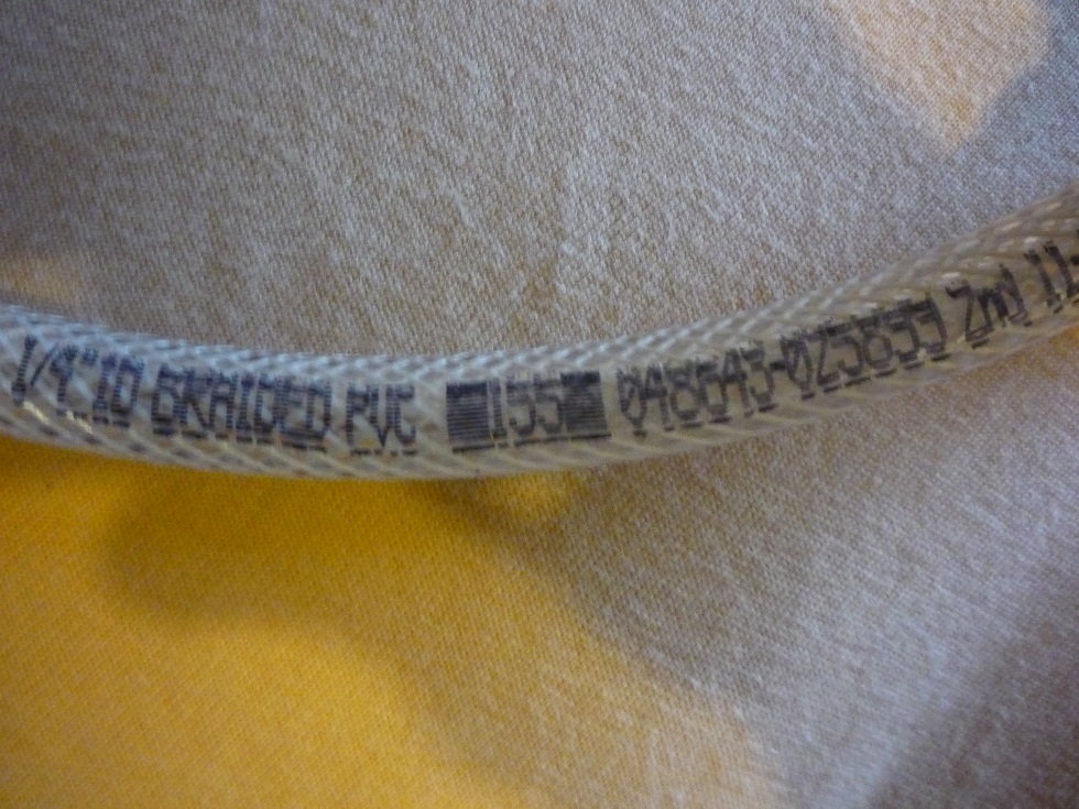

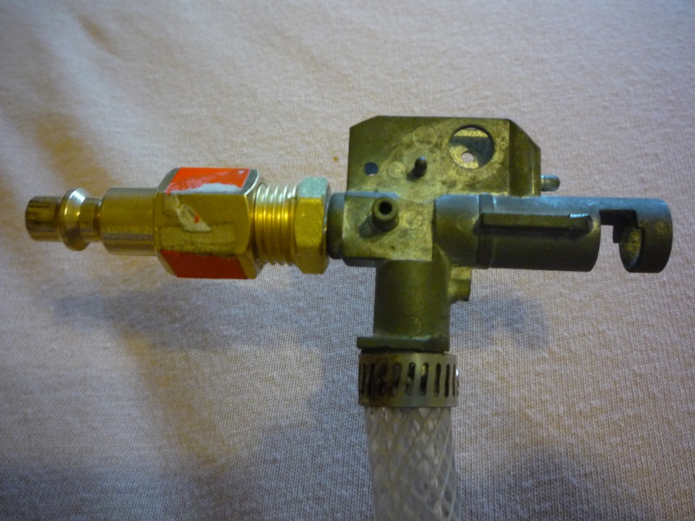

I am in the process of making a direct feed BBMG. The base for the mechanism is a metal M4 hopup unit that feeds into a 6.05mm barrel that is 363mm long. The bottom of the hopup is connected to the ammo feed hose which is a 1/4 ID high pressure braided hose. The rear nozzle is a 5/16th nipple with 1/4th MPT on the rear. The nipple was cut down to 9mm in length so as not to interfere with the ammo feed and was turned down to 7.8mm to fit the air nozzle hole very snugly. It will be powered using regulated CO2 from a Kobalt regulator and actuated using a 1/4 inch 12vdc solenoid valve. the unit will be placed inside of a 6 barrel Gattling type gun with rotating barrels.

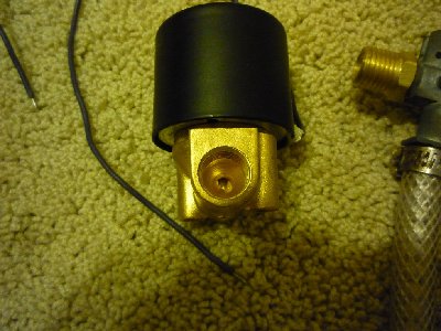

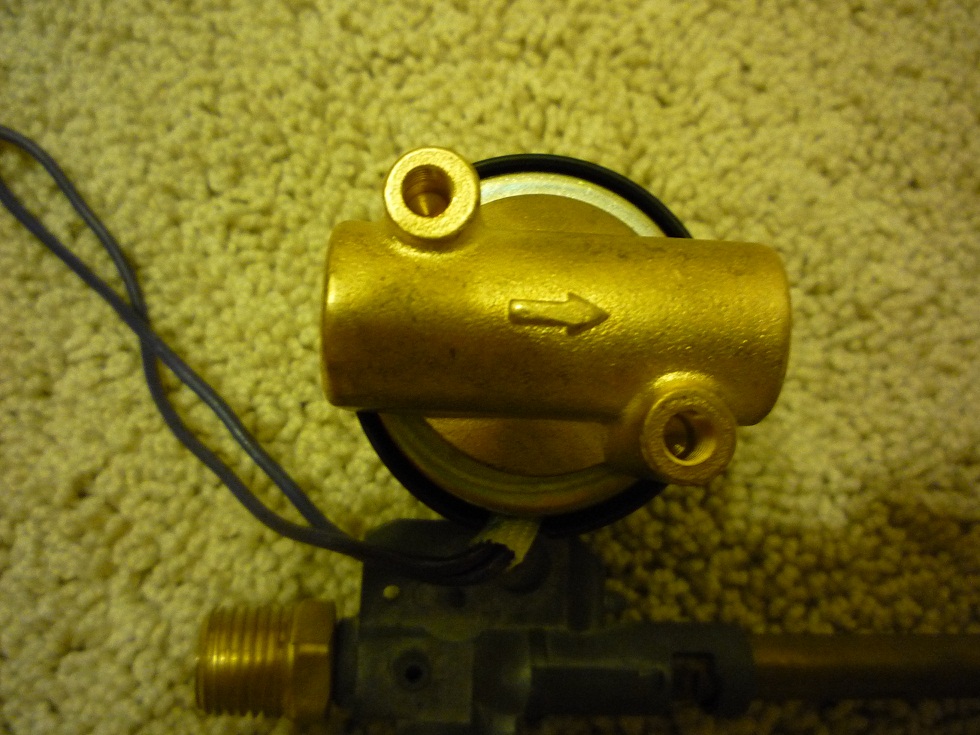

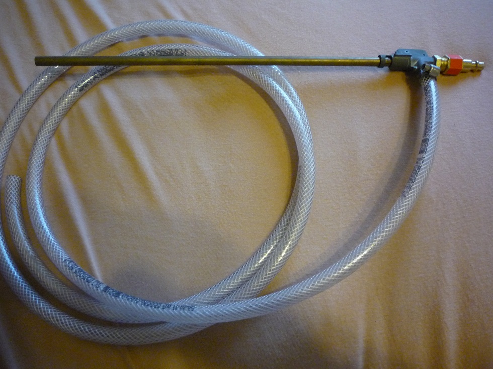

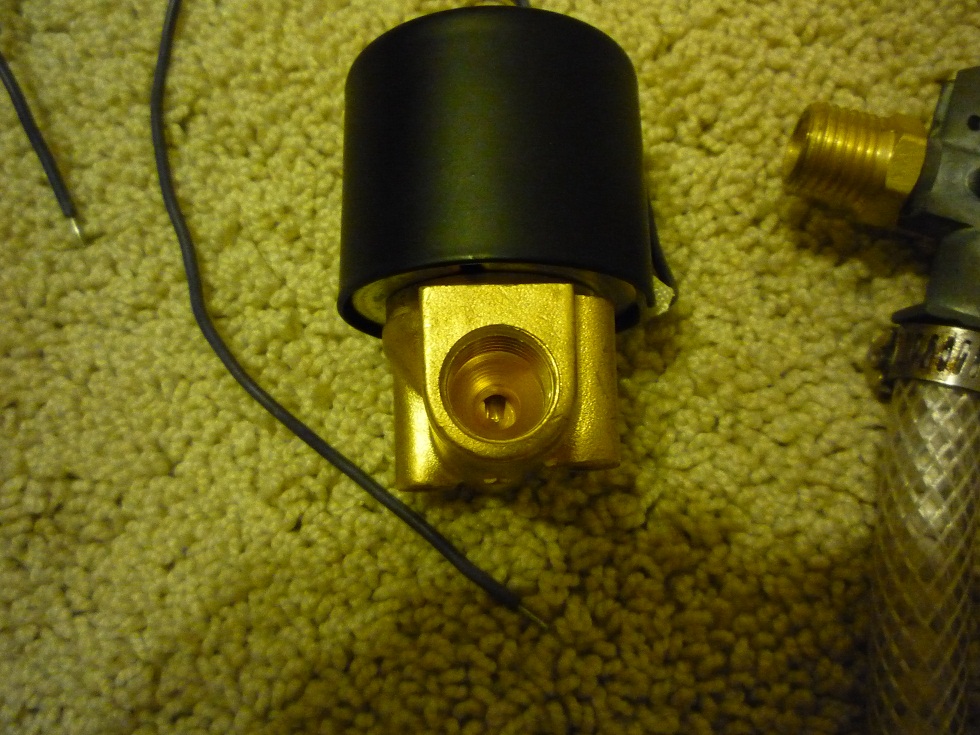

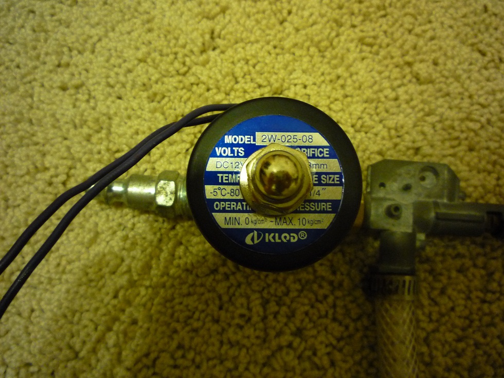

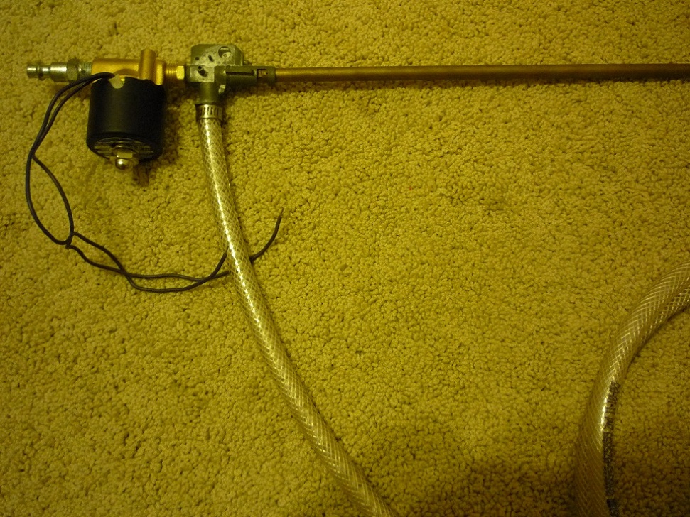

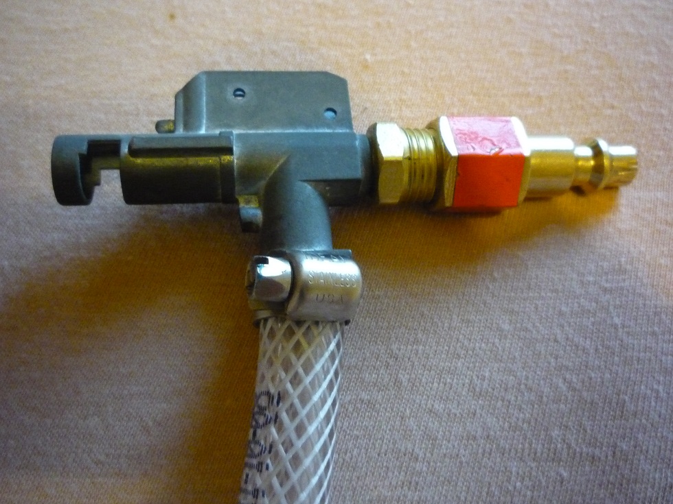

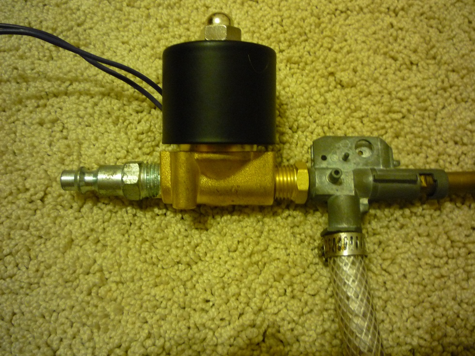

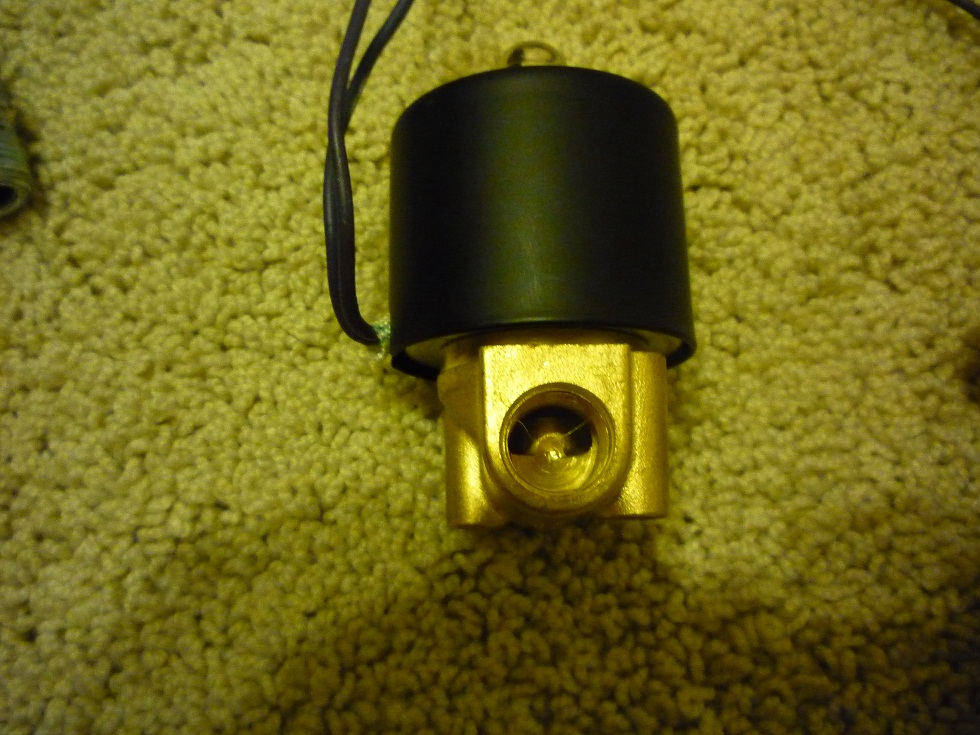

I got my solenoid in the mail today and it looks nice, I should make it by the hardware store tomorrow to get the stuff to finish the mechanism. Hopefully I will be able to fire it in base form this weekend... The Pictures are of the Mechanism with the Solenoid on in the way that I had planned on running it but I have decided to change that up. I will run the air into the solenoid using an air chuck, it will then exit and be split into 2 lines using a T. From there each line will be sent through a ball valve to control airflow to the feed side and the launch (pressure) side. The bb feed will be a modified cloud system that feeds into a line that dumps into the bottom of the Hopup. The other side of the T will feed into the rear and dump the pressure into the barrel. This system will let me control feed rate and overall velocity simply by turning 2 valves.
Sean
Sean
