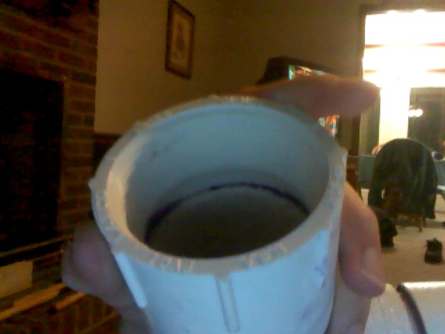

On my new golfball gun when I was gluing a fitting in it stopped about 1/4-3/8 inch from the end of the fitting. The two fittings are flush and Ive poured epoxy is the gap and where the two fittings meet. Would you feel safe using this at 80 PSI and under. I thought about drilling holes for screws and covering them with epoxy but I was afraid this would weaken the fitting further.

My ABS cannon has the same thing. Pressure test it and avoid flexing the joint.

Thanks, Ill probably pour the epoxy either way and from what I have heard so far I believe this will be more than enough, any other opinions are welcome.

You're fine, it is still deeper than the depth of a DWV socket, which is good
You will be fine.
Always a good thing, and at "only" 80 psi it should suffice.clemsonguy1125 wrote:Thanks, I'll probably pour the epoxy either way

Thats what I thought, epoxy can hardly ever go wrong, thanks.
Oh it can, and it will, if used incorrectly.clemsonguy1125 wrote:epoxy can hardly ever go wrong

Well that is 770 psi more than I use and also that had large amounts up unsupported epoxy, also would putting the screws in it cause anymore danger even if they are not needed. It would help with my peace of mind.
