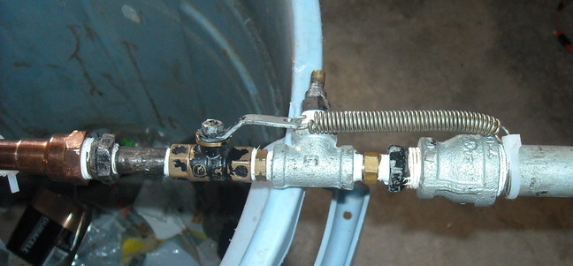

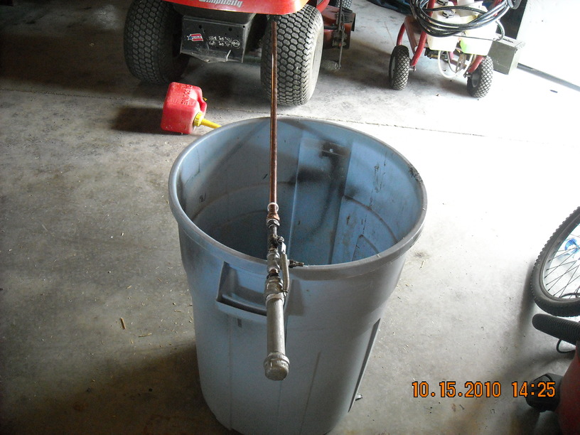

The chamber is 6x3/4" the barrel is 1/2x43" these values mean nothing the barrel length is just the piece i had laying around.
The 1/4" ball valve is spring actuated by a coil spring that i had laying around. I just got my fridge compressor setup and i have been shooting at about 300psig, i am limited by only having a 300psi gauge.
One quick question shouldn't a grease gun hose withstand friggy presures, it was rated to 4500psi, but an air bubble got under the outer casing of the hose.
How would i model this 1/4" ball valve in GGDT.

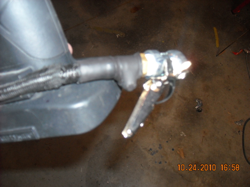

The seal in the origonal airchuck wore out so i cut it off, installed hose barb and put this lock on couplerin place

I hold the valve closed with zip ties, when ready to fire i cut them, this is the poistion after firing, the fill valve was made though this procdeure <br />http://www.spudfiles.com/forums/how-to-make-a-threaded-schrader-valve-t19609.html

doesn't it get annoying having to constantly replace zip ties?
maybe a system similar to the one here would be preferrable http://www.airgununiverse.net/beginner1.html

Is there a reason you restricted the size of the air passage from the chamber to the barrel to 1/4 the area? May I recommend using a 1/2 inch or larger ball valve to feed a 1/2 inch barrel?

The only reason for the rstrictive valve is that is gun was not origonally intended for high performance, this is an earlier incarnation of it http://www.spudfiles.com/forums/my-air- ... 20662.html
I would like to put a larger valve or a QEV on it but it hasnt happened yet.
