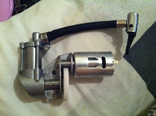

Today I picked up one of those little 250psi 12V pumps from Bunnings for $11.. Before stripping it down, I tested it to see what it could do, and to my surprise it got all the way to around 190psi before I shut it off.. It could likely go farther but I didnt want to push my luck..
So then I got to pulling it to bits.. And inside I found EXACTLY what I had hoped for.. A compact piston system with a motor the same size as used in my electric RC cars, same mounting pattern and all..
I ran the pump again with my half charged 7.2V Lithium RC battery and again, up to 190psi.. just slower.
As usual I got to removing unnecessary bits with the good ol' dremel..
The picture below is the result of my hacking. I re attached the pump line just for now, though Ill be taking it back off to implement the final plan.

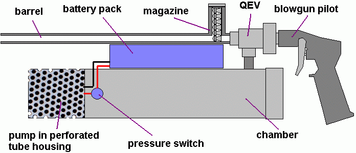

Here's how I picture it...

That was the plan jack.. minus the QEV in there...
But it looks like it will be more effort than its worth.. So I think Im gonna stick to the soda stream bottle at a high pressure with a regulator idea.. will be compact and light
