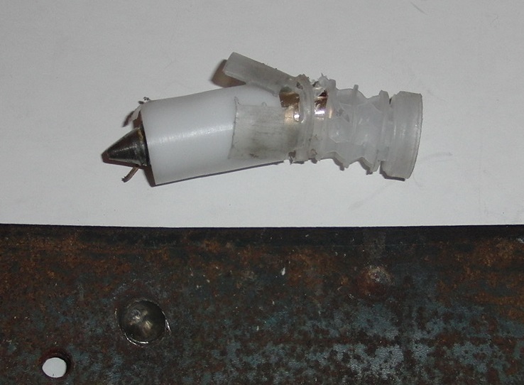

Followinghybrid shotgun fail, I give you hybrid shotgun win!
At 9x, this time using an actual 12 gauge wad and 9 x0.177" lead BBs :D

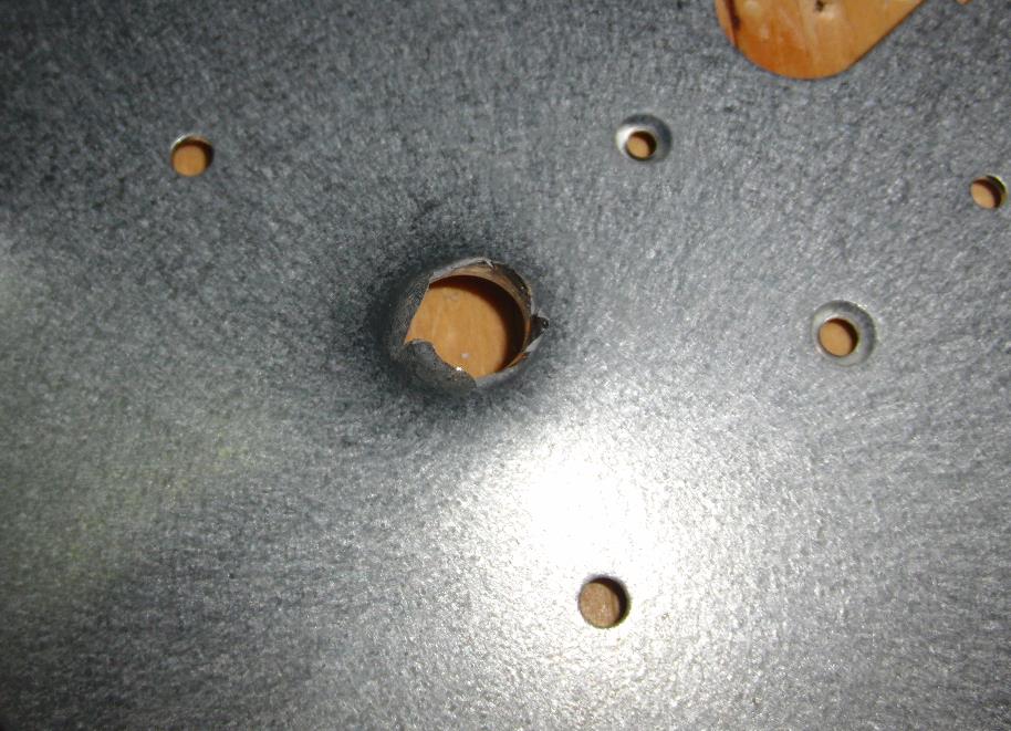

Old modem, projectile loading fail that was not at all good for my hearing :roll: still, pretty cool shot, you can see the glowing fragments of photo paper burst disk hitting the modem:
Same target, projectile loaded this time :) at 9x went straight through the modem and the steel sheet behind it:

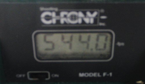

Anyhow, finally decided to take it to 12x - EPIC FAIL :D
The barrel shot out of the suppressor, 30 gram projectile missed the target and slammed directly into the backstop, still haven't found it :roll: still, it managed to register a chrony reading, at 544 feet per second that's a muzzle energy of 304 ft/lbs, by far the most powerful shot I've ever fired from one of my launchers.
