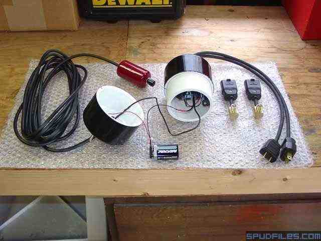

Little bang is a breachloader and has a little 12V chamber fan that I run by use of a 9V battery applied across the fan leads. The most interesting part of Little Bang is its ignition system. It features a 20 foot dual ignition wired remote control. I call the ignition system my "universal" ignition system because I plan to use it on future guns. The heart of the ignition system is an electronic gas grill ignitor module that I purchased from Sears for $16.95 + S&H. After some modest rewiring it provides two 5mm arcs in the chamber - one of which you can see in one of the attached pictures. The remote ignition connects to the gun via two "spark plugs" which I manufactured myself.

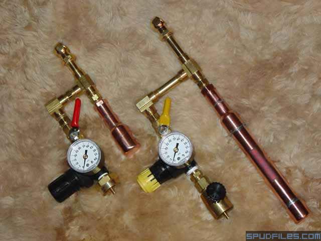

Lastly, as with all my guns, fueling is all off board. I have included pictures of the fuel meters for Little Bang and BigBang III for comparison.

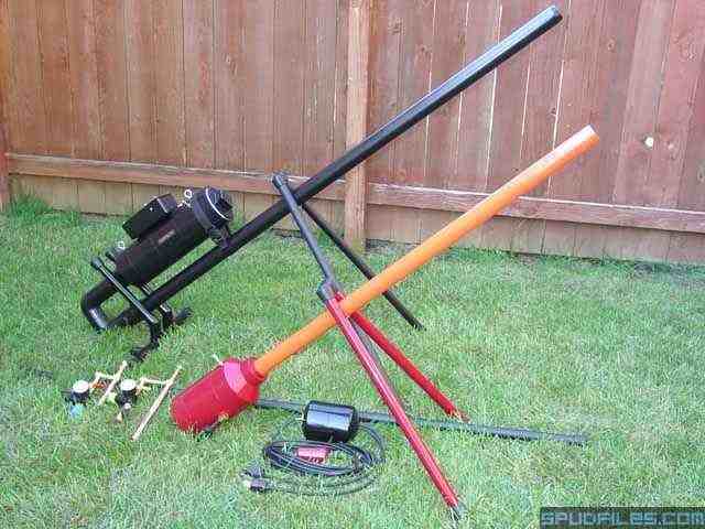

I have also included a picture of the two guns side by side for comparison.
In this picture you can also see the bipods I've made for each gun, and the stand I use to stabilize BigBang III and keep it from tipping over.

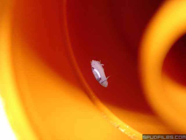

A 5mm spark generated by the ignition system.

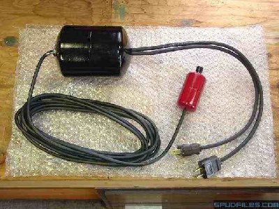

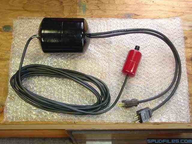

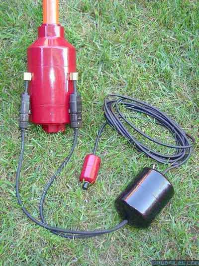

The remote ignition system.

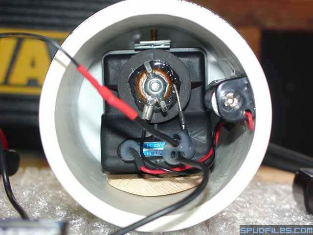

A veiw inside.
A veiw inside.

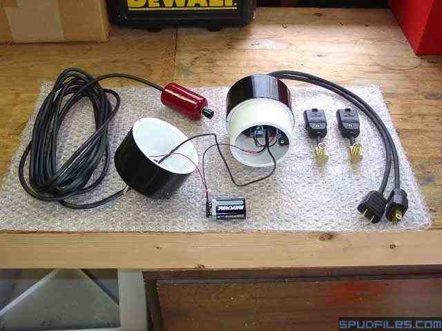

An exploded veiw of the remote ignition's components.

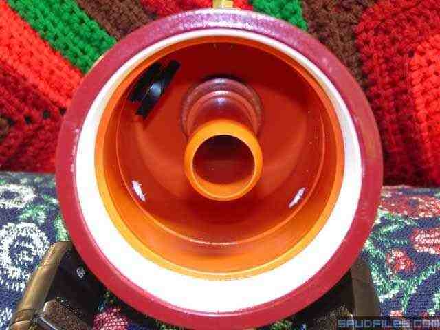

A picture inside little bang's chamber.
Little bang and big bang III.
Little bang's chamber and the remote ignition system.

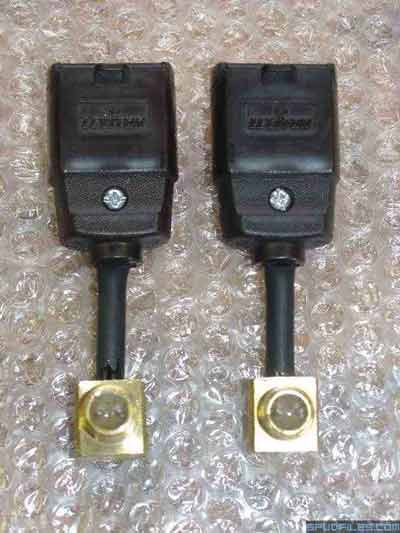

The removable sparkplugs.
The propane meters. The one on the right is featured for comparison; it's used to fuel bigbang III.

I love the metering systems, real nice, I like how the copper is polished and the metering tube is red. :D 8)

Nice cannon man. I like your spark plugs, and the ability to use everyhitng on another gun. Lookig forward to seeing more

i love the idear of the spark plugs,
