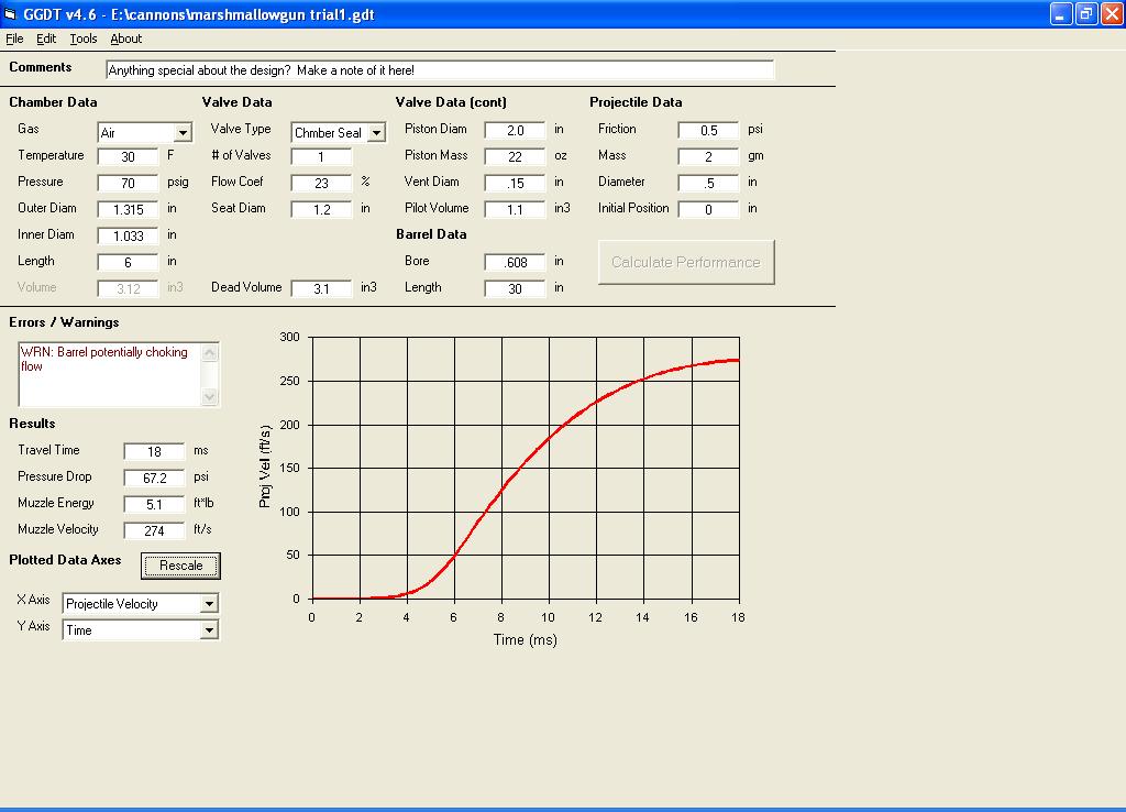

This is the result of a recent attempt of trying to model my next marshmallow gun.
chamber 1x6"
barrel 1/2" PVC-length between 30-36-not yet determined
solenoid controlled 1" sprinkler valve
What does the barrel choking flow output in GGDT mean?
is there anyway the uploader can be changed-PC Guy- to accept gdt files?
GGDT interpret performance?

It means the valve has more flow than the barrel will allow, basically a good thingmetalmeltr wrote:What does the barrel choking flow output in GGDT mean?
Ok what do i have to do to post the GGDT results?

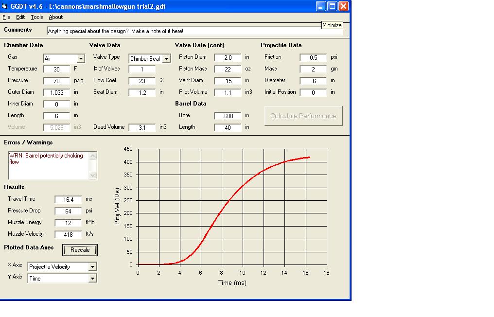

Thanks jack,
I think i figured it out about the same time you replied.
How accurate are these result for using the original solenoid control?
A couple of things to fix:
- unless it's a coaxial, "outer diam" should be the inner diameter of the chamber, and "inner diam" should be zero.
- your projectile diameter is 0.108" less than the barrel inner diameter, is this actually the case? If so, you need a smaller diameter barrel or bigger diameter marshmallows
My recommendation is to download this file and paste it into the root GGDT language folder. When it asks if you want to replace the old one, click yes.jackssmirkingrevenge wrote:unless it's a coaxial, "outer diam" should be the inner diameter of the chamber, and "inner diam" should be zero.
This renames Inner and Outer diameter to less ambiguous names. (And shouldn't break anything if you do it right. If you want to go back to the old version, there's a backup of the normal "Main.txt" file in the English language subfolder.)

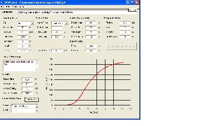

I used to worry about Barrel choking flow until I understood it meant the valve provided very little pressure drop into the barrel. Now most of my launchers provide that error message.
One item to be cautious of is an excessively long barrel. With a long barrel, even though the projectile is still accelerating at the muzzle, the muzzle velocity may be reduced.
When you get the barrel choking the flow error, try plugging in shorter barrels and pay attention to the final velocity, not the fact is is still accelerating as it exits.
I know this is counter intuitive as the natural assumption is to lengthen the barrel so you accelerate the projectile even more before it exits, but this often results in lower overall acceleration and a lower muzzle velocity.
I found this to be the case when we built the competition t shirt cannon. We started with a long barrel and trimmed shorter, and as we did, the muzzle velocity increased.
In your posted trace of GGDT, you have a large drop in acceleration near the muzzle. Try a shorter barrel and see if the muzzle velocity increases. Another suggestion is to go for a larger diameter chamber. Getting marshmallows well over 800 FPS is possible. I dented a car door with a marshmallow.
When properly trimmed, the projectile will show good acceleration for most of the barrel travel and a gentle roll off near the muzzle.

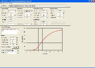

We trimmed a barrel for a 4 inch foam ball launch. This is a test shot at 60 PSI. At the 100 PSI regulation limit there was less drop off in acceleration.
GGDT for the above launch. The barrel is still a little long, but that was kept as a compromise for launching projectiles heaver than a foam ball.
I tweaked the GGDT valve details to match the actual measured performance. This is how I found the valve efficiency.

thats what that means? ok i always wondered why the outer diamiter even matteredjackssmirkingrevenge wrote:A couple of things to fix:
.5 is an estimate
Edit If the marshmallows fit tighter in the barrel we could have much faster muzzle velocities-no real suprize but they are significant gains.

Why...
1.) The ridiculously small C:B ratio?
2.) Is your piston mass entered as 22 oz. ?

http://www.thehalls-in-bfe.com/GGDT/index.htmlomniscient wrote:Why...
I used this to model the valve
i now see it said 22 gms not ozs

I believe in GGDT you can set the graph's x-axis to be the ammo's position in the barrel then set the y-axis to velocity. Give GGDT a barrel longer than you think you need and it should give your a decent prediction of the barrel length versus performance trade-off.

Well I'm designing for two factors
Tacticallity-apparently thats not a word- basically a short gun for easy maneuvering-room clearing
Pneumatic performance-less important with short ranges and light projectiles
Just looked at last GGDT run-wont work for me-40" barrel-looking at about 25"
