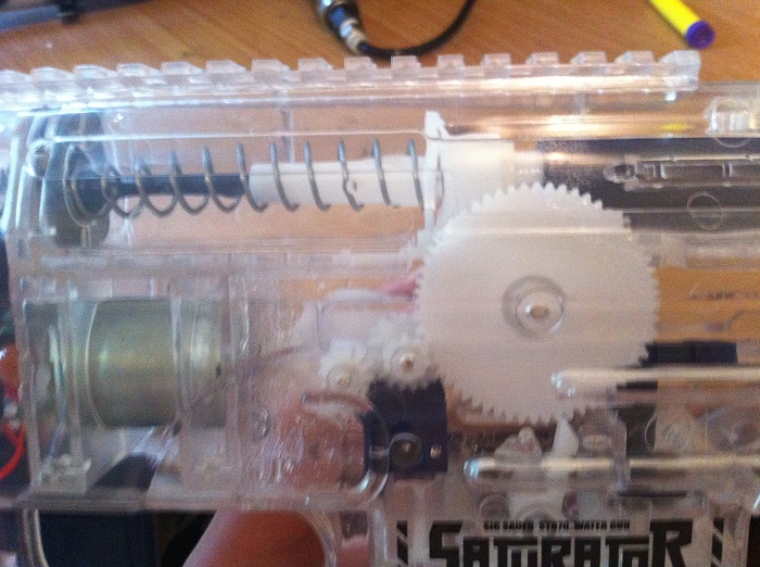

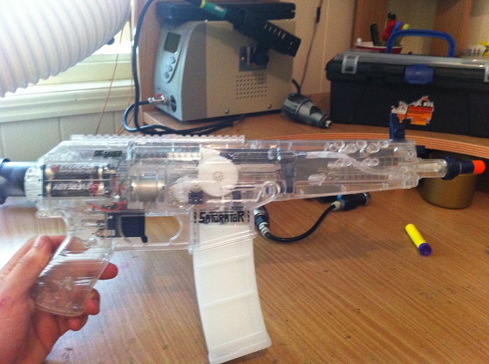

It has a lot of potential I think, the insides are very much like those of an AEG..
I'll probably put in a much stronger motor, run it off a lipo battery, put a bigger plunger and piston setup, and setup a T-feed mag for BB's..
If its successful I'll do a whole writeup and such.. But for now its open for you all to discuss and hurl ideas at me :)

Sure will.. I'd be happy if it had the same power as my nerf maverick that I converted to a BB gun. The biggest problem I can see so far, it the length of the draw back the stock gearing provides. It's probably about 1/2 the draw back the nerf gun takes to cock, so I'm sceptical that this will be a large enough volume.
