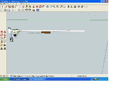

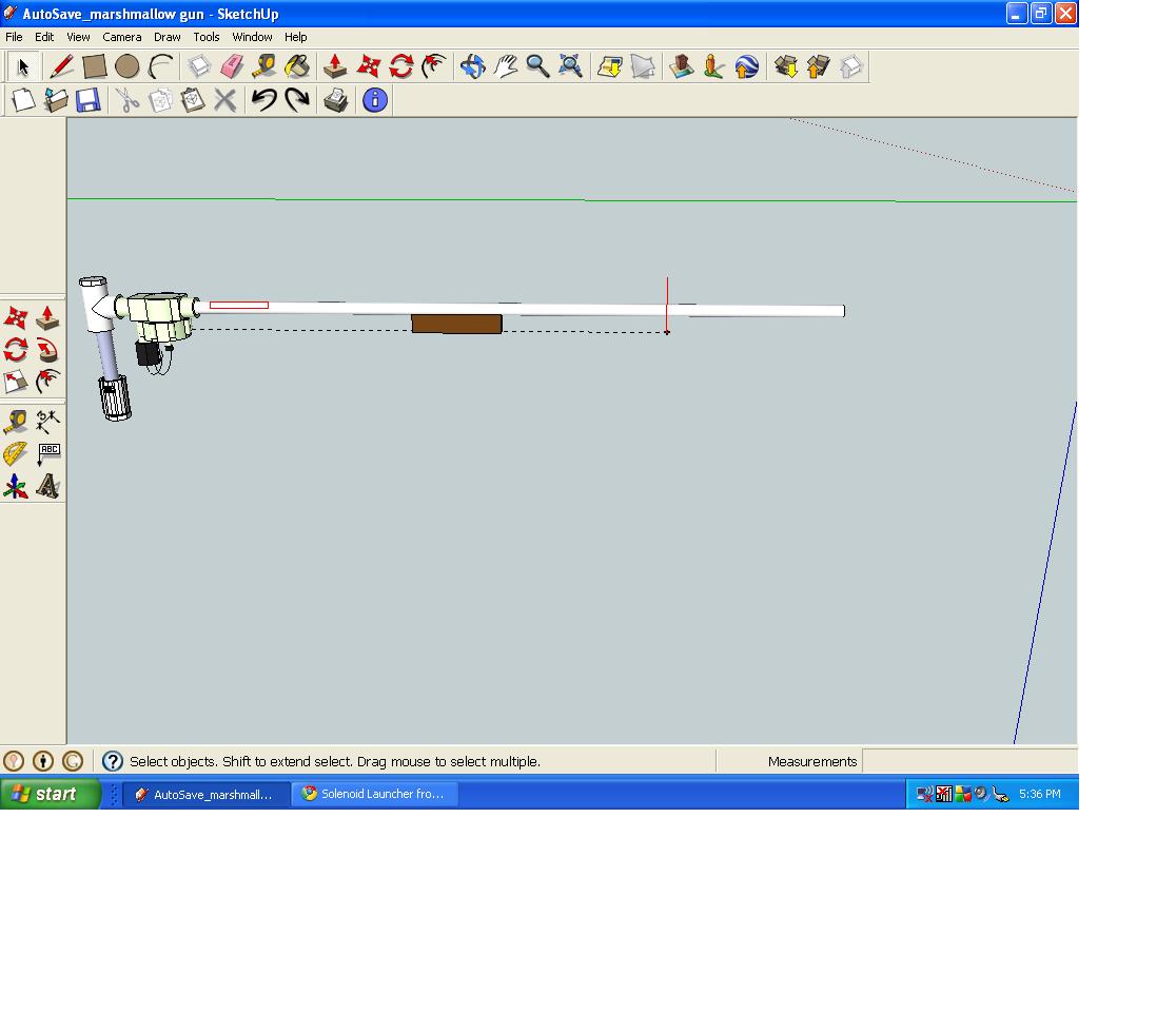

I am new to sketchup as of last night. Using model in the 3d warehouse i have partially modelled my newest creation. i am now having difficulties with sketchup.
Edit-sorry about small picture, it's understandable in full screen under zoom.

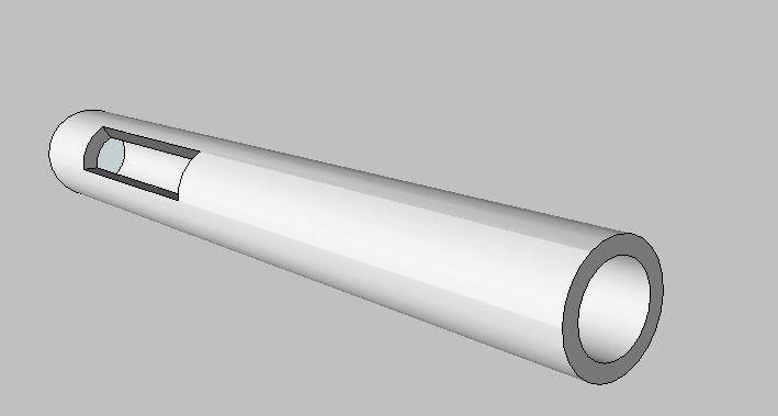

The "rectangle" ; Did you want to create a groove in it, similar to this?

I used a drill press to drill a series of holes lengthwise the pipe. I used a hacksaw go do the cuts cross the pipe. Then the sections were lifted out and then filed smooth.
I photo documented a larger cannon. The small one was made the exact same way.

Look a few posts down, I cover how to remove sections from curved surfaces by intersection + deleting, with a vortex block as an example. Ask here again if you need more help.
