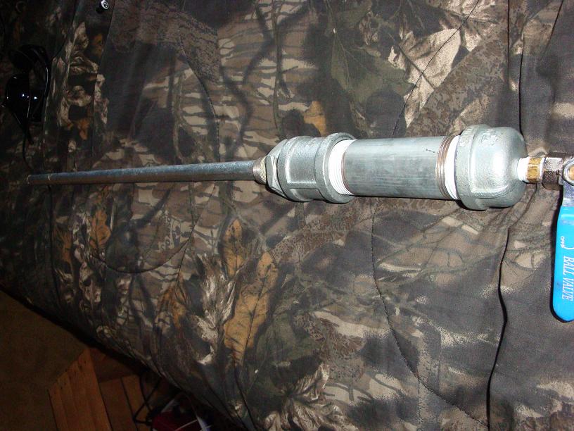

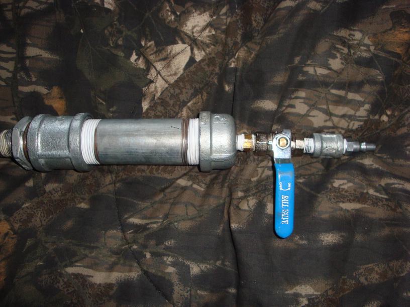

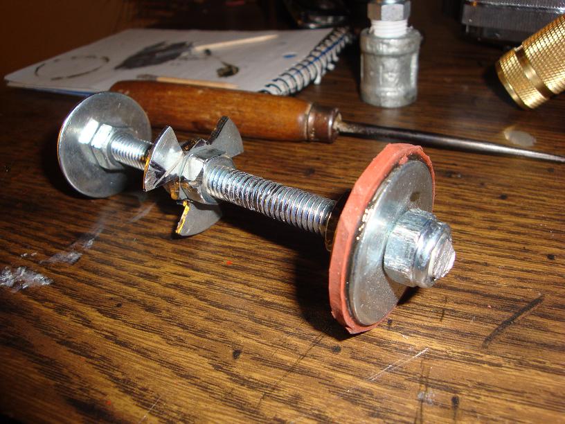

Hey all-- Finished up my toolies valve today so i thought I'd share.
The valve is housed in a 1.25" steel nipple, five inches long. The ID is 1.35". The barrel has an ID of .6" and OD of around .7". It's 24" long. I'm hoping to upgrade it with a longer barrel soon.
Obviously it cant be very accurate now. I have to head back to school in two days unfortunately so I can't continue work on it, but I do have some plans in mind for it. I plan on making a wooden stock to embed this in, and tear apart a Nerf Maverick to add a revolving cylinder to it- similar to many of the guns found in Borderlands.

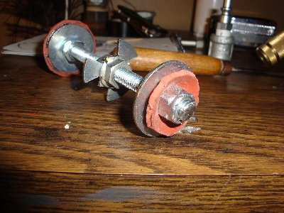

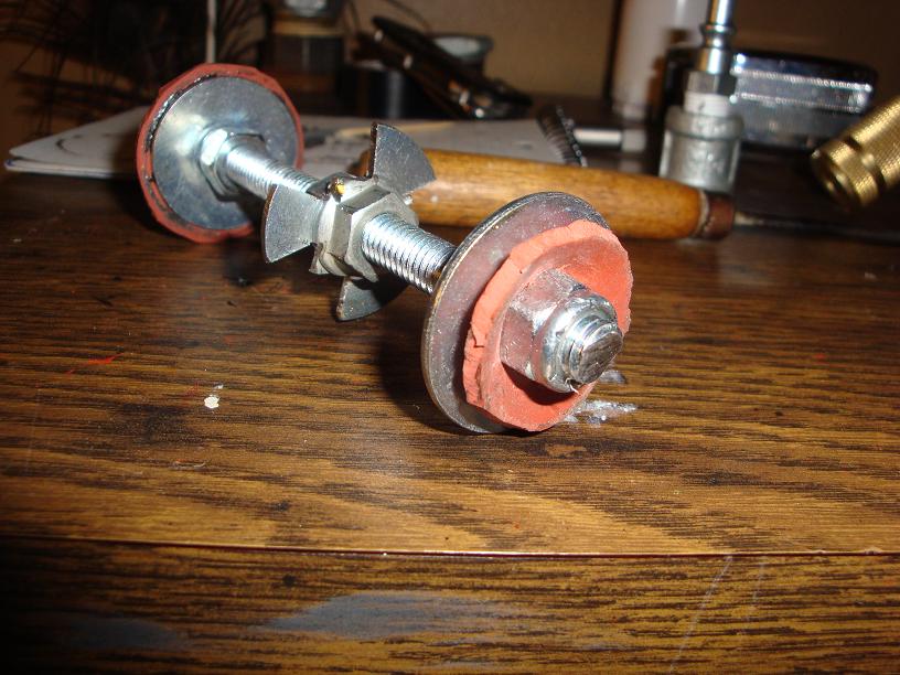

The rear seal is just a rubber gasket sandwiched between two washers. I was worried it wouldnt seal, but it does so perfectly, which was a welcome surprise.
Haven't actually shot it yet, as I have to finish leak testing and whatnot, but it does fire and opens quite well it seems.
Enjoy! Hopin to be able to upgrade it when I come back home in March, but until then its just going to have to sit.
EDIT: Forgot to add this will be used with high pressure CO2 eventually. Right now just testing at 110 PSI from my compressor to save CO2

Never got a piston made that way to work :?

yea, i was pleasantly surprised when it did work. I've typically had lots of problems with piston valves in the past, but this one just went right.

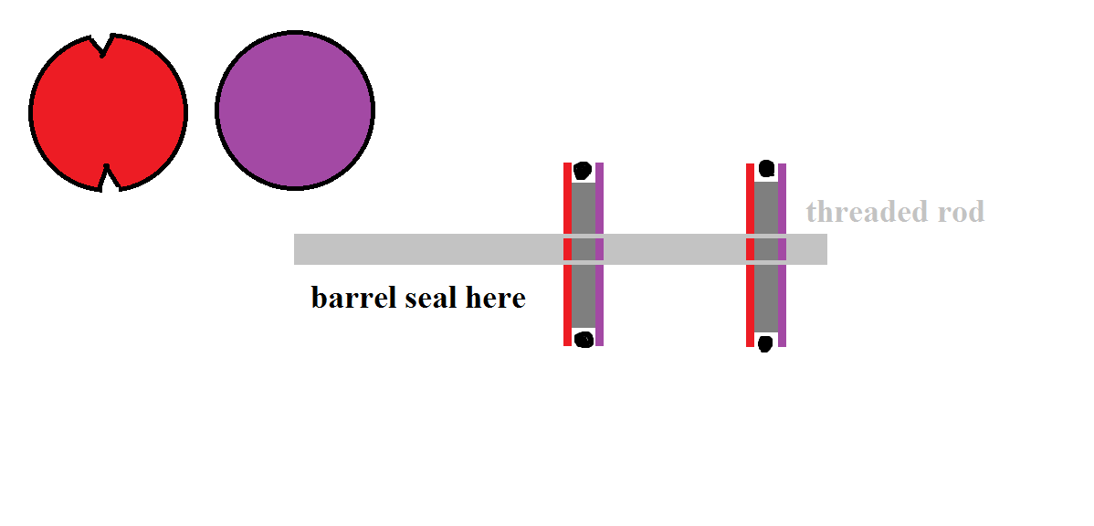

Very nice. Have you considered a washer for the front seal to hold the rubber flat?
If you have a drill press the rear seal can be turned for a better seal instead of having the chopped edge.
You can see what a turned seal with a washer looks like in this photo. The seal for the center piston was cut from a sheet of rubber.

Yea I realize the sealing face is not flat. That is a result of me just over tightening the nuts that hold it in place. There isn't really room for a washer since the nut fits inside the barrel pretty much perfectly. I could back off the tension so the seal face is flat, but for now its working.
Yea, i have a drill press, and could have done that. i used the circle cutter attachment for a dremel to cut it. It is a little rough, but through some lubricant and adjusting the width of the rear washer through tightening the nuts i am able to get a good seal. From what i can tell, it's a 100% seal. I was actually worried it wouldn't fill the chamber, but it still does.
Right now I'm happy with the way its working, if further tests reveal its unsatisfactory I'll adjust it.

Yea.... well on a whim i decided I wanted a grenade launcher, so i chopped the barrel off and am putting a 1.5" PVC. If I wanted to I can make another barrel for it relatively easily, just by gluin another piece of conduit in a 3/4" nipple, and viola, new barrel :D

The back gasket needs to seal a little bit. You have to be able to get air into the chamber, but you need it to seal good enough so that when you exhaust the pilot volume, the air in the chamber simply doesn't exhaust out of the pilot valve.

Vincenzo
Posts: 58
Joined: Mon Dec 06, 2010 6:50 pm
You should have made a floating o-ring design then. Something like this:

Yea. Unfortunately i couldn't find o-rings in the right diameter. I tried to do o-rings it just didn't work with ones I had available.
This works for now. I'm fine with it so far.

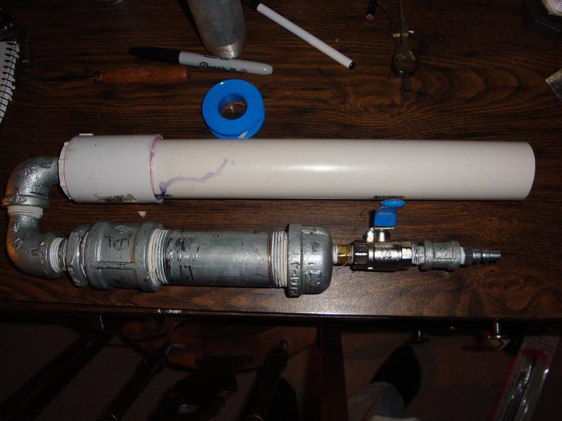

alright, sorry for the double post, but slight update.
This will be the "final" configuration of the gun. The barrel right now is 1.5", but it will probably be downgraded to 1.25" as that gives better performance according to GGDT. I plan on housing it in a configuration similar to the HK69-- http://world.guns.ru/grenade/de/hk69-e.html
Will also be adding a break barrel. unfortunately I'm back at school now, so I wont be able to work on it for a couple of months.
