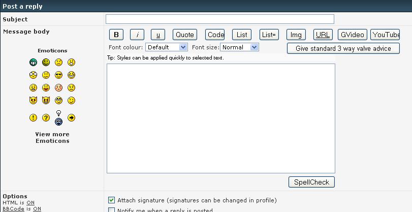

@JSR Hey... its a valid button... But you seem to have forgotten to "program" a standard "epoxy advice" button...

ThornsofTime wrote:@JSR Hey... its a valid button... But you seem to have forgotten to "program" a standard "epoxy advice" button...
Fine, in the interest of balance:
you forgot about random innuendo and APFSDS rounds are so fuc#### awesome (let me post another pic of them) buttons :wink:
anyway you're just jealous...
you could have realized that 3 way valves are the way to go...
and now you're like 'uhhhh......... 3 way valves $#$#$'
...retards
JK
:D
[/offtopic]
