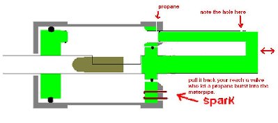

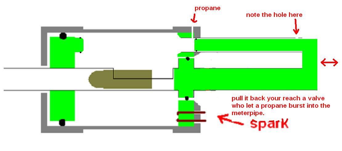

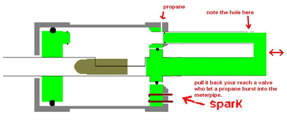

hi here a diagram of a working micro repeater. add magazine and push button fuel so the pump-action is easy to archive.
easy to build
by me it works with 8mm barrel and syringe fueling power is bad by the small barrel diameter but in 1inch size it will work fine.
i hope you get the diagram
green is epoxy and grey are pvc with two endcaps

jean- very nice layout. I like it a lot. I may do a similar variant sometime.
Edit 6/8: After giving some thought to jean's design, I realized how much could be gained from doing away with the pop-off valve. I may just take it out and load the projectile into the piston rather than the barrel. This way I can get full flow-through, prevent diffusion, and the check valve still serves a purpose.

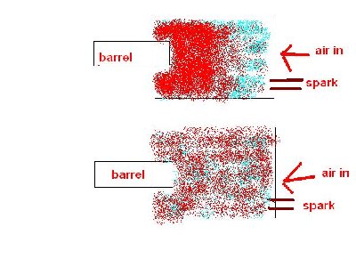

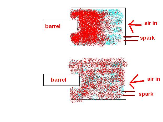

mh i think it is to much fuel
if the air comes in- the mix near the spark is right and if it sit down the fuel mix over time with the air and the combustion is weak.
try it with less fuel and let ist sit down for a minute or so.
first is what i mean with the fuel
second pic for a fuelmeter to mixing fine

Interesting thoughts, I was wondering if something like that was taking place. The problem seems to have gone away after I lubricated the combustion chamber so the o-ring makes a better seal. There might have been a leak after all.
My DCV metering system is also very consistent; I'll keep that the way it is.
