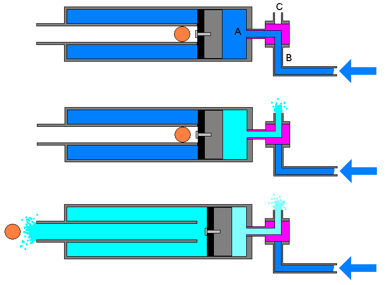

that's how 3ways work, the pilot there is a slide valve but any kind of 3way will work exactly how you want it.
Think of it this way:evilvet wrote:Can a 3 way do that ?
And so on and so forth
A three way valve has three ports, which we will call A, B and C
There are two possible paths, AB (with C blocked off) and AC (with B blocked off)
A is connected to the pilot area of the piston
B is connected to your 100 litre tank
C is simply left open to the atmosphere.
At rest, the three way is in position AB. This means your reservoir is filling the launcher chamber.
When the trigger is pulled, the valve switches to position AC. This means the reservoir is blocked off, and is no longer filling the pilot and chamber, while the pilot is exhausted to the atmosphere, which fires the launcher.
Once the trigger is released, the valve goes back to AB, refilles the pilot and chamber and the cycle can be repeated.
Hope this is clear enough
I'm sure I've done worse but glad it's appreciatedthat little bit of PaintShop is quite probably the sickest, most twisted, evil disgusting and downright funny things you have ever posted.
- 3wayvalvediagram.png (5.97 KiB) Viewed 1795 times
