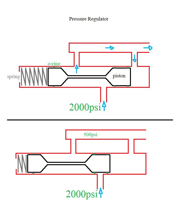

Hello to all, i was thinking to use co2 with a pressure regulator, but i can only find 1300 to 100 psi to buy. I would like to use 500... hehe... i never worked with these hi pressures, so maybe my question is stupid... but is it possible, (safe) to build this? the o-ring can handle the pressure? will i die if i try? hehe..
--- supose the piston diameter and the spring tension is calculated so that when the chamber reaches 500 psi the piston moves to that position...

Derp. Missed part of the drawing there.
I do believe that will work if you can manage to calibrate the spring. Just be sure all the parts you're working with are up to the challenge. Personally though, I'd just keep searching for a suitable reg or build and HPA setup.

I agree with sae. I wouldn't trust a homemade reg at this pressure. Search Palmer pursuit.

Thaks for the reply. I think i ll study some hybrid designs;
