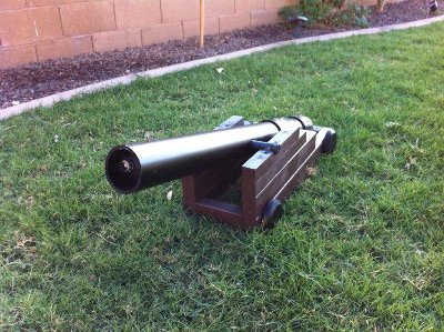

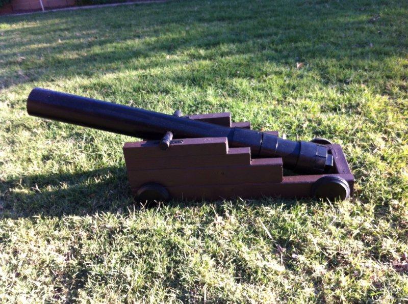

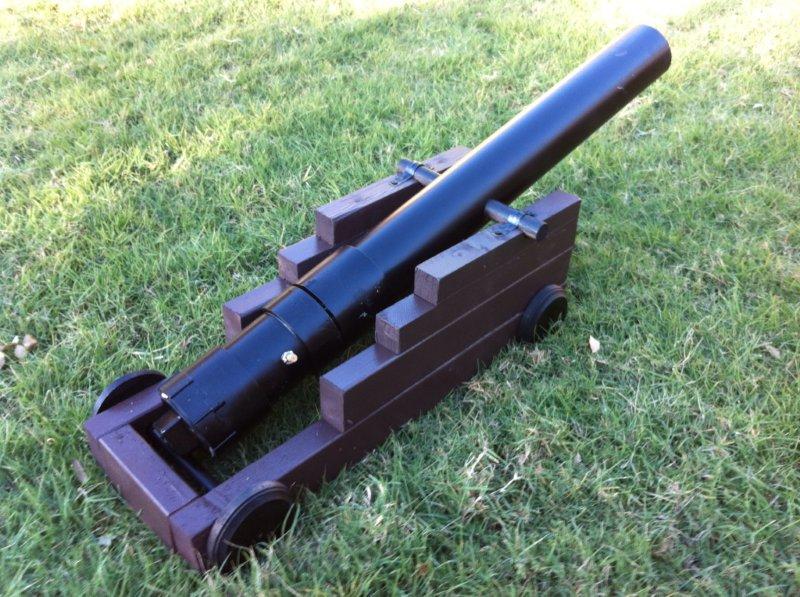

So my nephew got a little toy potato pop gun. He loves it. For his birthday, my wife asked me if I could upsize it into a potato gun. He is a big fan of pirates, so I thought I'd theme it. Well, the project got a little more... complicated than I first thought. But the end result was better than I had hoped. Its only my second potato gun, but the first was a LONG time ago.
Let me know what you think,
Jeff

hehe brilliant, you have one lucky nephew!
You know, it would have been much easier to make it full bore... then again, you don't want footballs through the neighbour's windows either ;)

OK - my nephew is WAY too young to play with it by himself, so his dad really is the one who gets to fire it.

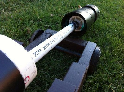

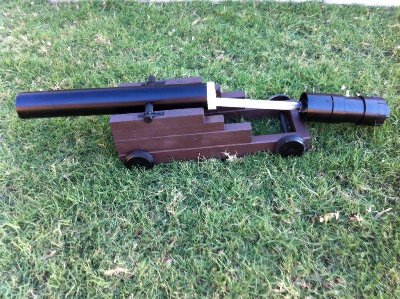

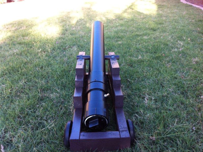

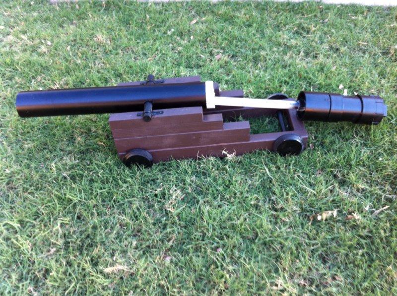

This cannon has a 3in combustion chamber that goes to a 3/4" barrel. It was build using Mini T-Rex plans over at AdvancedSpuds.com as a starting point.
I'm using lantern flint sparker as the ignition source.

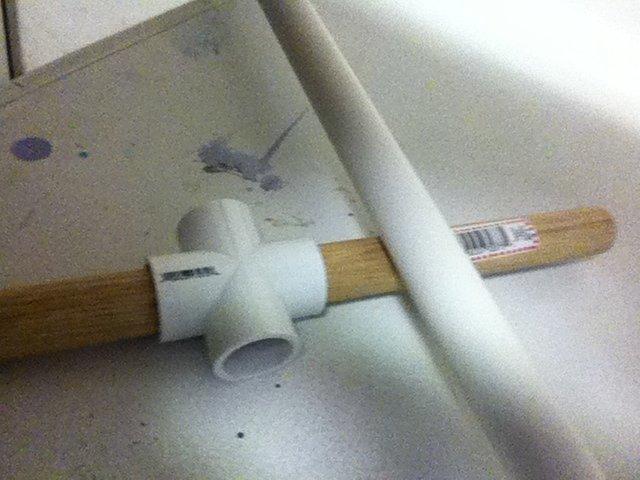

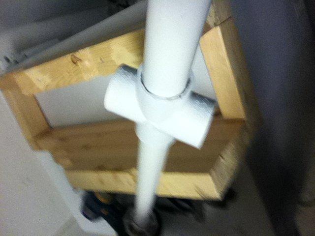

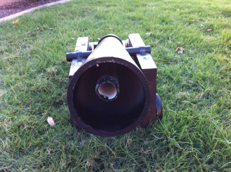

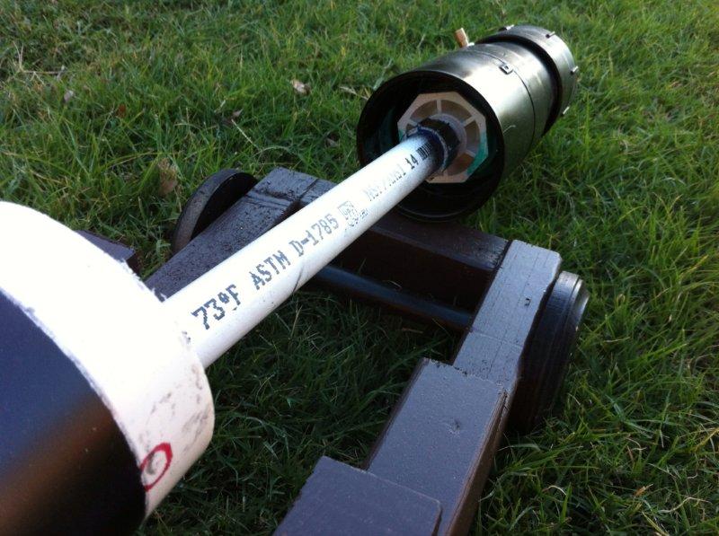

After building the cannon close to a Mini T-Rex, I just pvc welded the 3" coupler right on top of the reduction piece. This allows my to fit it to the back of a 3" cannon to match the combustion chamber. The trick was how to get the 3/4" barrel through the center of the 3" outter barrel when there is a 3/4" wood dowel going through it to support the cannon on the base. This required a 3/4" "T". I dremelled the inside of the "T" out enough to pass the 3/4" internal barrel through it cleanly. I then cut the dowel into two, and screwed it to the inside of the other path of the "T". Attached a picture to give a better idea.
Kids LOVE it. Makes a nice big boom. :D
