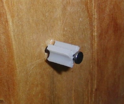

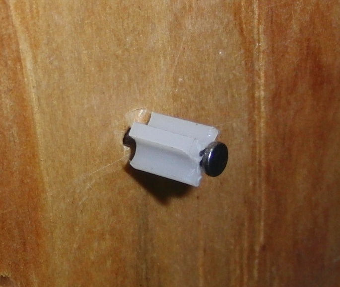

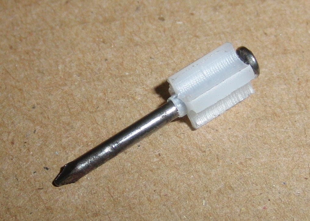

I've been having a play with milled collars to turn small masonry nails into stable darts without any modification of the nail itself. In 6mm calibre, a simple airsoft BB serves as a sabot.
Some test firing at 15 metres shows that the projectile is stable and even fired from a low powered small 300 psi pneumatic, can still poke out of the far side of a 3/8" sheet of plywood.

You could quite easily make a mold tool for these. Two machined brass blocks with 4 pins through them and two brass bits to close it off. I'll make a CAD model.

Indoors or not, these will shatter on impact fired from a reasonably performing launcher so they are single use anyway.al-xg wrote:Aren't you going to regret that ?Unless someone is shooting indoors they're probably going to need a fair quantity of these.
My idea though is not to make an "everyday" projectile but to have something in limited runs for those who want to edge out the performance of their launchers.
This is basically what I'm talking about:
A launcher that could only dent the surface of the target with a fullbore lead projectile at point blank range easily penetrated with a saboted dart.

Some footage from behind a 0.4mm thick steel sheet target:
First shot is a 1 gram lead pellet, second is a 0.67 gram nail dart.
Nail weighs 0.56g, fins weigh 0.11g, centre of gravity is 14mm from the nose, calculated centre of pressure is 15mm from the nose (25mm overall length)

Thanks for the plug. In thinking about your fins, you have a milling machine I believe. If you can stand the material on end with maybe a 3 jaw chuck mounted in a rotary table, you could machine these fins with a long small diameter end mill. You can deviate away from the shape a ball end mill creates.
Lest you inject them under pressure, the mold will be a bit difficult to fill.
@al-xg, Nice rendering. Great design, hard to get tapered leading edges on the fins with that. Mike builds 4 sided molds that are locked together to create similar parts.
