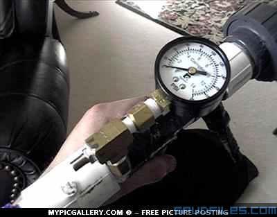

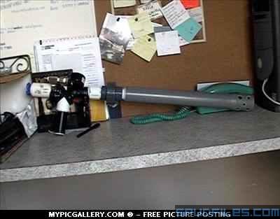

I dont know if anybody has plans for a supersmall hybrid, but I sure do, and it is about halfway done. With a mostrous chamber volume of 6 CI, this thing is probably the smallest gun I have ever made compared to its power.
Specs:
6 CI CV
1" sch80 union
6" peice of 1" pressure rated pipe, rated to 600 psi
propane injected (also probably the smallest of it type)

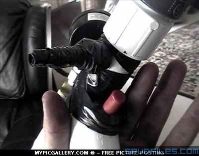

BBQ' igniter, with a 127cc 3HP Briggs/Stratton spark plug located three fourths of the way up the chamber, on the bottom, like a grip.
schrader fill system
This gun is going to be very unique; the fuel meter is most likely the first of its kind, in size and function. It consists of a 1" long 1/8" pipe nipple with a schrader valve on one end, and a 1/8" ball valve on the other. after the ball valve is a 1/8" tee, one side connected to the ball valve, another to the gun, and the last side to a miniature pressure gauge. To fill it I will adapt my propane hose to fit a schrader fill valve for a compressor, so I can inject fuel into the meter quickly and easily, then I just open the ball valve to vent the propane into the chamber. to fill the gun with compressed air, I will add a schrader to the back of the gun, threaded into the 1" npt plug in the back. This design eliminates the need for two ball valse, and having to keep the propane on the gun. It can be set down or carried in a large pocket or backpack
It has a pistol grip made of a 1" tee cut lengthwise, like on Latke's and Mr. Plow's guns, with the BBQ' igniter sandwiched between the gun and the tee. Keeping the minimum amount of holes in the gun at 2, one for the sparkplug, and the other for the meter (of course this is not counting for the hole in the 1" plug in the back, but technically is not "part" of the gun, just an attachment). I am not going to drill or hoseclamp anything down, I am using electrical tape, for both ease of removability and low cost. Mainly everything but the fuel meter and shrader valve are installed and ready, I just need to get to parts tomorow for it, and as soon as that happens, its gonna' be a rockin'! This has proven quite a cheap hybrid, I am very surprised. total cost, not counting propane tank, torch head, and air chuck, is about $40, an all time low for fuel injected hybrids.
Give me some feedback about how you like the design, and feel free to ask any question you feel the need to ask.

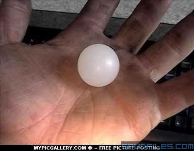

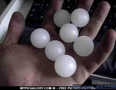

what are the balls you're holding in your hand? the hybrid concept is most intriguing

whisper13 wrote:what are the balls you're holding in your hand? the hybrid concept is most intriguing
I think that they're 1in polypropelyne balls that you can get off of McMaster-Carr. Although I could be wrong......
iamthewalrus
Posts: 559
Location: Iowa (SO BORING!!)
could they be ping-pong balls or are they to small?
drac
Posts: 899
Location: Avon, NY
Its possible. I personally have never held or seen a ping pong ball in person, so it's definitely possible. In a post on the spudtech forums, he said that he broke the sound barrier using polypropelyne balls.
spudshot
Posts: 1036
i thought he did that with his large hybrid, the one that has the shopping cart turret, something like a 5x mix, and it wasnt polypropolene balls, he did it with lead shotgun slugs didnt he?

drac
Posts: 899
Location: Avon, NY
"4bar/4x mixtures. Those (heheh) "pellets" are 425 grain 12gauge shotgun slugs. Those werent what I was shooting though (though I have broken the sound barrier with them before), I was shooting 1" diameter polypropylene plastic balls, ordered from McMaster, I dont remember the part number."

CS
Posts: 1837
Location: Southern Utah
Drac i wouldnt belive him saying that those little plastic balls broke the sound barrier. They might of shot fast but if they went that fast they would be tore apart before they reach the speed to break the sound barrier. I think he proably did it with the lead shots which im not to sure of because thats extremely fast for any object. How would he know that he broke the sound barrier?
drac
Posts: 899
Location: Avon, NY
Nope, read his posts in the link that I put. They were 1in polypropelyne balls.
Chronograph Shot: http://supersonicshots.mypicgallery.com/Route.asp
I recall having fired a shot at a 5bar/5x mixture to 1550+ fps, but I forgot to take a pic of the chrony (you get a tad excited when you've broken the sound barrier with parts bought from a hardware store, and a few things slip by).
The shotgun slugs were mean suckers at mach1+ velocities, they really toasted whatever they hit. I nailed a 4x4 with one, it was pressure treated, just blew the insides out, and split the board down the middle. I didnt get them over 1200FPS though sadly, they just weigh too much.
IM telling you, check the link I posted and read all of spudinator's posts. If you don't belive me, email him: spudinator@gmail.com

cool design but how is the fuel measerred
drac
Posts: 899
Location: Avon, NY
Read, people, read. :evil:
