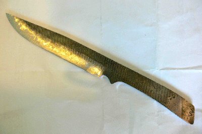

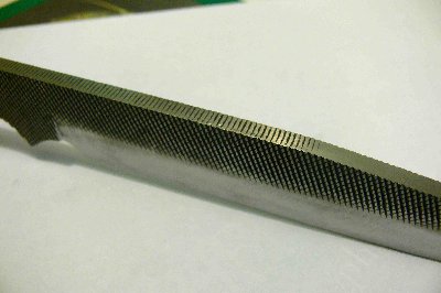

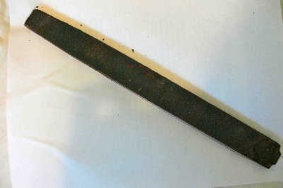

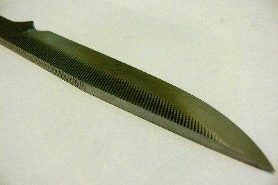

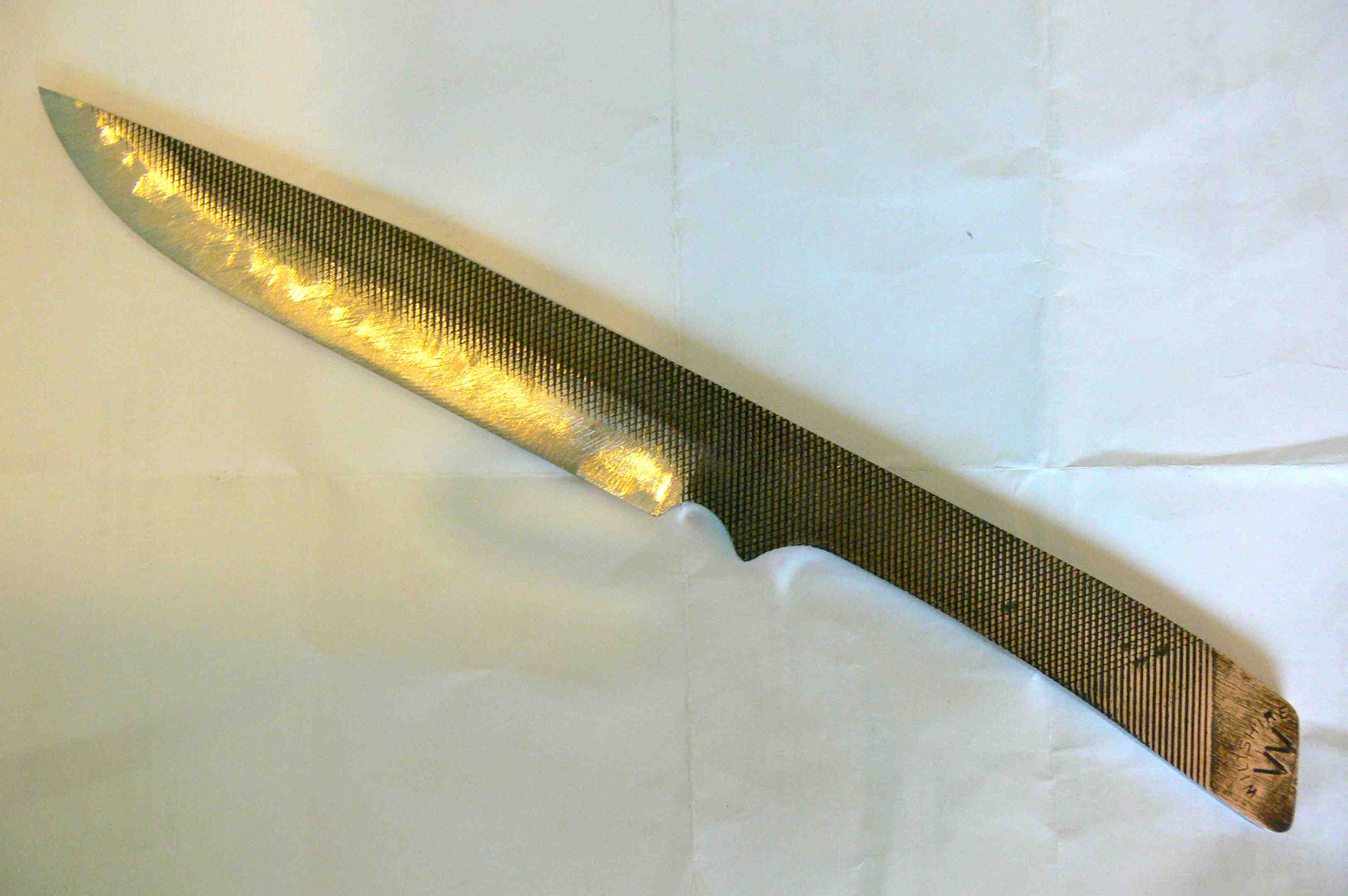

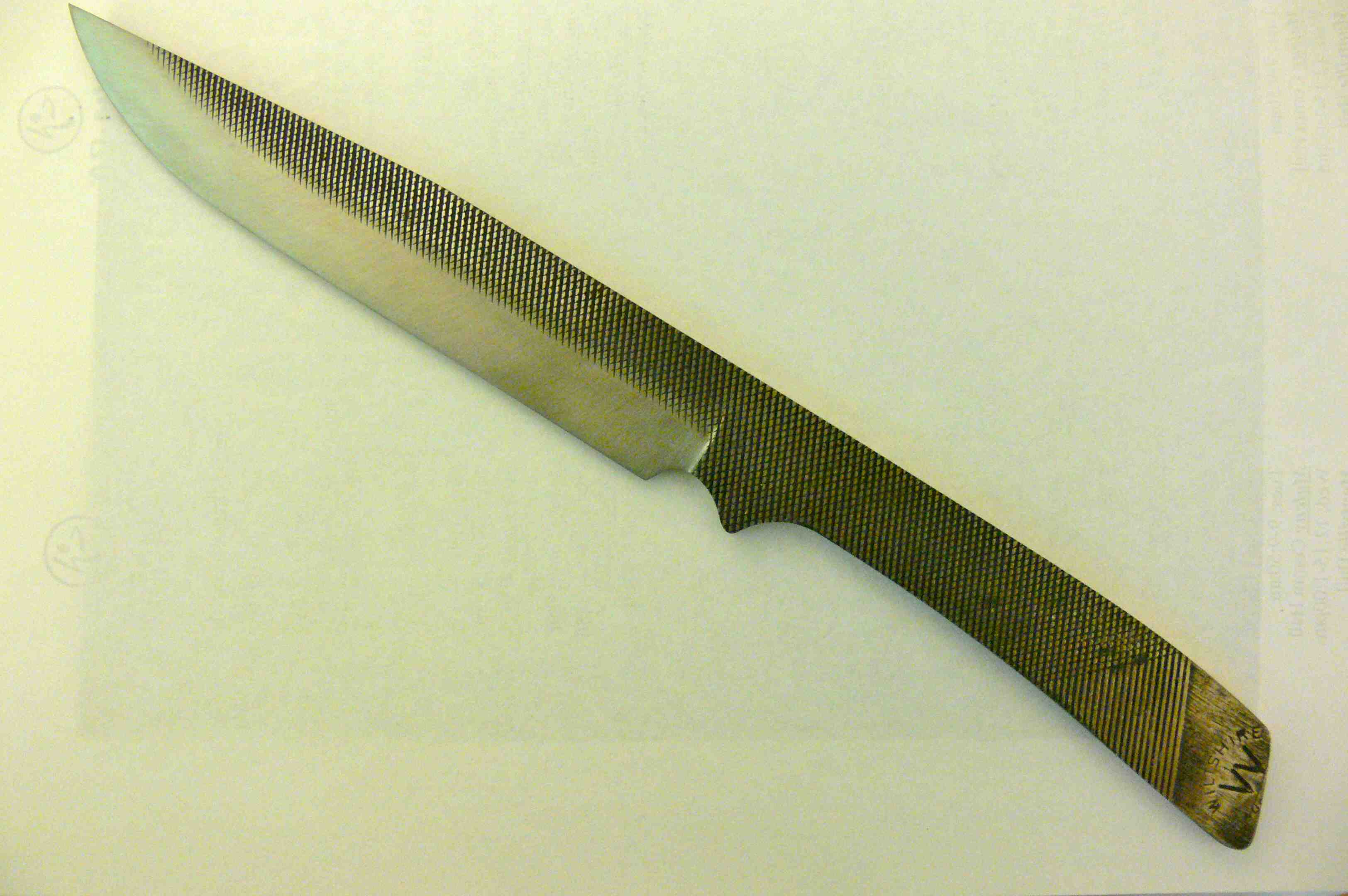

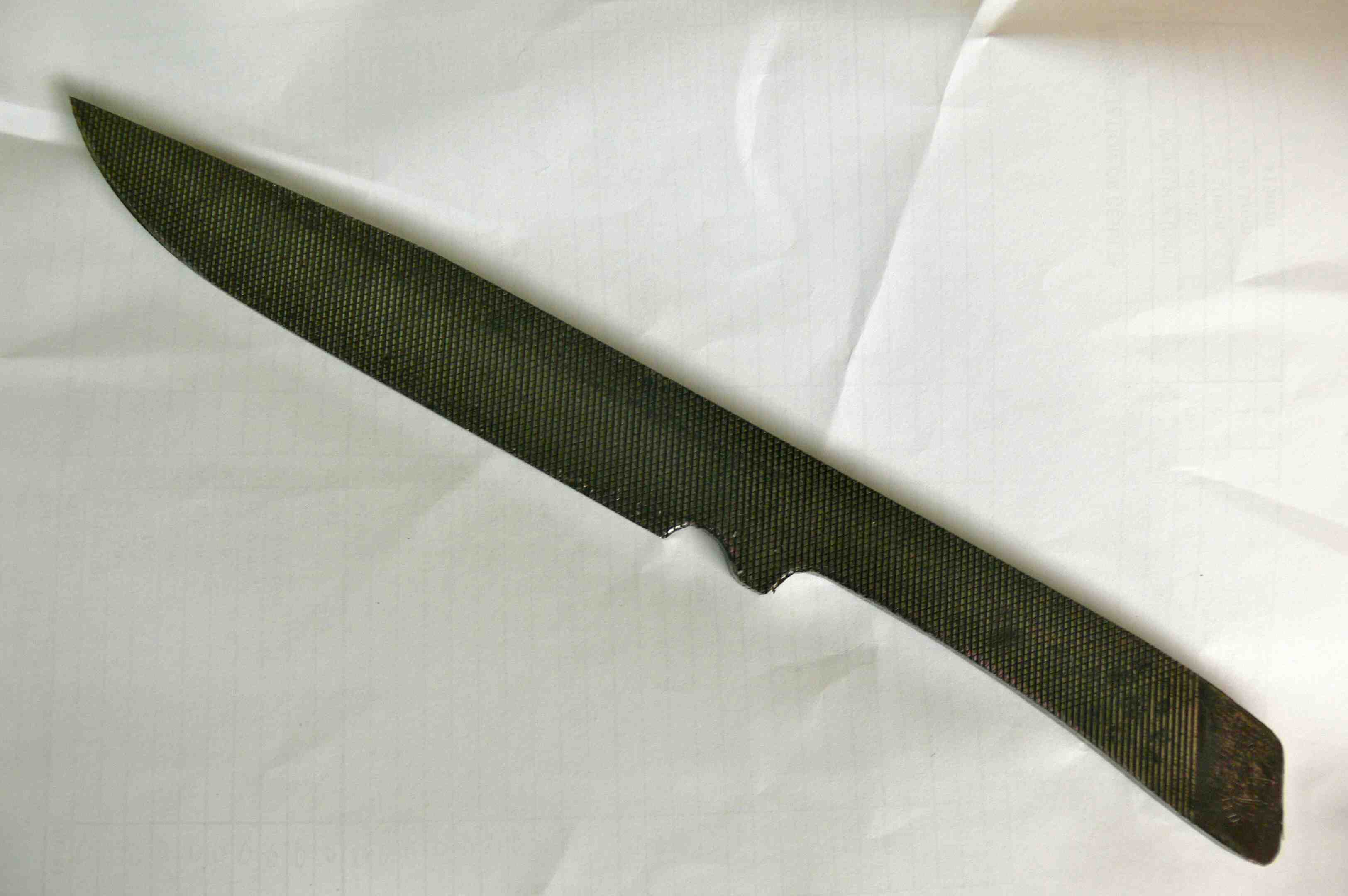

just thought i would show you what i have done so far on my knife that iv started making out of a file
not going to go into much detail just yet, if you have any questions/tips i would love to hear them, anyways here are some pictures of it so far
Edit: or going by the order of the photos, this is how i made a file out of a knife -_-
how it started
how it started
after softening in the furnace
the design
the design
roughly cut out
roughly cut out
edges smoothed and blade starting to be made

looks bloody great man, what did you use to use to grind the blade?
the file pattern make it look like carbon fibre.

ilovefire wrote:just thought i would show you what i have done so far on my knife that iv started making out of a file
That looks *really* good!
I hope you leave the original file markings, it's a brilliant effect!

Crna Legija wrote:looks bloody great man, what did you use to use to grind the blade?
cheers, so far iv just been using an angle grinder, but theres still a lot to go and am thinking i might try a belt sander to get it nice and even

jackssmirkingrevenge wrote:That looks *really* good!
thanks, and yes, i will be leaving the markings, and have even got some of them on the back of the blade

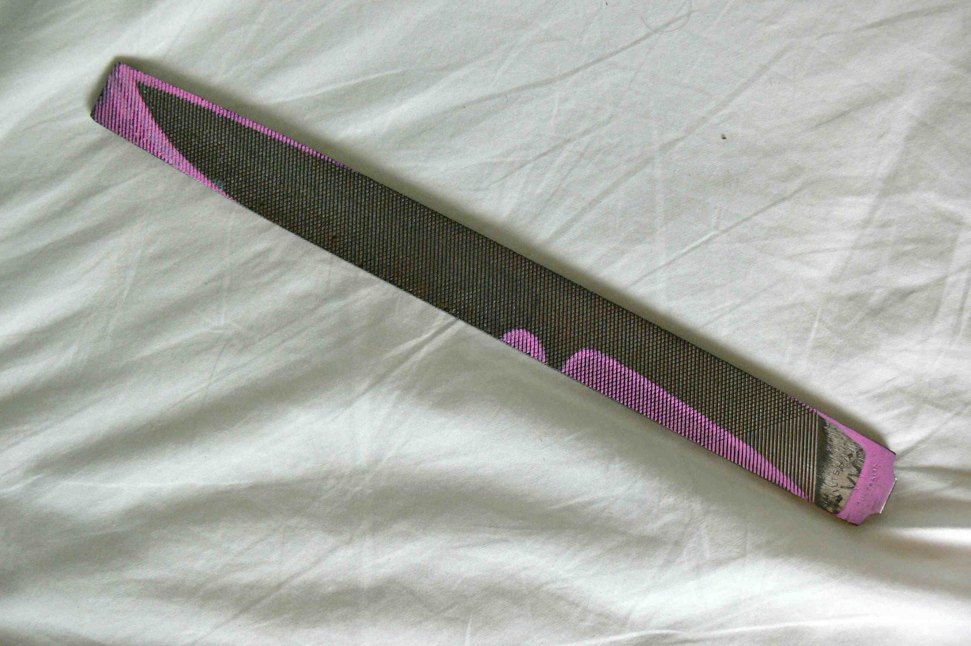

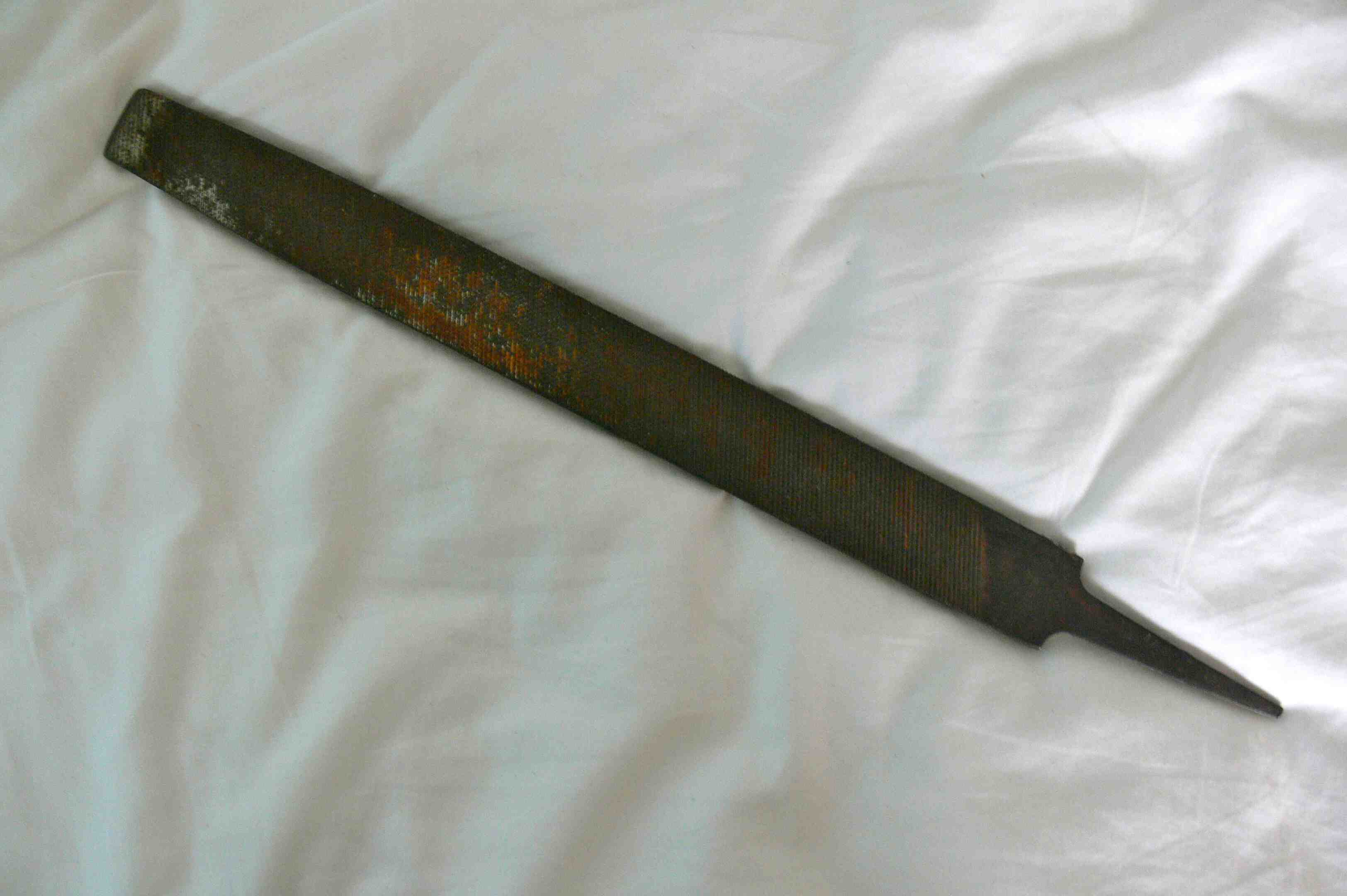

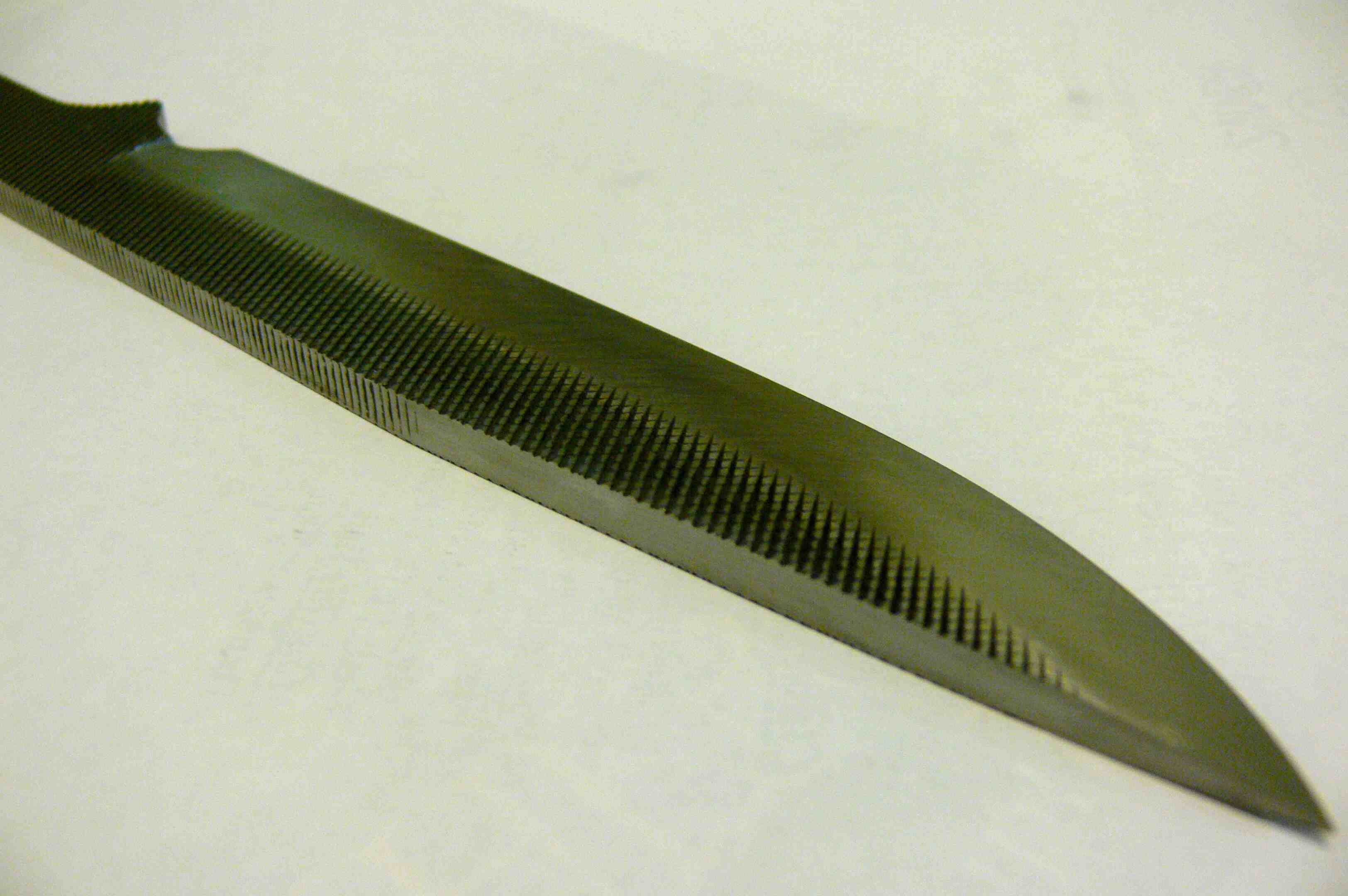

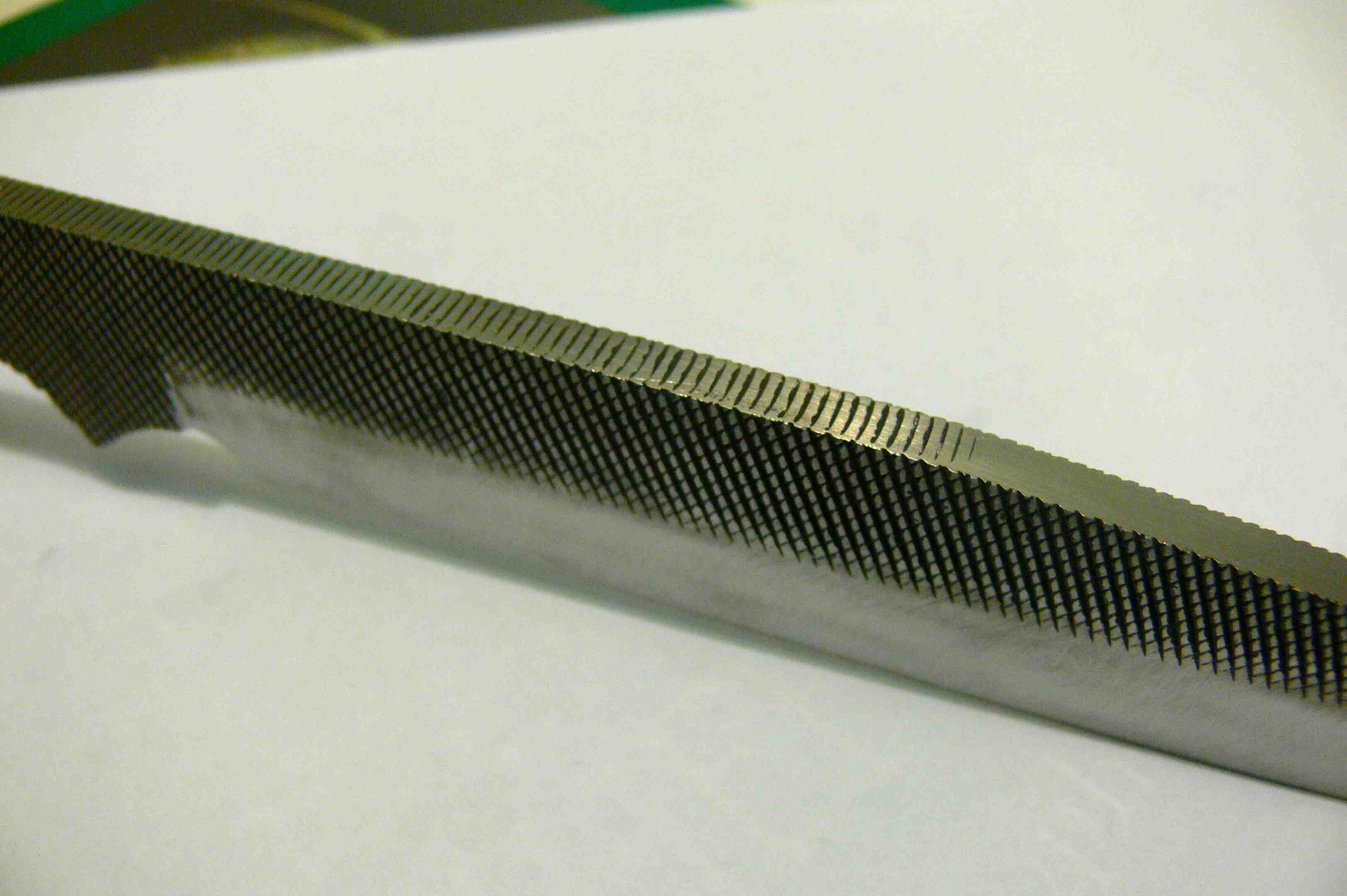

i have pretty much got it ready for heat treating now, just have to drill some holes inn the handle for the rivets that will hold the grips on.
dosent really look much different but i still got a couple more photos for you's

that look awesome really top notch work.
drilling holes in its gonna be hard if it still hardened have you Annealing it yet?
ilovefire
Posts: 511
Crna Legija wrote:that look awesome really top notch work.
thanks, yea i did that before i started the knife otherwise i would have given up a long time ago.

yes, files have very high carbon content (around 1.5% :shock: ) so withouth annealing it would be pain to work with.
i hope you are planning to do differential heat treatment :wink:

jakethebeast wrote:i hope you are planning to do differential heat treatment :wink:
yea of cause...... just ah, what is differential heat treatment? :shock:
Hawkeye
Posts: 462
Basically manipulating the quenching/tempering process so that various parts of the blade have different hardness.
If your cutting edge is hard the back portion can be considerably softer so the blade is a bit more resilient overall.
The simplest way for a one step process is to heat the blade red hot and then quench the beveled edge and tip and then take it out of the water and allow the residual heat in the upper portion to draw the temper of the cutting edge so that it isn't glass hard.
It's as much art as science. If you don't overheat the blade you can get a couple of tries without burning the carbon out of the steel.
When you think you have it right you can test the edges with a file and hone and see just where you ended up
Lots of info online about the process but a basic approach can give you a very adequate blade..
