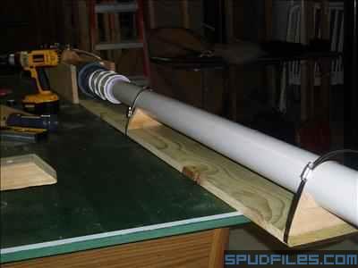

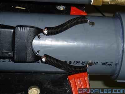

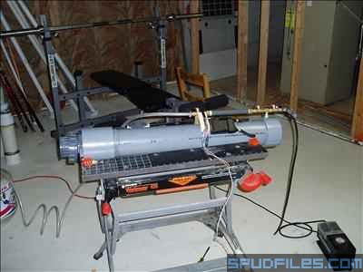

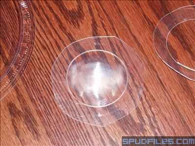

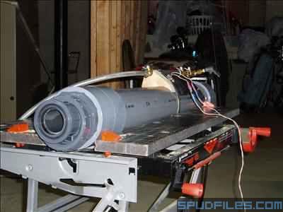

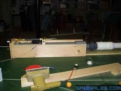

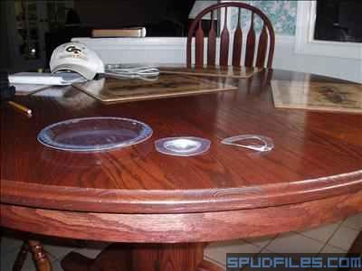

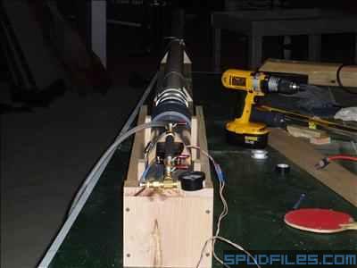

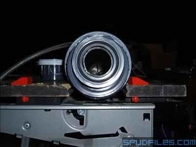

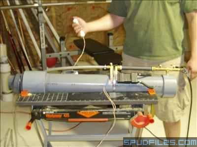

This is my first hybrid: 33in x 4in sch80 CPVC chamber. I have a 10ft chuck of 2in sch80 CPVC for a barrel but I'm waiting for my 1.5in sdr to arrive. In the mean time I'm going to use my 2.5in x 10ft sch40 tennis ball barrel. I used .5in sch 80 for the meter pipe so that it would match the rest of the gun. I use 1 layer of clear plastic disposable plates as burst discs whick hold to about 60PSI.

OMG !!!....A TEN FOOT Tennis Ball barrel !!!, you MUST be firing weighted balls atleast a 1/4 mile with that thing at a 2x/2atm mix.....please record some video..that is a beautiful BEAST of a hybrid..well done !!
p.s. what mix have you taken this too (4x perhaps ?)

and i love the fuel/air set up nice clean and professional looking how much psi do you have to bring the air meter to?
