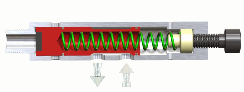

You could also make something like this:
The air from the tank is fed into the inlet of the pop-off valve, the oulet of the pop-off valve is fed to the pilot volume, and the threaded port of the pop-off valve is also connected to the pilot volume.

looking at the pop off al-xg posted i though it would be a little difficult to fit onto an airgun without it being awkward due to the air inlet and outlet so i threw this sketch together of an inline popoff based on the previous one... any flaws?
Gun Freak
Lieutenant 5
Lieutenant 5
Posts: 4971
How are you going to get the spool in the body?
Major Collins
Posts: 264
Joined: Wed Nov 18, 2009 6:18 am
Location: Western Australia
i would make these 1/4 threads... i could probably tap one side ,insert the spool and spring and then add the nipple and then solder it in
al-xg
Great Britain
Posts: 643
Yes there is a problem, the piston isn't balanced.
The air from the tank will be pushing the piston to the left helping the spring.
Because it has a larger area to push on than the pilot side , the pop-off valve will never fire.
