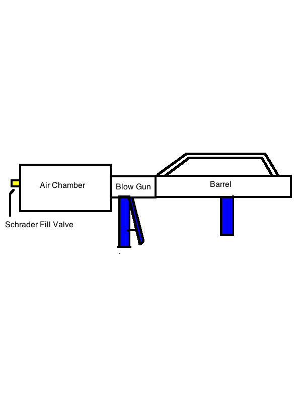

I saw this on the forums a few times but I want to know if this would get me a good amount of power, im looking for above 300FPS
[/img]
Simple Semi Automatic Concept

- Concept Drawing
Basically tank connected to blow gun connected to barrel - Simple gun concept.png (20.27 KiB) Viewed 5768 times

That ain't how a blowgun works. They're inline.
300 fps is a velocity, not a level of power.sagthegreat wrote:I want to know if this would get me a good amount of power, im looking for above 300FPS
What projectiles, barrel length, chamber size and air pressure do you intend to use, and how many shots do you expect to get per fill?

I forgot to add this, but there should be a hose connecting the air chamber to the blow gun[/img]

No there shouldn't be. That would be disasterous.

lol is there any way to use a air gun and a air chamber without a sprinkler valve, thanks for the help gunfreak (ur youtube vids are awesome)

How do you plan on a semi with a single standard blowgun?

If your chamber is big enough, a quick pull of the blowgun trigger won't let out all the air, wyz
Yes that's all it is, just majorly over-engineered

Well yes, if a 2l tank at 100psi for 5 shots it's ok for you...
I have posted a simple way about connecting a smal ball valve to the blowgun trigger to mechanically making a semi valve system, you can try it out.

Is that a reference to my PCPWell yes, if a 2l tank at 100psi for 5 shots it's ok for you...
That thing gets over 30 shots on 300 psi (down to 150 psi)

i want to know the most basic way to make a powerful semi auto gun in a compact mech

Sag, get a high pressure tank, hook that up to a blowgun, add a barrel and loading mech, and that's semi auto. Doesn't get any simpler. Yes I know that is basically what you originally proposed in this thread
